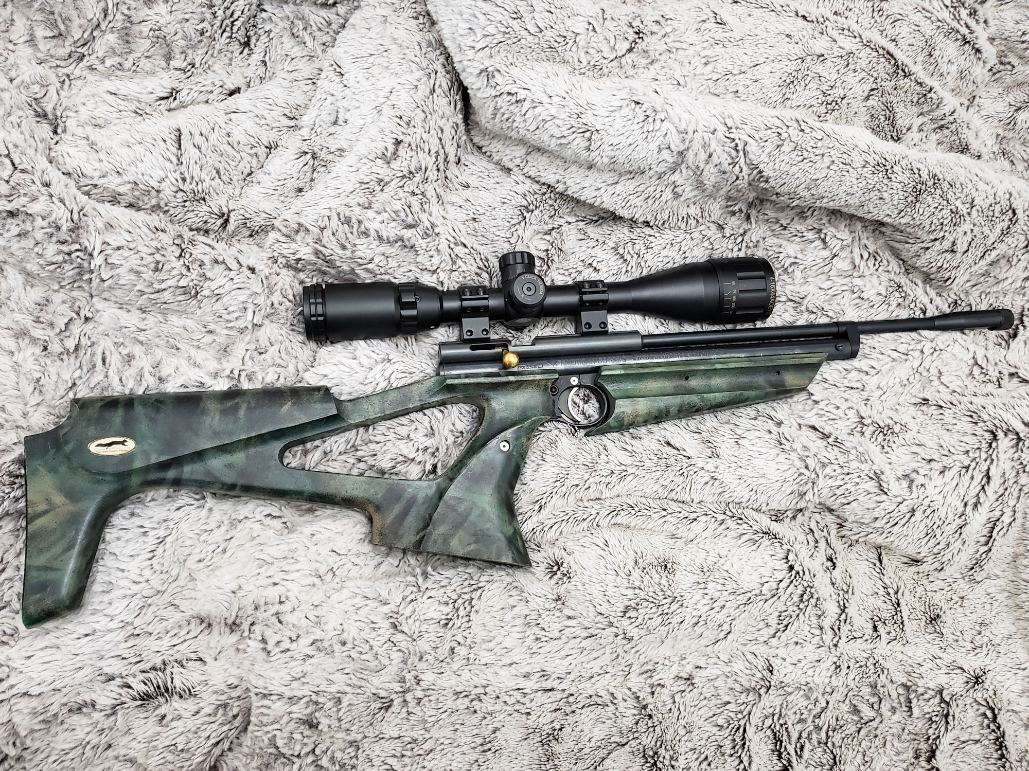

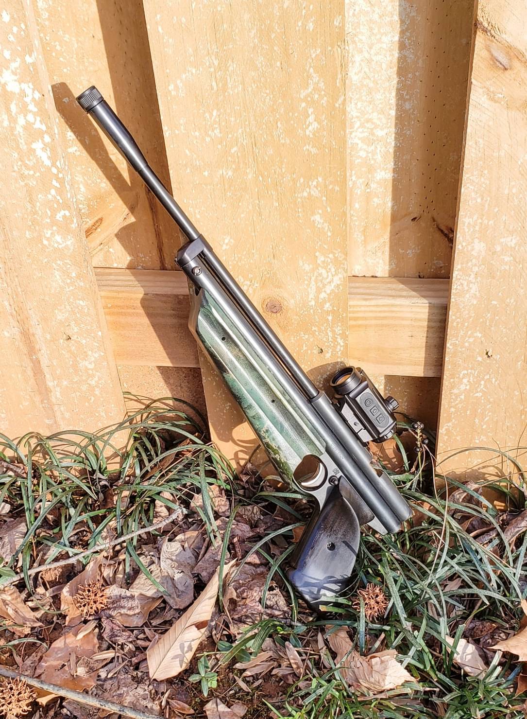

Have a steel breech or plastic?Somebody tell me what I am missing. I have two 1377]s. One I found lting beside the road and one I paid $ 25.00 for.
The one I found was converted to a carbine . I pur a four power cross bow scope it. The other one was new so I only took apart and lubed.
Just today I had both out shooting. I can not get either to shoot wel. At 15 yards I would be lucky to hir a beer can 8 out 10 shots.
i tried three different pellets. I then tried differnt pump counts.
My 2240 shoots groups less the size of a dime at this range and I have not done anythimg to it but shoot it.
What is with all the work to not shoot where you want it?

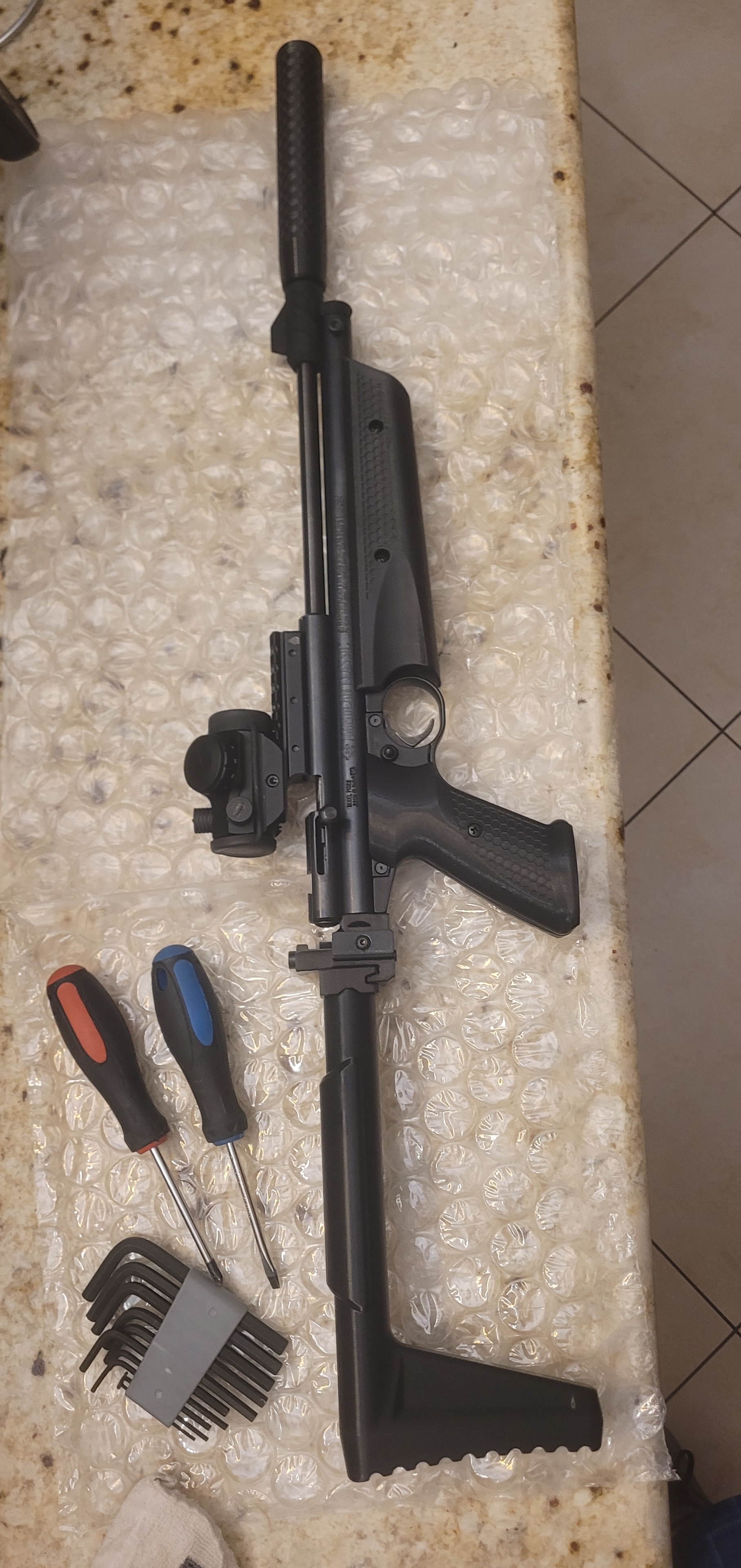

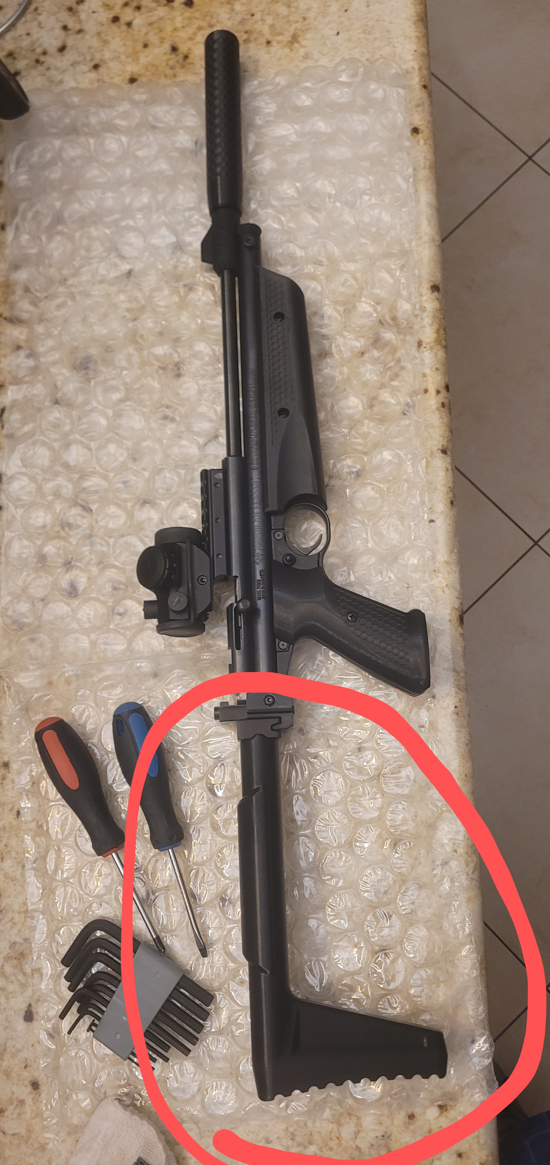

I love that stock! I wonder if it would work as a bolt on? I don't need a side folder.My modified 1322. 30 pumps is sweet spot for best accuracy. Forearms like treetrunks lol.

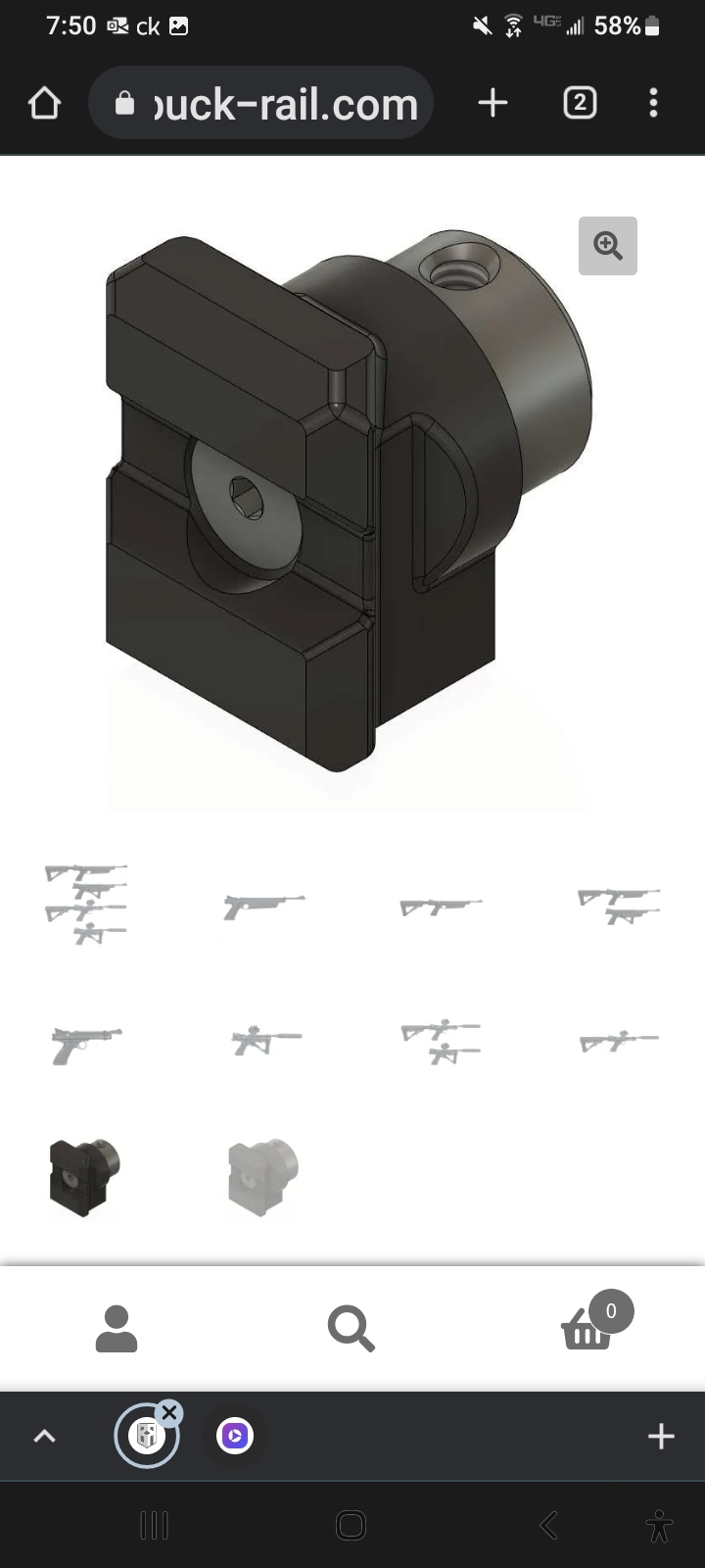

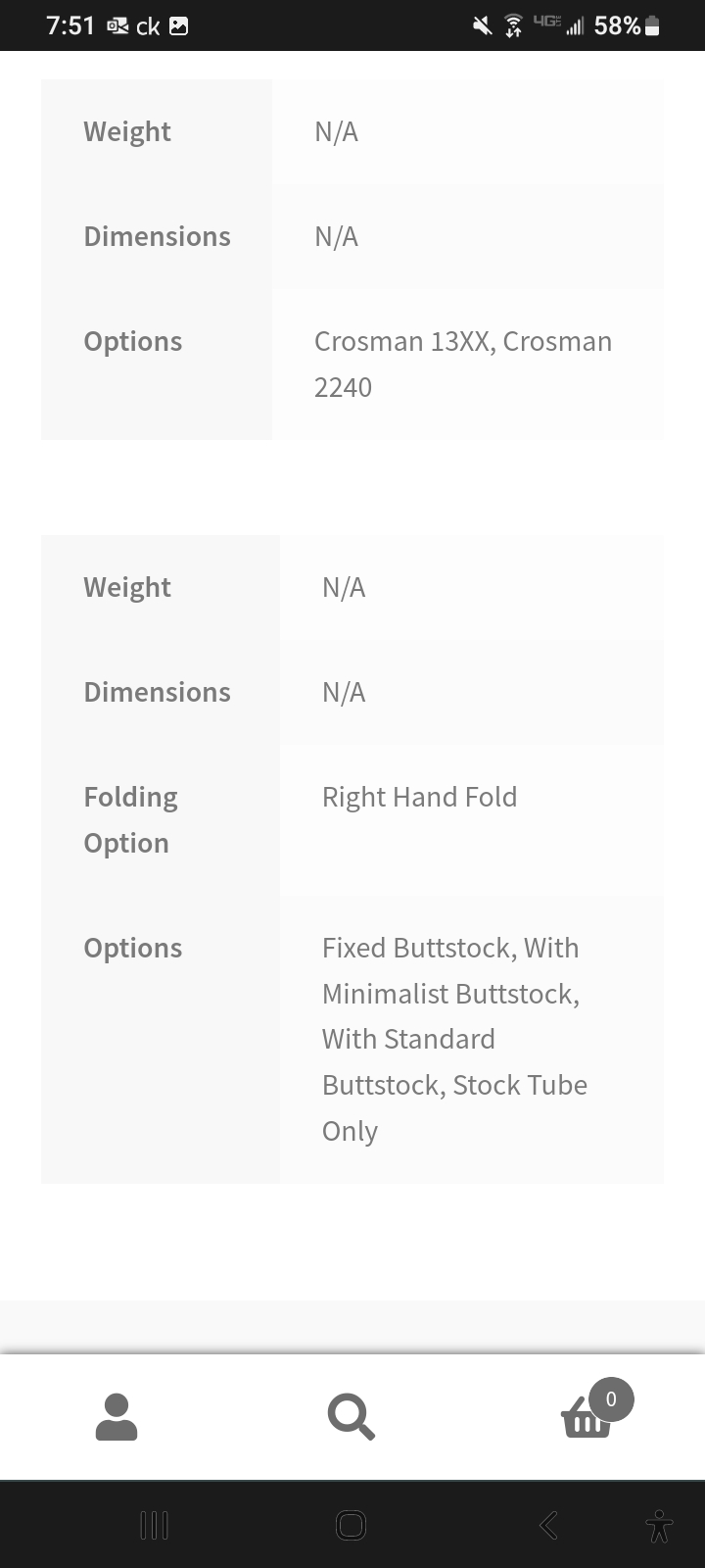

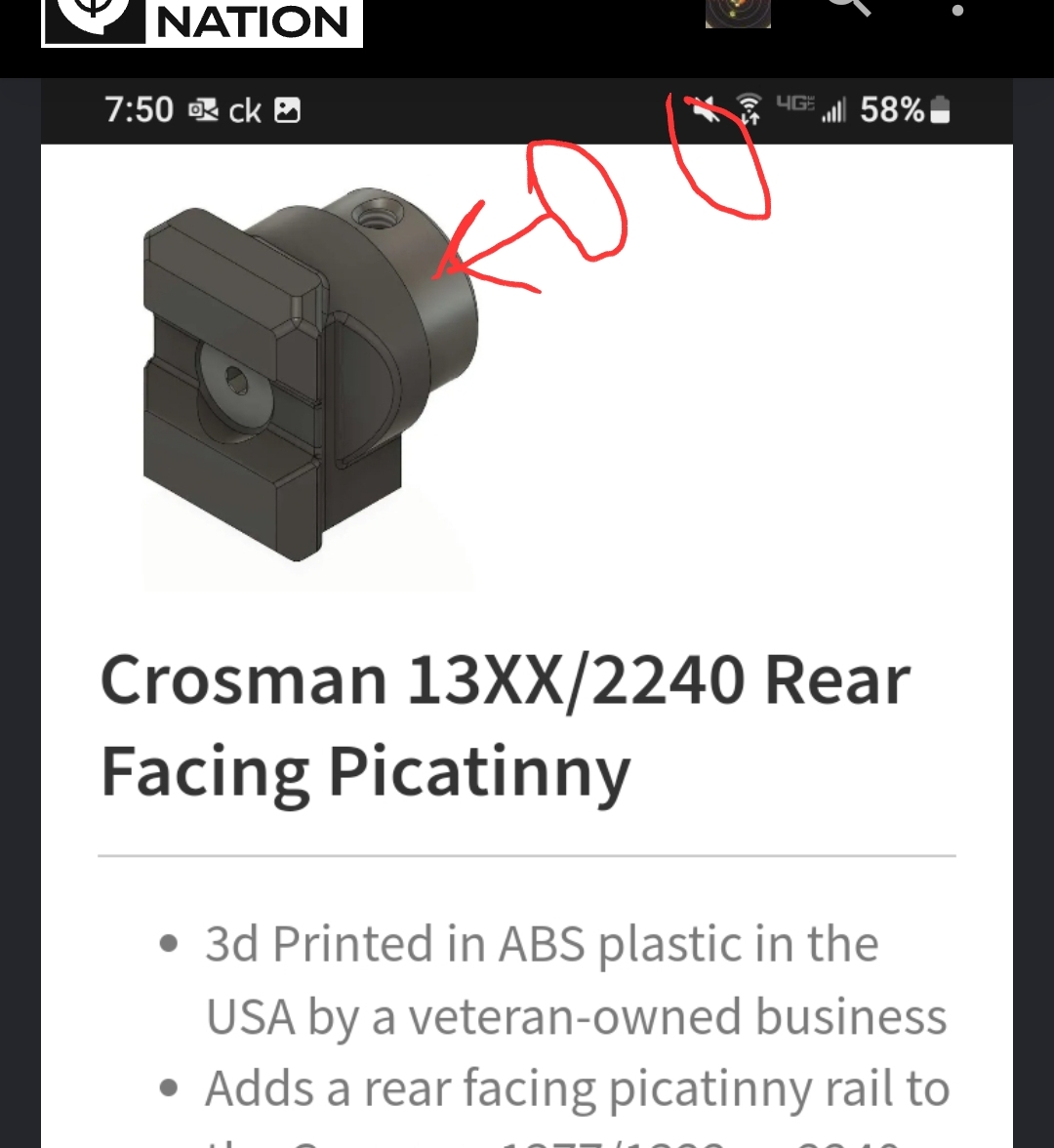

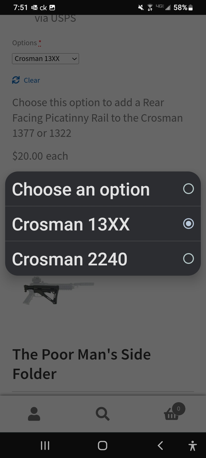

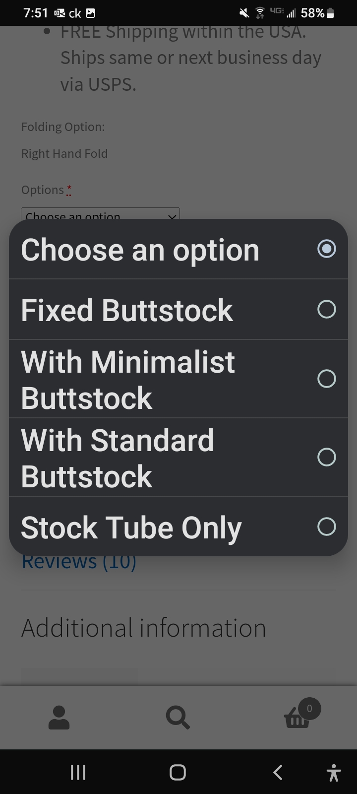

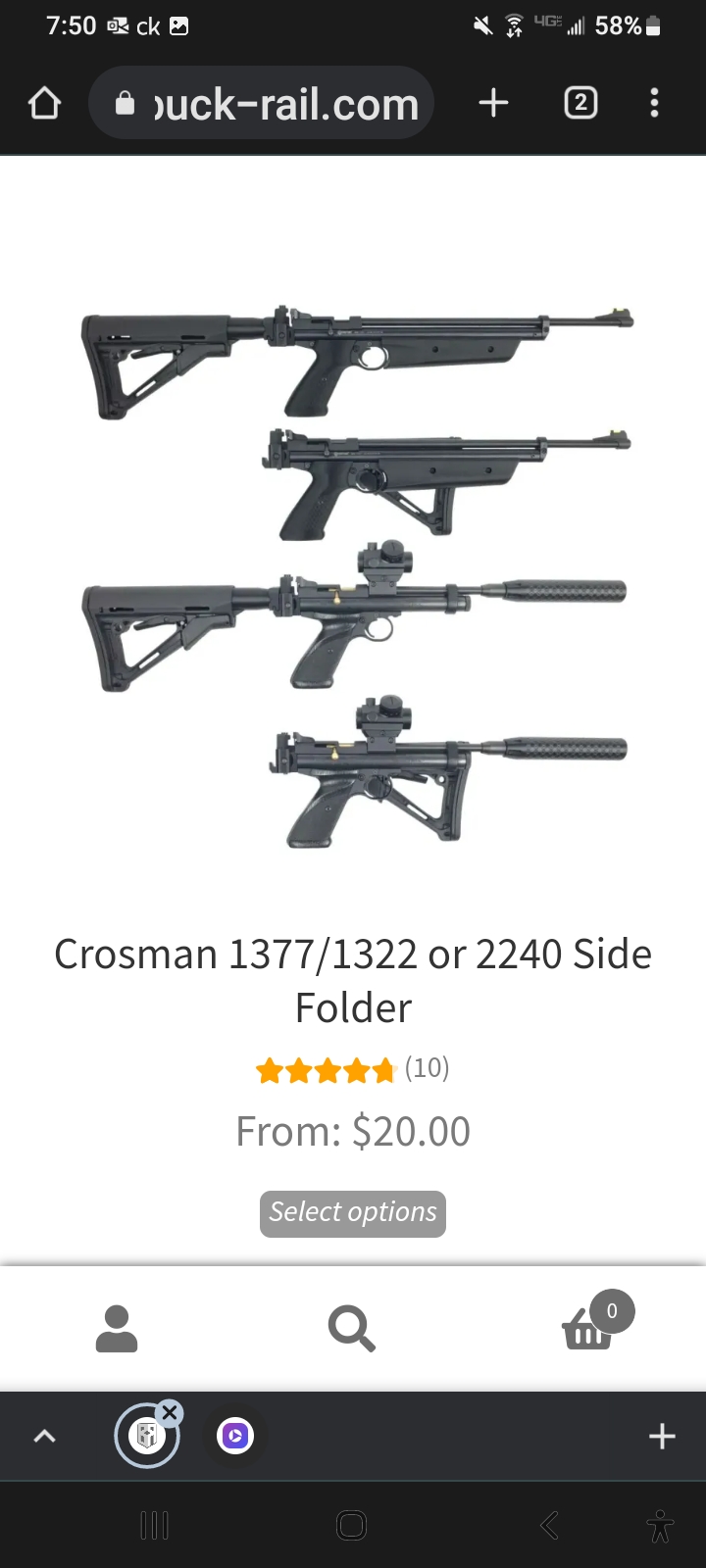

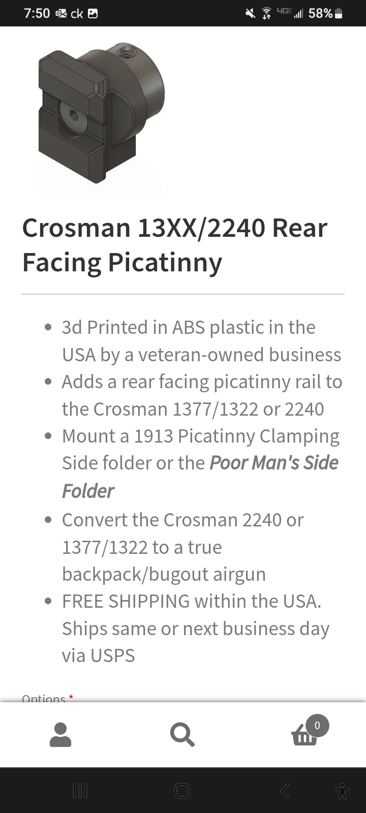

That's a part from buck rail? It's an adapter for pic rail that replaces that cap in the back. Then they have options of butt stock. Believe that one is called minimalist? I've been eyeballing that combo forrrr......bout 6 monthsI love that stock! I wonder if it would work as a bolt on? I don't need a side folder.
Quick look up for yaI love that stock! I wonder if it would work as a bolt on? I don't need a side folder.

All you would need is an 18 inch barrel and a Buck-Rail stock. I'd say around $150 or less plus the cost of the 2240.Aaaand how much per say would I have to be in to make a 2240 into a decent pcp?
I'm talking about this stock. I talked to Terry and he's going to make it a bolt on option without having to buy the side folder.Aaaand how much per say would I have to be in to make a 2240 into a decent pcp?

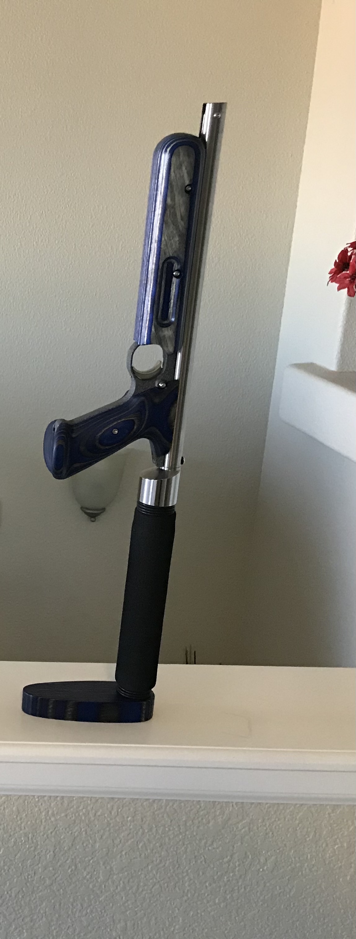

I really like the looks of your carbine. I'm mainly interested in keeping my 1322 build as quiet as possible so I'm not going to do any power mods to it.
It responds VERY well to the buckrail moderator that I have on mine. Even at 30 pumps the target hit is louder than the bang.I really like the looks of your carbine. I'm mainly interested in keeping my 1322 build as quiet as possible so I'm not going to do any power mods to it.
