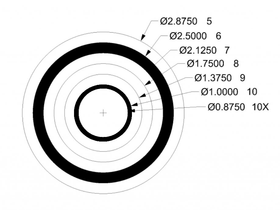

So lets agree on a size, and on spacing (your 1/2 inch looked good), insert an X ring (size?) and I'll do the targets same as the previous ones, you can post with link since its your idea.
It’s actually not miniscule, and it’s also not remotely comparable to guessing the wind. As you pointed out...a good shooter guesses the wind correctly more often than a novice. It’s vitally important to get awarded the highest value for doing the right thing. Currently with a 1.25” gun...you could get a 9, a 10, or a 10x for doing the best job. That’s not a small issue, and it will not work itself out fairly by itself.
Ok...so if good guns shoot 1.25” 25 shot groups at 100...that means the highest value ring should be at .900” when using a plug. This value should be the 10x, not the 10, though. I think a .875” 10x and a 1”10 would be good. Then space the rest of the rings at 3/8” increments. Just go to 5 would be fine and anything outside the 5 is a 4.

Here is my proposal.

Hi Jimmy....what makes you say it’s on the money?
Mike
Mike, I'm just comparing the 50 meter target to the EBR target.
The x ring is 6.4 times bigger on the EBR target
The 10 ring is in question as it's only 1.9 times bigger? A 2.5 times increase would put it at 0.625 inches which might be an improvement?
The EBR 9 ring is 2.5 times bigger than the 50 meter 9 ring
The EBR 8 ring is 2.667 times bigger
The EBR 7 ring is 2.8 times bigger and so forth
