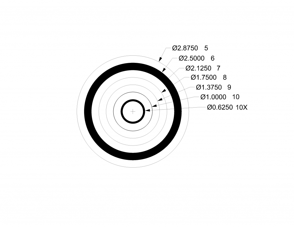

Here is another try. Only change is making the X smaller.
That target looks a lot better, Mike. No offense intended last night with my comments. I had a few brewskies in me and was admittedly being facetious. My apologies 🙂
Riddle me this, however; if I’m not mistaken, the X ring at 50 yard BR is 0.8mm. No current airgun (to my knowledge) can shoot this size group for 25 shots. Why then is this size X ring at 50 yard BR tolerant for you?

Well dang! I just printed up some of the first targets with the big X ring I like the second one better the rings are concentric which looks better in my minds eye. When you get around to making some more 35 cal air rifle plugs I would like to have one I would be happy to pay for it and shipping. I my little group that I shoot with nobody has a .35 yet but sooner or later one will show up and if that is the standard for scoring then I need one just to keep up the other scores.

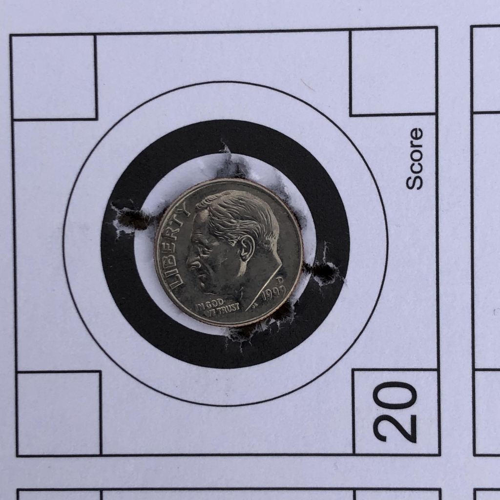

Here is a 100 shot outdoor group at 55y shot from the sitting FT position with a 12 fpe gun.
.250” is possible with a 50-70 fpe 22 at 50.
Holy smokes, that’s some great shooting!
Alright, if your HP .22, with you at the helm, can hold a .250” 25 shot group at 50 yards, would it be unreasonable to suspect that the same equipment could achieve, in super good conditions, a .5” 25 shot group at 100.

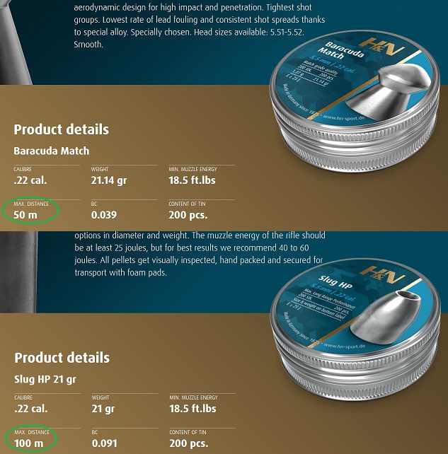

100 yards is beyond the scope with a pellet gun for average or slightly below average 100 yard shooters. Still, many of us like the challenge to try and improve.
It's beyond the scope of the allowable pellets (according to a pellet manufacturer), but not necessarily beyond the scope of the gun, since their are now airgun slugs (and airguns) made for that purpose.
