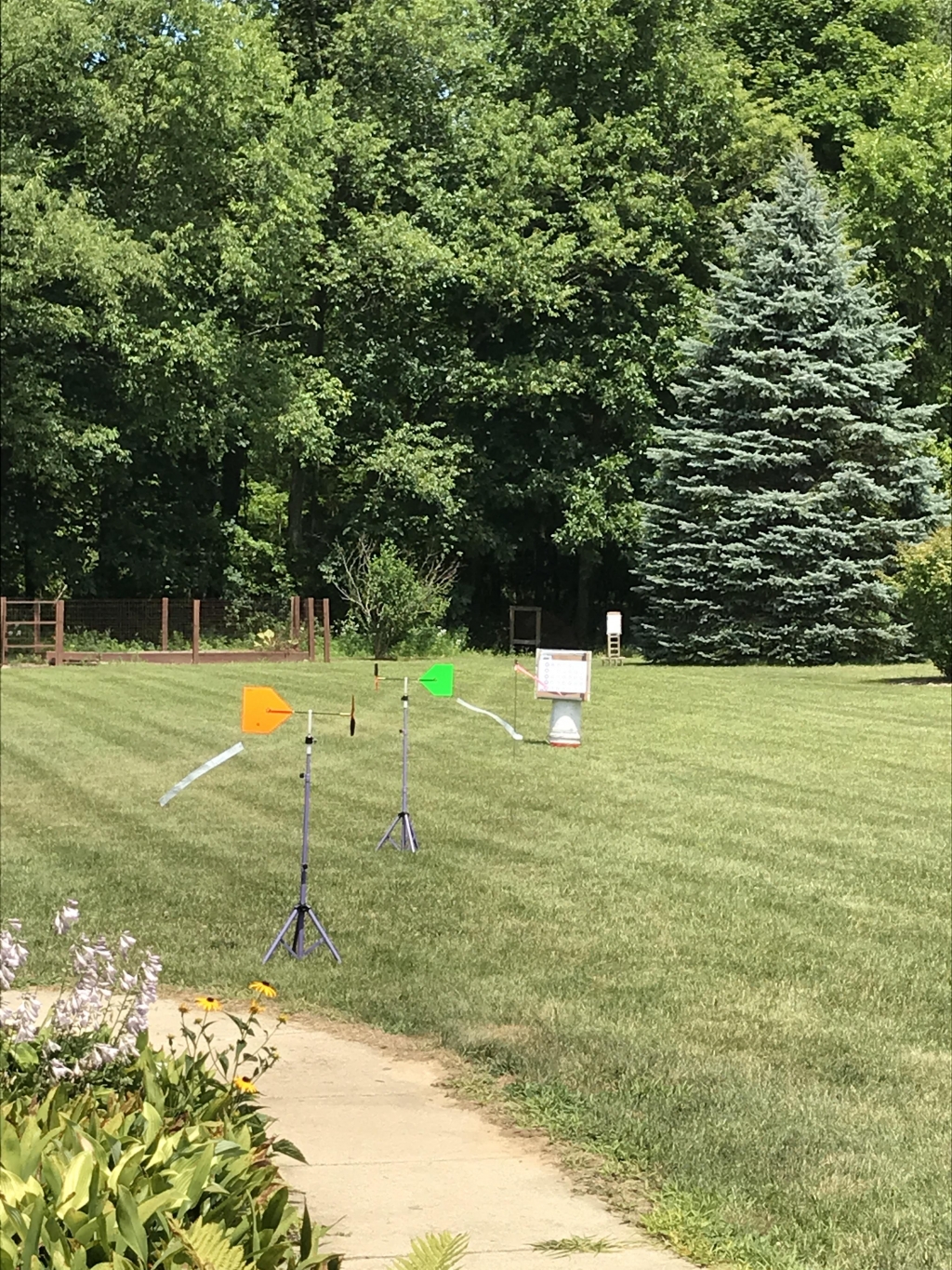

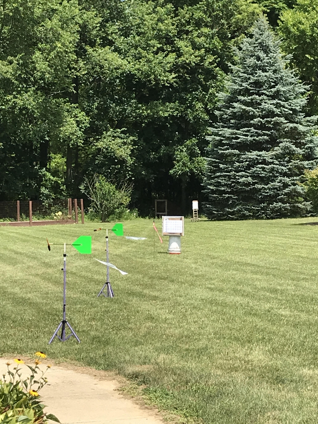

I feel it’s more luck than skill, I am mainly a short range Br shooter so from my perspective, it is very, very hard to achieve consistency and repeatability at 100yds, Mainly from not being able to read the conditions, for me to be competitive I must “TRY” and eliminate as many variables as I can, which usually is the conditions at 25m I have confidence in my equipment and shooting techniques, but I am constantly trying to get a handle on the conditions and “learn“ What the flags, mirage and temperatures are doing throughout the match or matches so I can learn and apply this to my record bull, card or match. I could not consistently achieve this at 100yd and It got very frustrating and no fun! which in turn led to my decision not to compete at 100yd I only did this one time at the PAcup last yr. but that was enough to honestly know it was not for me, “COVID was also a major factor in this decision“ trust When I say I wanted to really get fully committed to 100yd comp.! I am not saying long range shooter’s are not skillful! Just a 100yd Shoot 3-4 times a yr. is more of a novelty than a true competition? ( it does sell a lot of guns for manufacturers and dealers which I believe is the intent, and nothing wrong with that! ) by the way I’ve had the same 25m gun for over 5-yrs.! And here is a Idea of what wind flags can tell you in just 20ft between 1st and 2nd flag so what does that equate to in 100yds I’m just not a run-N-gun shooter or A fire a 100 sighters and not truly know what they are telling me type of shooter! But I am very much still learning at 25m and that’s competitive and FUN!
Great comment. You have a nice setup there in your backyard. I believe I saw those same flags being used at EBR last year and several of them were blown over during the 100yd final. They do have some wind out there. I was there but totally unprepared for what I encountered. I hope I'm a little better prepared for the next one. I have done a lot of long distance shooting with heavy recoiling handguns in competition and I know how frustrating the wind and mirage and dust storms can be but since I started shooting airguns I have an even healthier respect for what the wind can do to a diabolo pellet at short ranges. 100 yards with an airgun is extremely frustrating but fun.
That’s what I was sayIng in a earlier post is long as the condition is consistent and repeatable By verification of sighters! You know when to go for record ( even if it’s a 7mph wind Or more!) at least you know and correct for the shot, and your right that L to R was almost 90’ to my target so a easy Condition To read, I wouldn’t of taken the switch unless I had to because of time or had taken that sighter to give me a “idea” of where it might go? Thanks about the yard! But just don’t look at my target support and cant “not ideal” but works in a pinch
