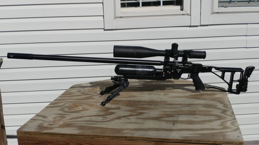

Crown MK1 in Chassis w/ 700mm Superior Heavy shooting JSB .217(sorted for diamater) KnockOut slugs @ 890fps
