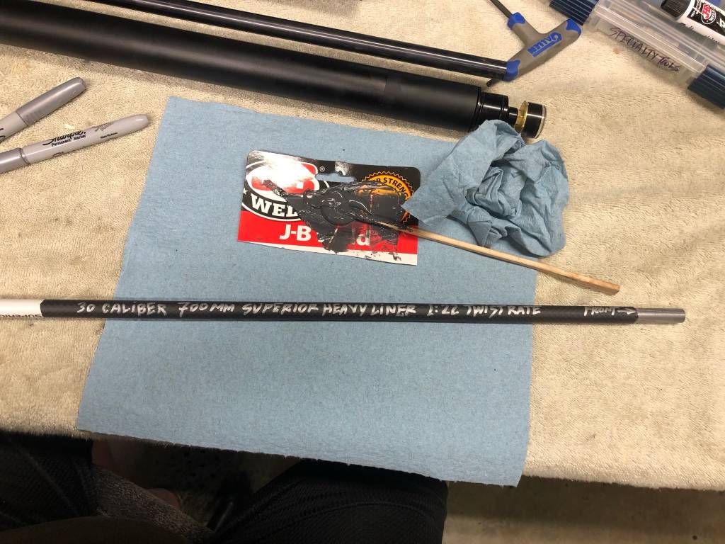

I take an engraver and etch a line at the 12:00 position, and use a paint pen to paint over and into the etched line. It’ll wear off, but it takes a long, long time.

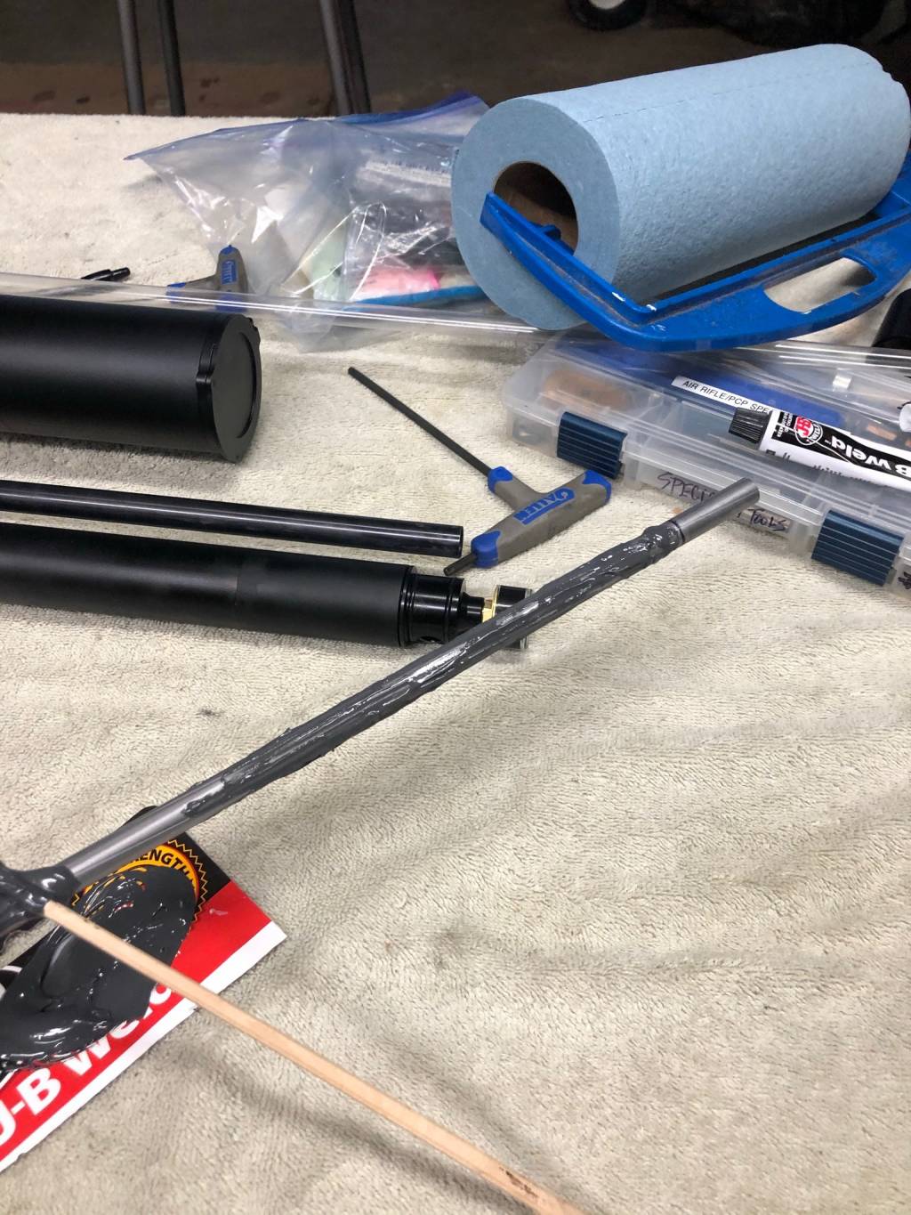

Ive been making it a habit after epoxying a carbon fiber sleeve over my liner, to write down all pertinent information, using a silver sharpie-
I’m not gonna act like “I’ve been there, done that “ with indexing and properly marking up your liner for reference. It was Mr. CHUCK that schooled me on all of this two years ago. Lets just say I went thru a long distance, remote apprenticeship with him, and I’m thankful he took me under his wing.
Which engraver do you use? Where do you place the mark?
