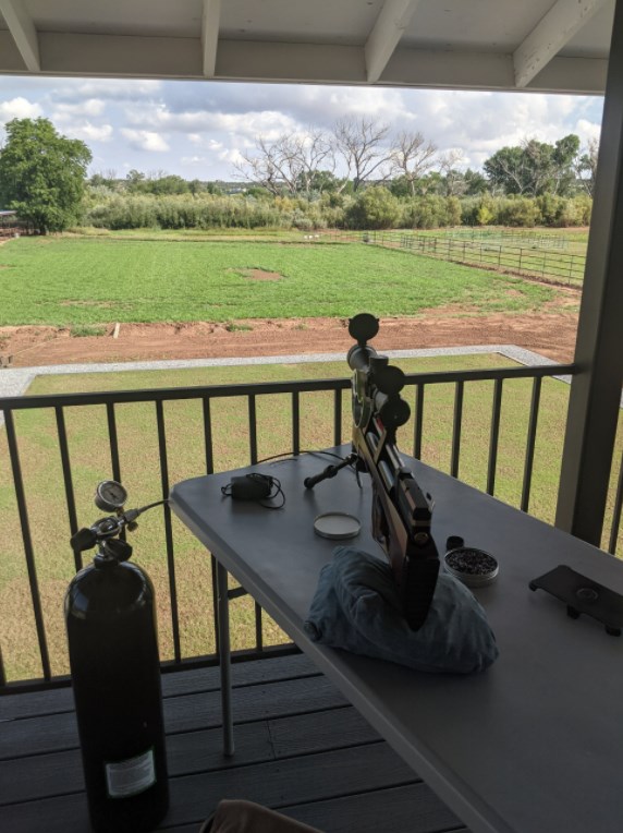

Yeah, 109 yards or 100meters. Sub-heading for this new section says 101+ yards so my fun from yesterday qualifies by about 24 feet (figured we needed another unit of measurement in here just for keeping it complicated).
The "platform" is the deck on the backside of my house. This photo gives you a better idea of the shooting platform. It's about 30 feet wide, 10 feet deep. The floor of the deck is probably about 16 feet off the ground.
This house had a rickety old super sketchy deck here when we bought it. The wooden vertical supports and main crossbeam were all warped. Could stand on the deck and shift your weight and the whole thing would move like a boat in water. It was dangerous. The ledger on the wall for the previous deck hadn't been done right and allowed a bunch of water to run down inside the wall. Had to replace a bunch of structural stuff inside the wall from all that, as well as the OSB sheathing. So we had the death trap rebuilt and I wanted a roof over it too, so had that added, keeping the same pitch as the existing roof. Overhung the roof enough to keep all but the worst storms blowing rain from getting in underneath, and the roof is a two-for-one by keeping the ground level "porch" (concrete slab) under overhead cover too. We considered adding exterior stair access but I work a lot of nights and my wife didn't like the thought of being worried about a creeper coming up the stairs and looking in the master bedroom windows when I'm gone to work. So, access through master bedroom is about the only negative.
As for shooting, I could really use either a higher table or have the rails be lower, as the top rail is just about in line with the muzzle unless I extend the bipod legs out quite a ways. the safer and easier option would be a table about 6 inches higher. But it's overall very enjoyable, it's on the north side of the house so nice and cool even on hot summer day. Perpetual shade (might make it a bit chilly in the winter I suppose). Our prevailing wind usually comes from the southwest so no direct wind blowing in my face. Bathroom within twenty feet. Refrigerated drinks and/or snacks pretty close too. Pretty relaxing place to spend the day, or a few hours, shooting. Targets are a bit of a pain to replace though, as it requires going down the main stairs, down another two steps to the split lower level of the house, and then another 3 steps from that down to ground level, and then 109 yards of distance to cover. With the steel support beams and the 6x6x6ft chunks of concrete they're set in (under the concrete slab), and trex decking with 16inch on center joists, it's as stable as shooting from solid ground. I was shooting on and off throughout the day and it was kind of nice to able to leave the guns and all the gear up there all day, knowing it wouldn't get rained on or have any chance of walking away if somebody happened to visit my house and see it left out.
As previously stated, I'm way up in the air so I'd think that makes the pellet be exposed to greater air speed winds than if most of it's flight path was down under 5 or 6 feet like it would be if shooting from the ground.
As a shooting platform, a little on the pricey side. I sure wouldn't go out and build one of these specifically to shoot from, but it needed rebuilt as part of the remodel anyway. But I don't regret it and dang sure enjoy it when I get the chance to shoot off it.
