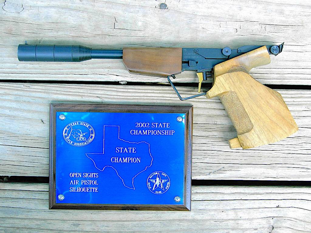

Exhibit A-
This .22 caliber Tau 7 Co2 pistol whipped the largest field (of 22 shooters) to ever contest the two-day Texas State Championships in NRA Air Pistol Silhouette contesting Open Sights class.

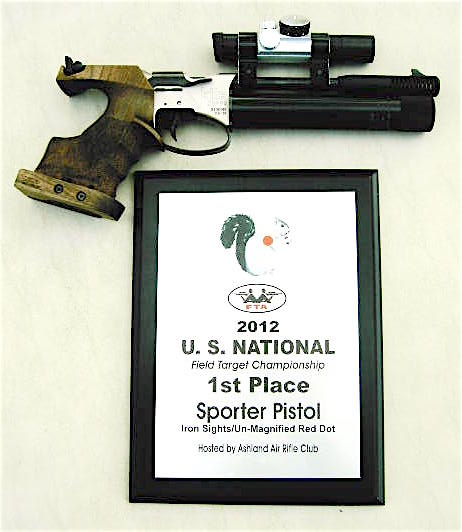

Exhibit B-
Though you've never heard of it, the .177 Benelli Kite 'Kid' PCP destroyed the Sporter Pistol field consisting of all manner of air pistols (including AZ modified Steyr ten-meter guns).

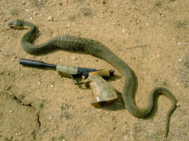

Exhibit C-
With only it's head above water, the excellent sights and trigger of the .22 Tau 7 made the ten-meter (offhand) brain shot entirely possible. Only after retrieving the aggressive predator did I realize I was too late to save my pet bullfrog.

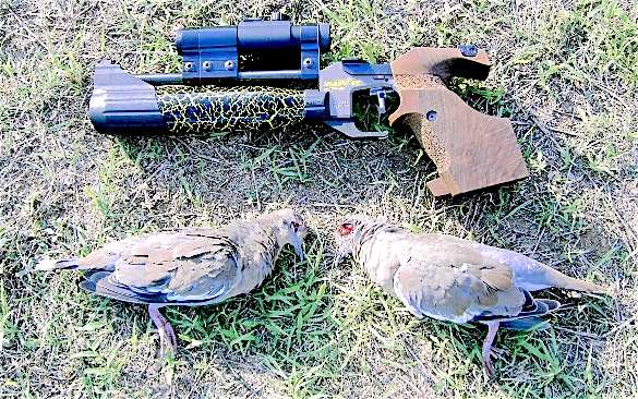

And D-
Notice the shot-placements... from offhand!
