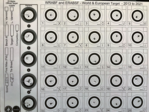

I haven't heard about anyone bedding a FWB 300S, but I would advise against it because you may ruin the recoiling sledge action. I shoot my 300 at 25 Meters using JSB 7.87 gr pellets, and I must say that this gun is difficult to beat. At 10 M, I would use a quality match grade wadcutter pellet like RWS 10, RWS Meisterkugeln, or H&N match. Probably the lighter weight pistol version, but you need to test them. You need a SOLID table and develop your technique. I never touch the gun during the firing cycle to avoid undue pressures on the stock that may cause the gun to move when the shot goes off. Just put your finger on the trigger. Some folks put their thumb on the backside of the trigger guard and pinch the trigger with their forefinger.. All good things to try. If I can do this at 25M, you should be able to get a 250 all the time indoors at 10M.
1541176744_14825947895bdc7da8b232a9.69224245_FWB 300S 25M BR target resized.jpg
