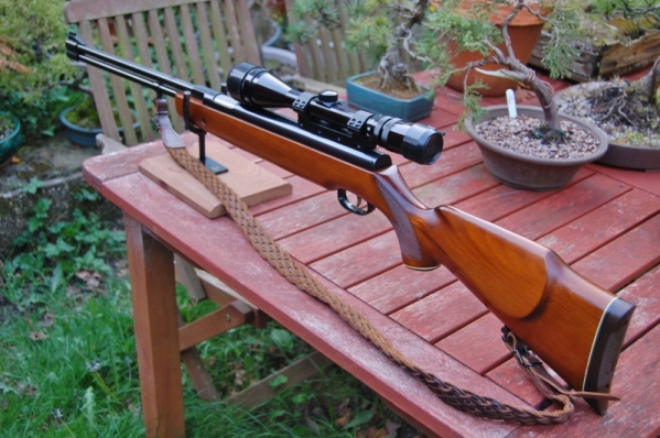

I had a TX200 in .177cal, I had to let it go as the loading port was too small, My arthritic fingers were really struggling to get the tiny pellets in, I bought a HW97 in .177 and the port is much larger!
The .177 TX200.
I also had a .22 HC which for some reason was much easier to load!

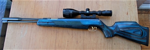

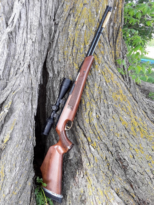

I recently bought another HW97 as i'd sold the ones I had and needed another, HW97kt, VMach tuning kit fiited, The tactical stock is so comfy but I had a spare blue laminate stock so, On it went!!
