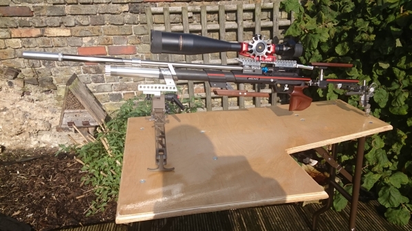

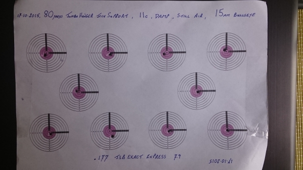

...for a 4.5mm pellet at 790 fps (thereabouts), this is what is achievable bench rested...
This is my good friends rig, from the UK- a power pimped Jon Harris conversion of the 10m Anschutz 9015
It took place in a inside a Jumbo hanger at a disused airport - so with still air...
Still indeed. Add 3mph and he's holding a bulls eye and a half , if not two over to hit the bulls eye.
As for my answer to your question. Dead calm no less accurate than any other comparable rifle. By comparable I mean if your .177 shoots 1/2 c-t-c then the .22, .30, .40 etc. will all shoot the same.
As for wind, the .177 is going to be effected first, and as I said above it doesn't take much with such a long shot, for the slow speed and high deceleration of the .177 to be effected first, and dramatically.
