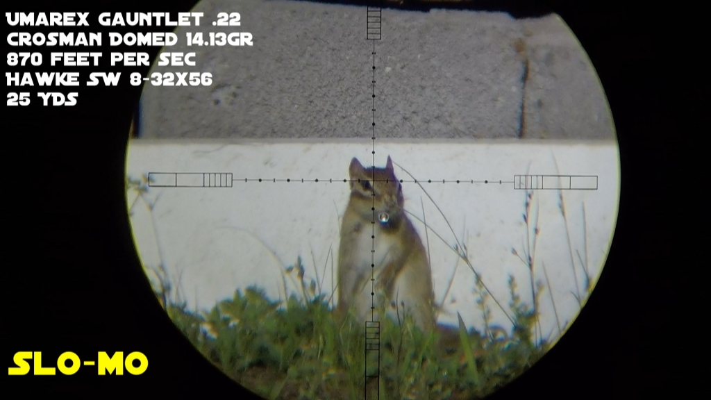

As for frames per second, it has been my experience in editing and producing hundreds of hours of high speed video that higher frame rates are great for capturing pellet in flight. a video shot at 720 @ 240FPS will certainly show more information but as Bob states, requires far better light. In general you will get much better results in better light.
Below are examples of shots taken at 720/240FPS and 1080/120FPS, two will be basically in the same location with the same lighting and the third will be in direct sunlight. All these videos were captured using an older GoPro Hero 4 Black with a non fisheye 6mm lens through a Hawke Sidewinder 6-32 x 56 Scope.

Now in the last 1080/120FPS you can actually freeze frame and see the shine of the shirt of the pellet just before hitting the chipper in the mouth. As you can see the clarity of the shot at 1080 even though it was shot at 120FPS with enough light, can capture the action.
