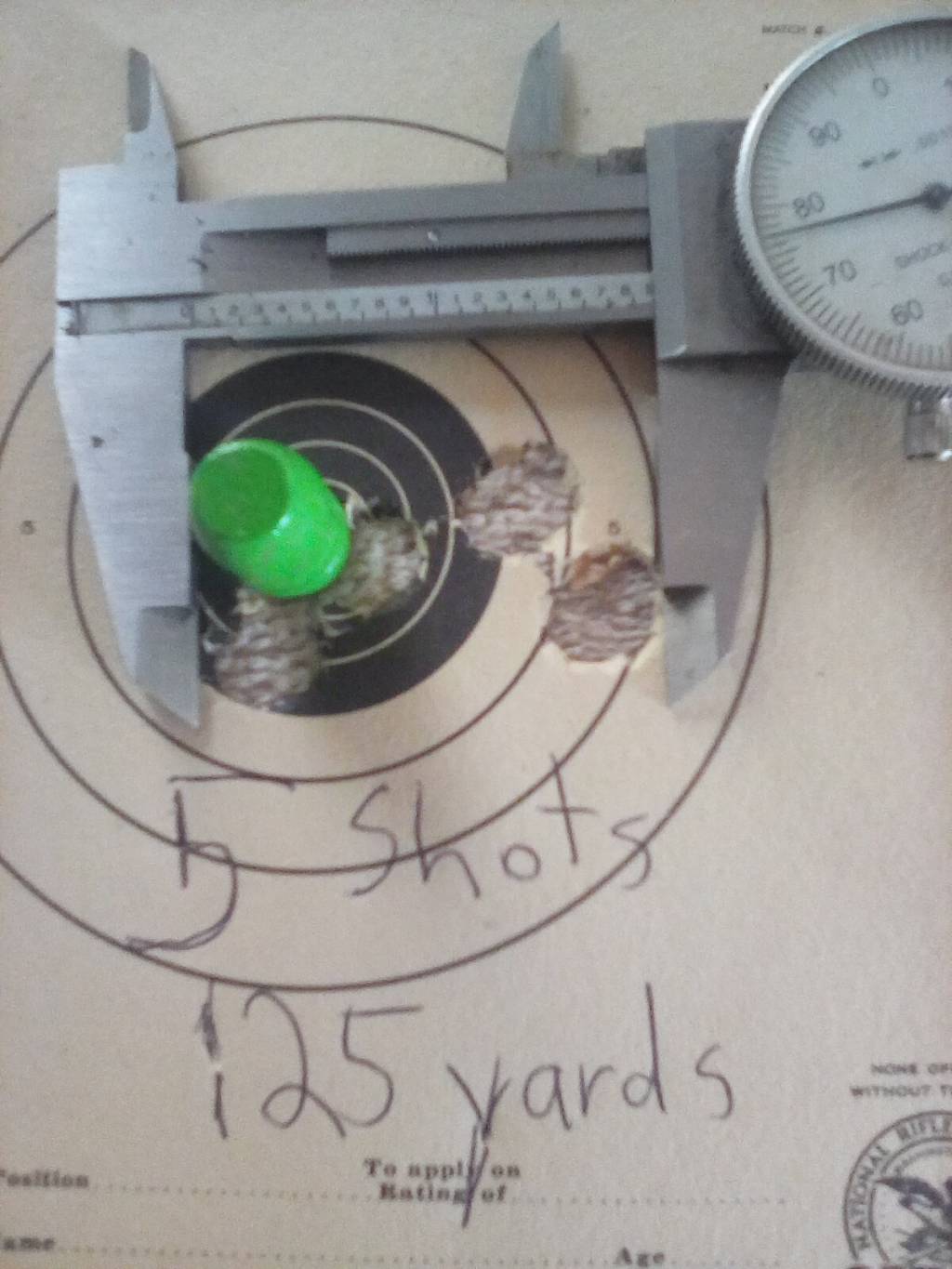

125 Yards Texan 50 460 grain N.O.E Mold powder coat
Perfectly clean bore. 2 shots to fowl barrel. Next 5 accurate as you can see. Next 3 shot group Was over 3 inches. In my experience these are the results that drive you crazy with rough bores. If I clean after every 5 shot group all is well. When I have the funds I will buy a custom benchmark barrel!! The barrel is straight just rough!!😅
There is no way in the world I would do anything to replace that barrel until I had tried to smooth it out. It shoots way too well. Anytime I receive a new air gun. I clean it with JB bore paste. I scrub it each time. I do this until the bore no longer fowls.
Should be relatively easy to do on a large caliber like that. You don’t have to worry about rubbing the walls of the barrel with the rod.
