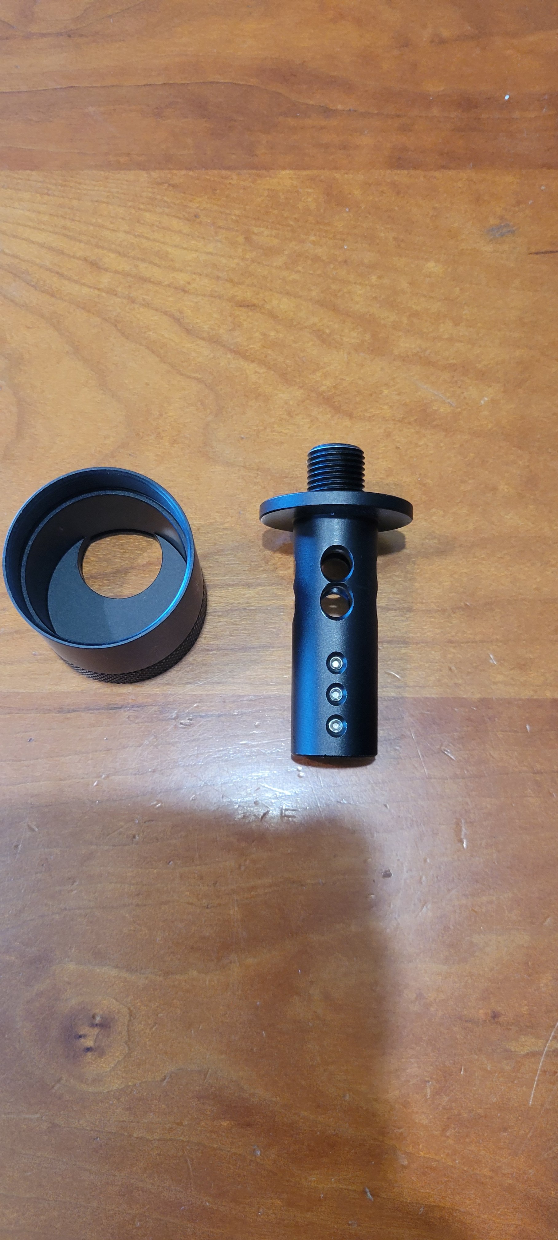

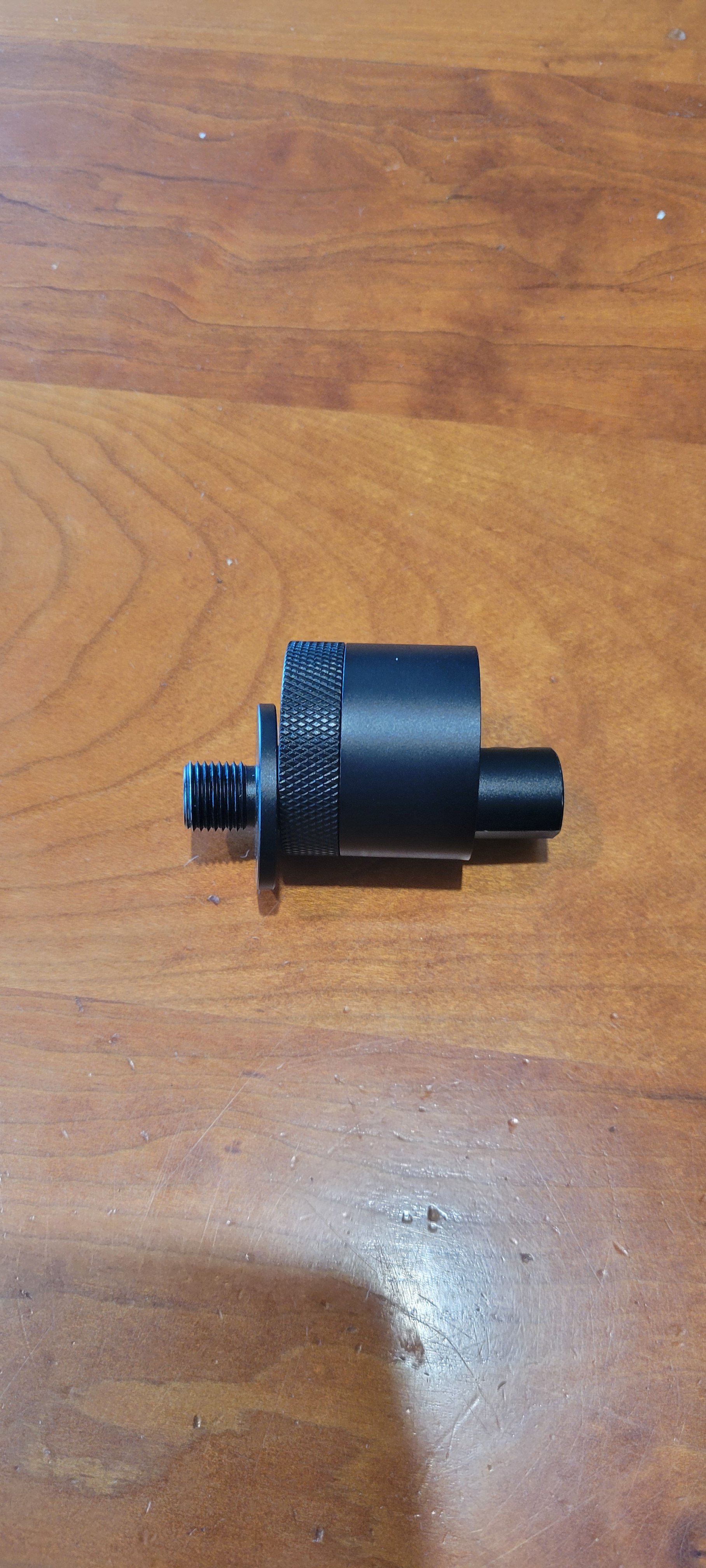

Here is the DonnyFL adapter I mentioned. I'm not willing to sell mine but wanted you to see what it looked like in case you posted a WTB ad.
I've heard the Behemoth takes a strong turn to seat it on the Tri Lug so I'm not sure the three small grub screws are secure enough to stay put.
As mentioned in your other thread, at least one AGN member drilled out & re-tapped those holes for much larger screws. I believe he even added a few more.
With that in mind & given you'd need to source & buy one of these as well as the longer barrel, you're probably better off sourcing a blank & have it machined.
