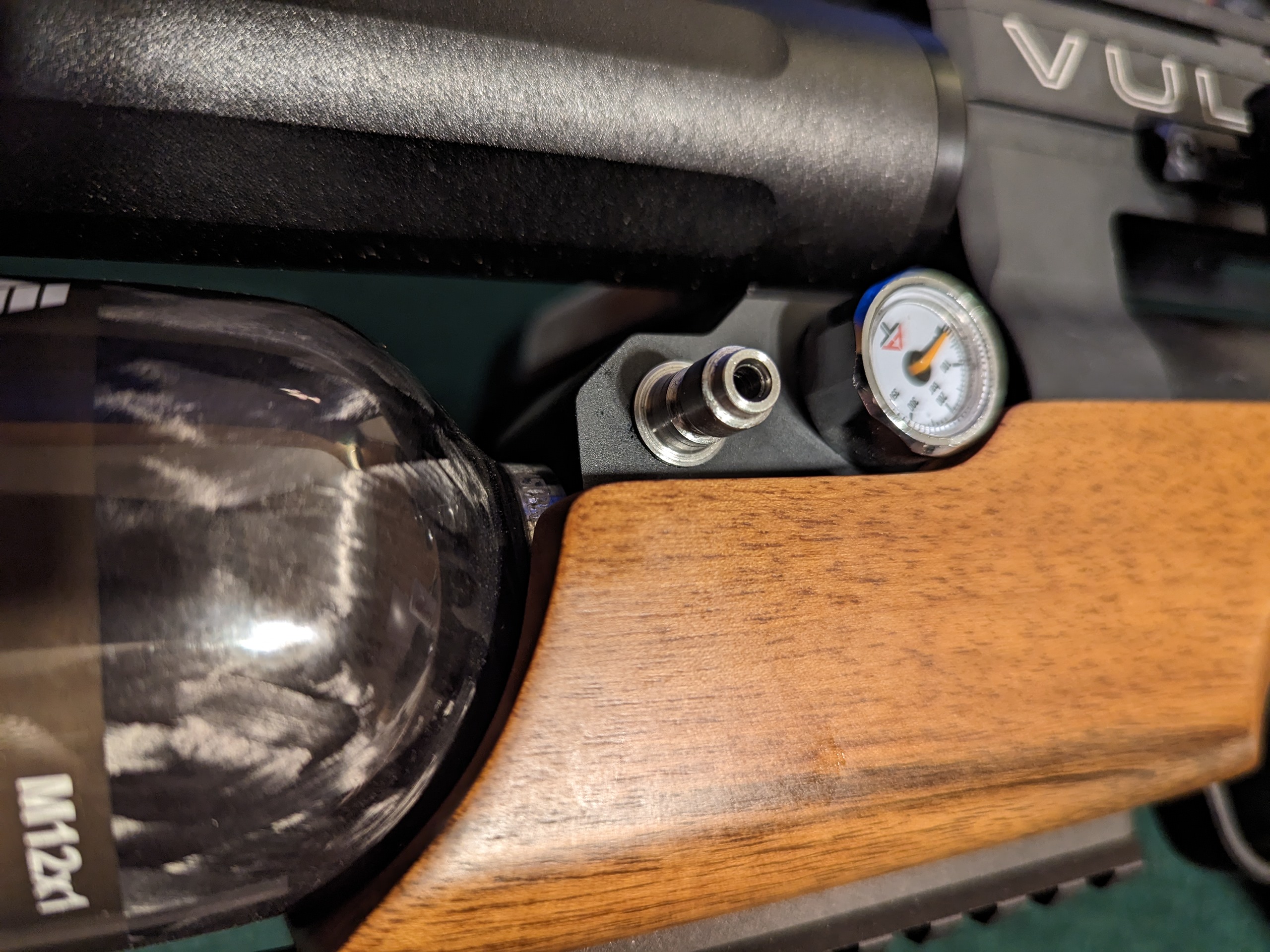

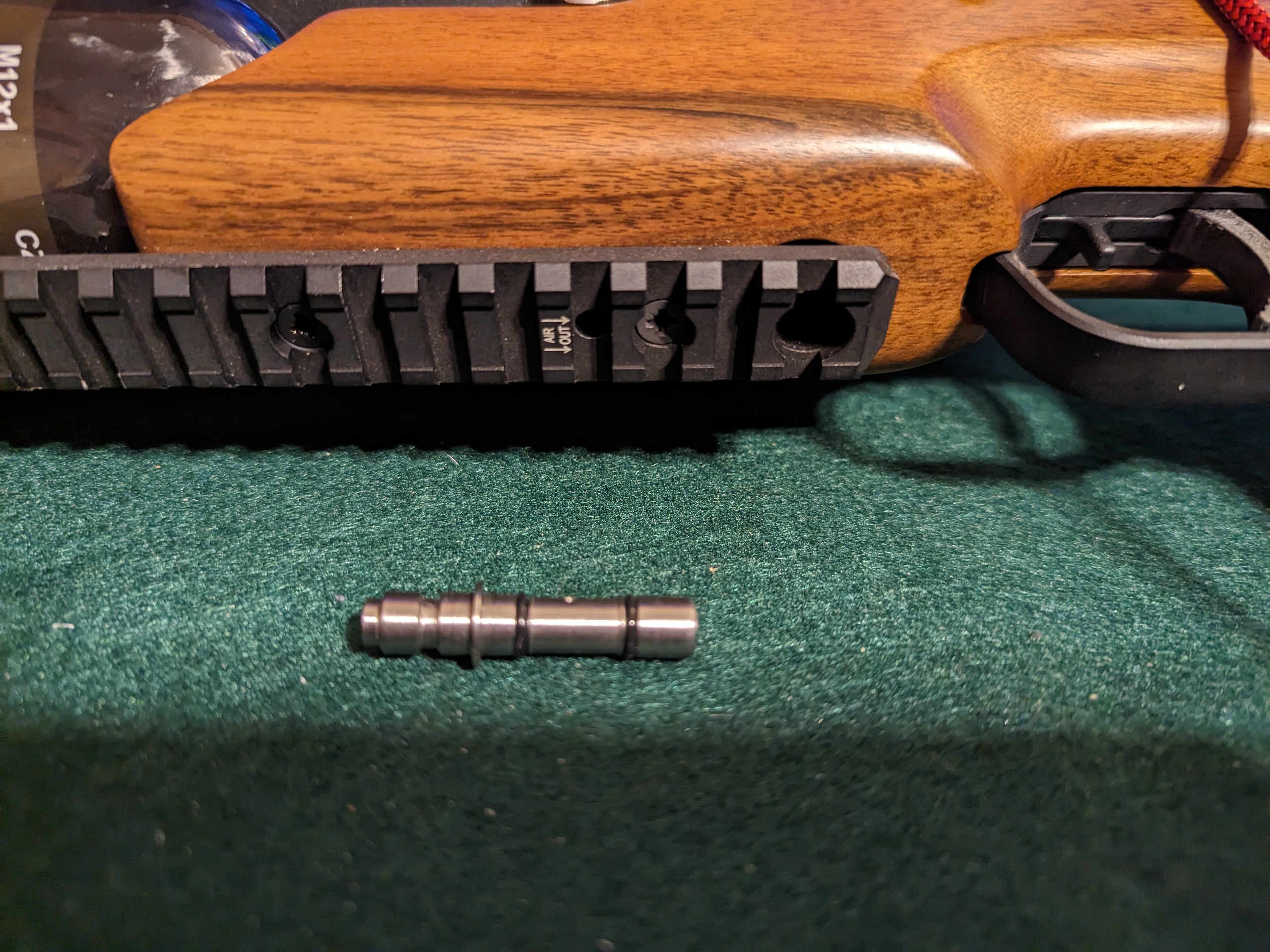

I hate them and misplaced mine for the Vulcan 3 so I machined a new one from 303 stainless that can be left in the gun. I much prefer a foster fitting which should be cheaper for the manufacturer and less machine steps so I don't know why fill probes exist.

I bet it doesn't cost any more to manufacture. There are no more machining steps for them. Maybe for the Chinese company that supplies the probe or Foster fitting, but I bet the price difference is fractions of a penny.
That said, I do prefer the fixed Foster fitting too, but it doesn't stop me from enjoying the one gun I have that has a probe.
One hand operation, Fosters need two hands to get them on and more so off, probes just slip in and out one handed.
probe once is pushed in is super secure and an easy thing to do and monitor, fosters sometimes you thing they are in but miss the click and that is a problem.
so yes definitely more secure and easier to operate.

There are many extra machine steps in the guns I've seen with a fill probe where a male foster is a cheap ready made part that contains a sintered filter, a check valve and only requires three machining steps from the same position to install.
I've never heard anyone complain about losing their foster fitting but lots of people lose their fill probe. We all have our opinions it's nothing to lose sleep over.
