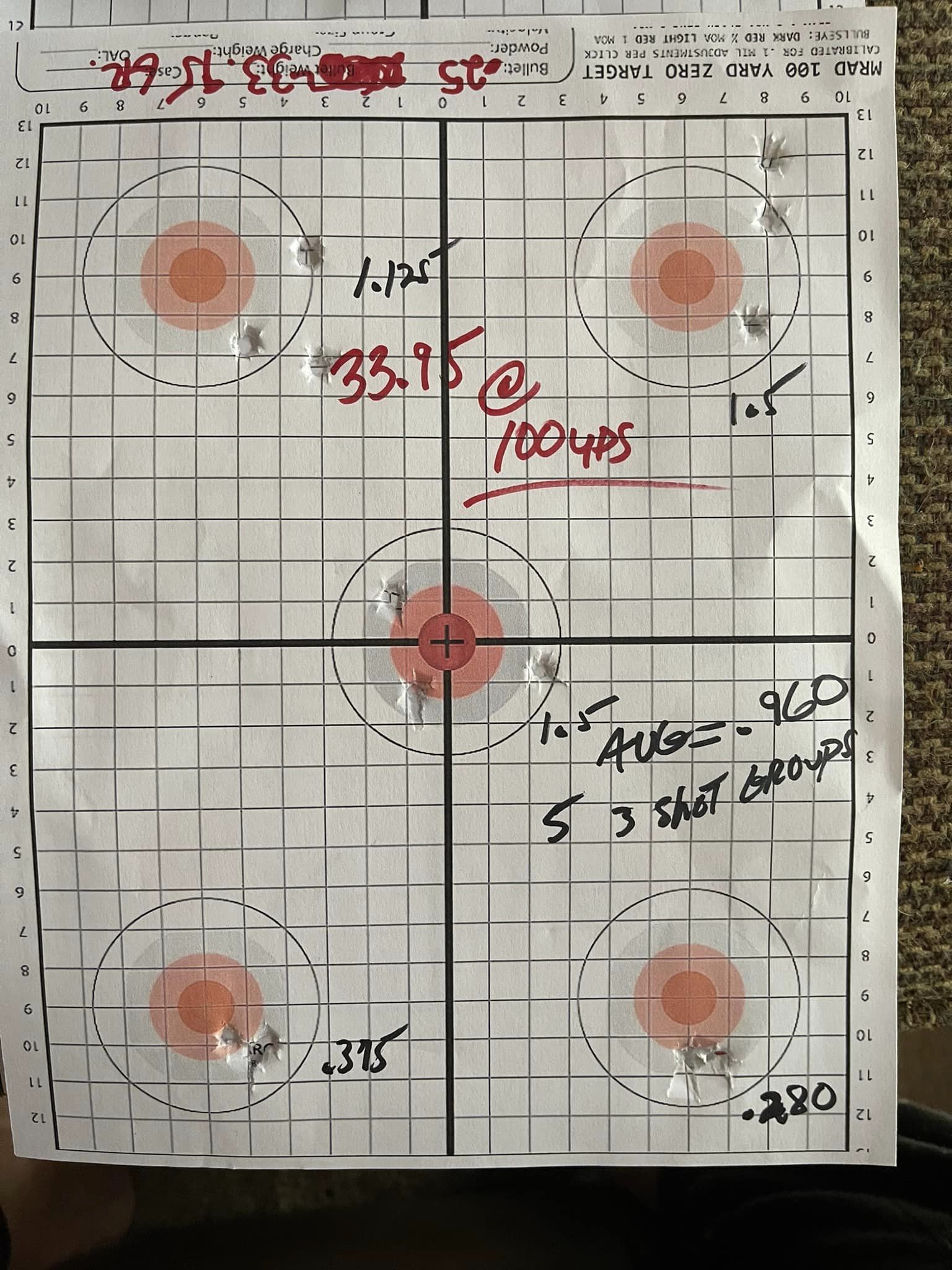

I gotcha. Well if you’re after a video at 100 yards I can probably help but I don’t have a scope cam or anything fancy. I just took 2 5 shot groups for you at 103 yards and it’s not dead calm. Wind is between 2-4 mph today I’d say and not consistent. Here’s what I came up with and these were the first 2 groups after 3 shots to zero. A quarter is 25mm or .9” for reference. Both groups are smaller by measurement than the quarter, the smaller measuring .72”. 🤷🏼‍♂️
