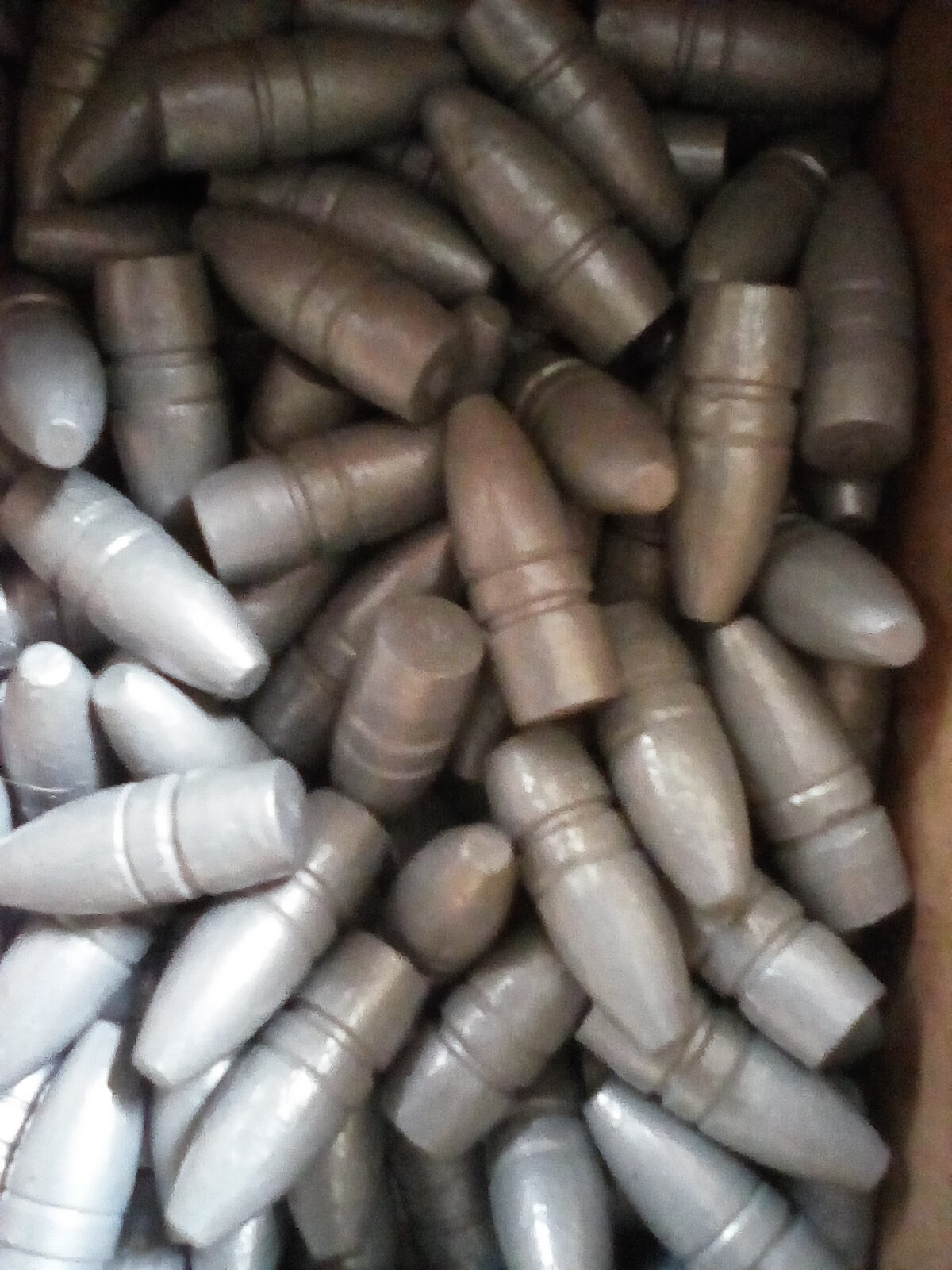

I thought same thing...My .510 Texan with 650 grain spire point boat tails will scope any unsuspecting shooter. I don't let anyone inexperienced shoot anything over 460 grains. That is 1.5 once of lead....Power goes up...slug weight goes up...recoil goes.up...
I agree with what you're shooting. But that is such a tiny minority of what airgunners are shooting. I remember shooting my Marlin 45-70 at the range, sounds like a cannon. A buddy was near me and asked to shoot it. I put three rounds in the mag and handed it to him. He took one shot and handed it back. I told him there were two more rounds. His reply, "No thanks" LOL
