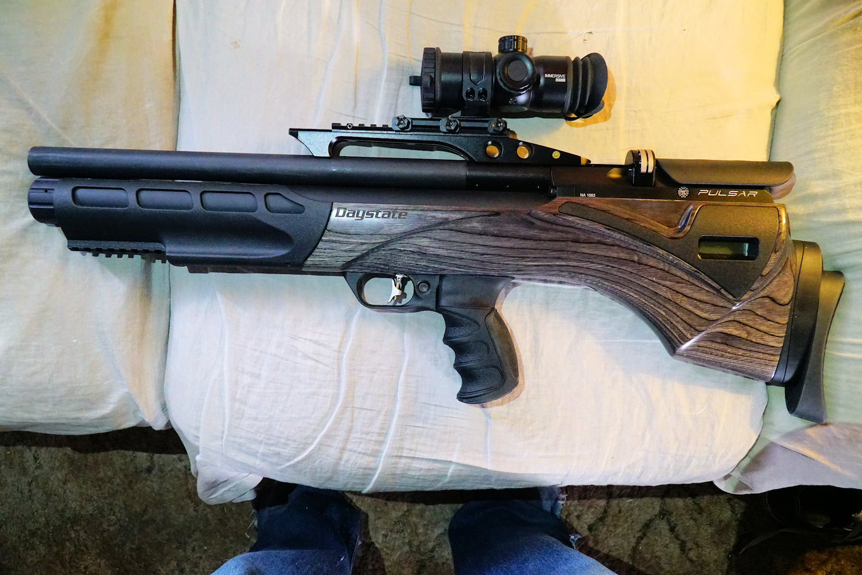

And a grey laminate stock version with a Heli-board swap and a different grip

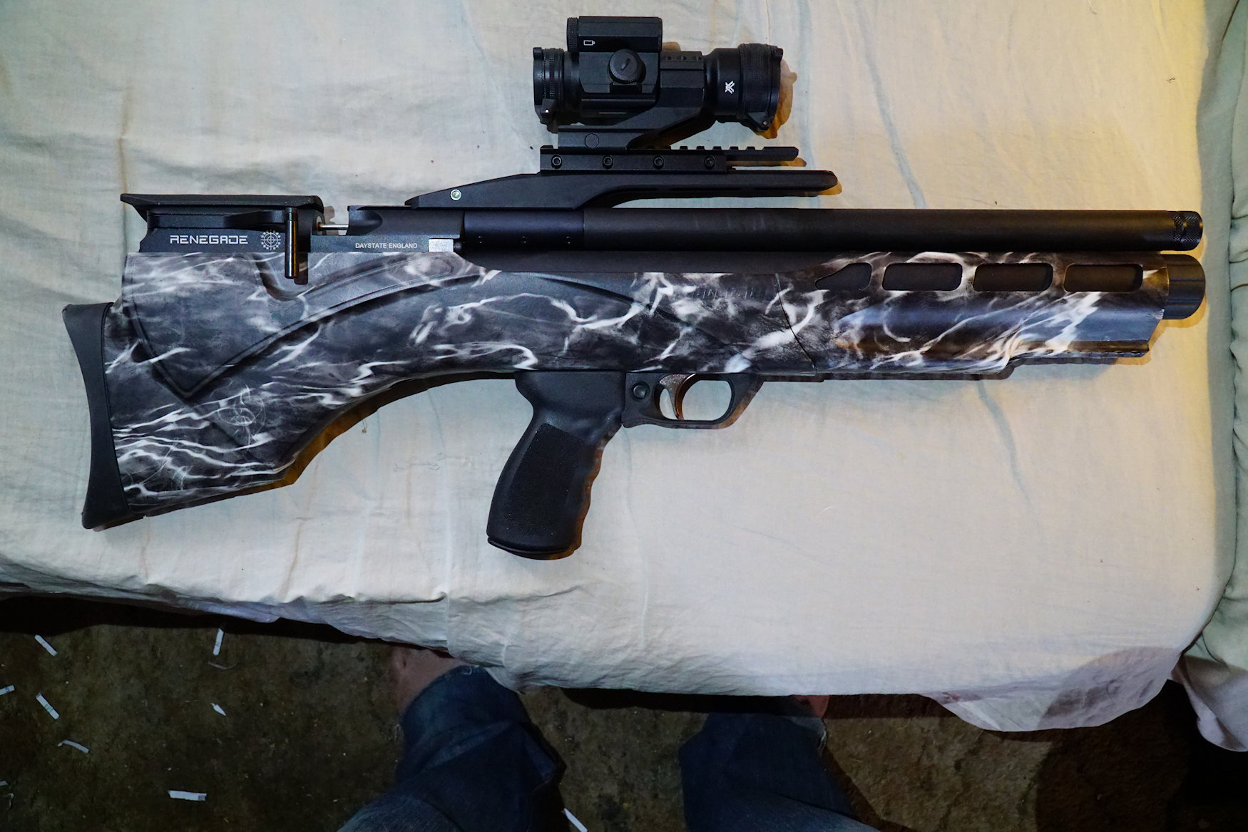

The Renegade The Renegade only has the trigger electrically controlled.
That's a vinyl wrap over the black plastic stock.
