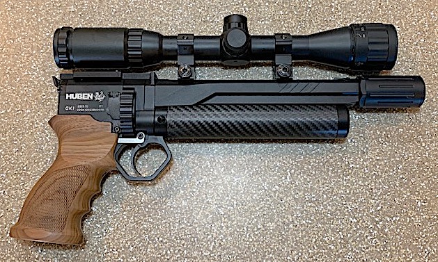

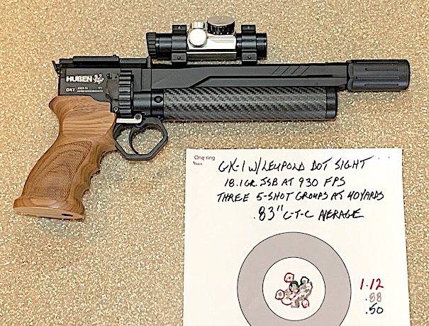

A full, 19-shot magazine group measuring 1.4" at 50 yards shot with my Chinese Huben GK-1 semi-automatic PCP PISTOL-

did you actually say that the huben gk1 barrel is Chinese 🤔 or did I misunderstand what you said..
I thought it was a German barrel..hard to imagine paying so much for a huben gk1 with Chinese parts.. where is the rest of the gun made? China too??
not that I can afford one but everything I have read they sound like top notch, best pistol you can buy..

Not sure if the Chinese made GK-1 uses an off-nationalitied barrel, but I doubt it. Given its accuracy, moot point anyway.
The GK-1 is in league all its own. Nothing else even comes close.
FWIW, though only one group, the 1/2" group at 40 yards (above) is 1.25 minute-of-angle; from a pellet pistol at 40 yards.:oops:
And few rimfire target pistols can average 7/8" groups at 40 yards in real, outdoor wind conditions.
