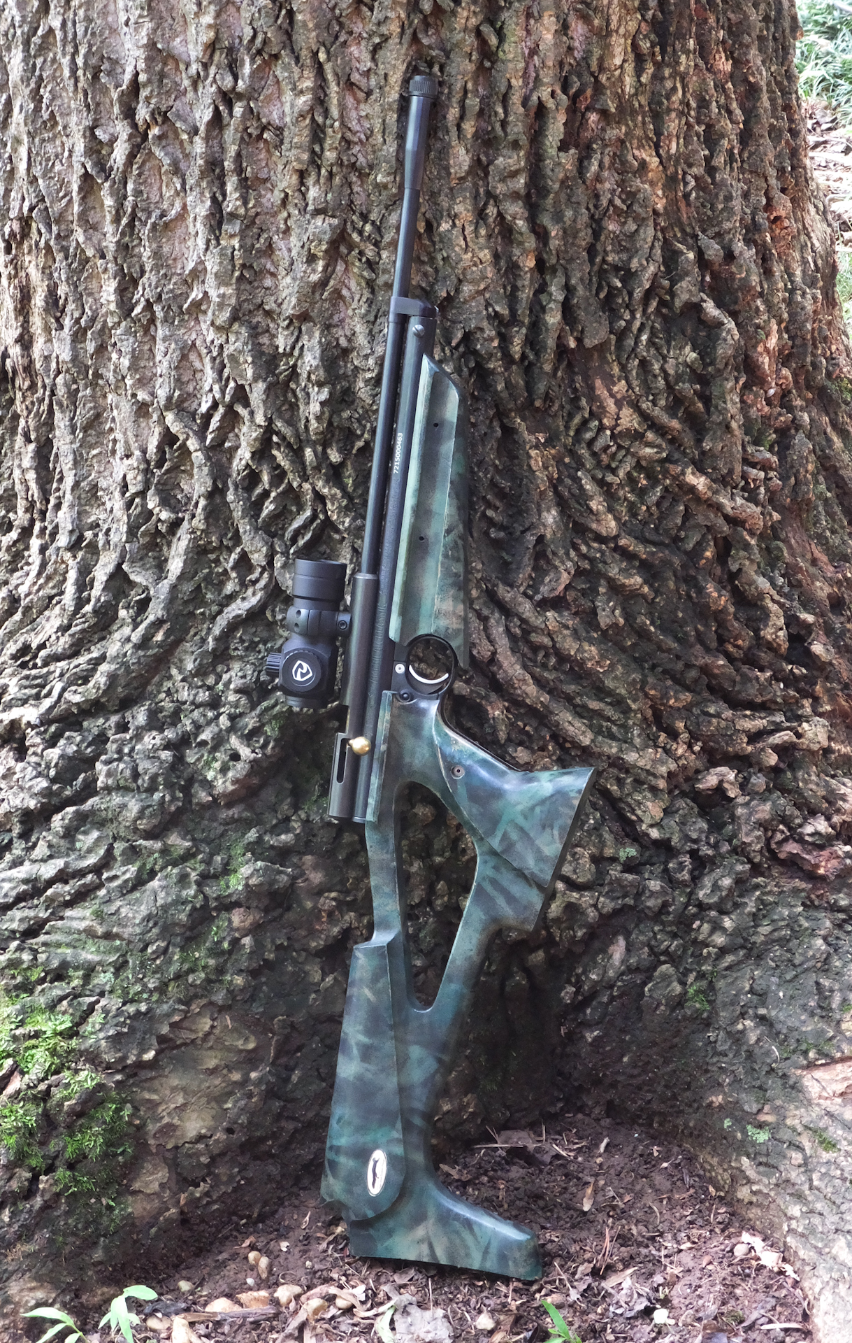

That is impressive! I barely get that with my 1322/66 build at 14 pumps. With the 15.43 grain. Going to tear into it again in the future. I have a old solid piston that I will install next to see what she does in this 1322.
I wanted to keep the piston cup to see if it would last longer as the cup would reduce the metal to metal contact when closed.
The 66/m4 pump tube is way easier to pump as it has a longer arm. I once built a13xx/2200 with a14 inch barrel and got 640fps with a flat top setup but wore out the pin holes as I'm sure I did not adjust the piston correctly.

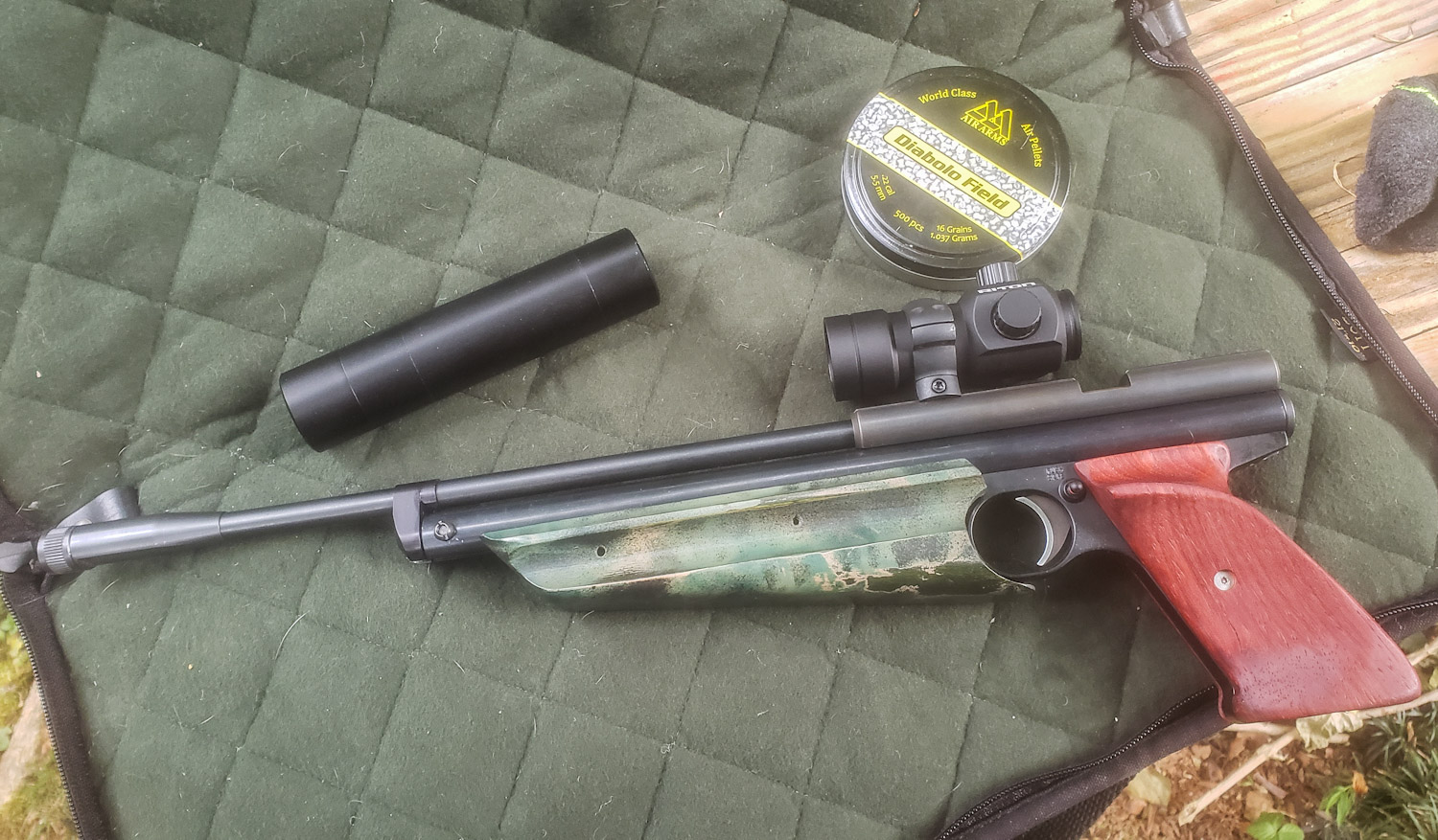

How did you do that barrel band?
I used to have a solid brass flat piston in mine, and it's just not ideal. You are almost certainly going to wind up with either too little or too much headspace. The one I'm using is adjustable. Delrin, so it's not metal on metal, and it has two oring seals that are easy to service if need be. That's the one from mountain air custom.
The positon cups actually work very well. But with that inlet pin mod, I imagine the cup is flexing a lot at max compression. That pin mod really makes a big difference in pressure since it reduces dead space to almost nothing.
That is a very cool 66 build! Always wanted to do something like that, but just kind of maxed out the 1322 and left it at that. Maybe some day.
I assume you meant the band in the first photo? It's a 2240 band that I cut, bent, and re-welded. Was not fun to get on or off the gun. And still didn't work all that well. Had a plastic 2289 front band. Tried a few drilled 13xx bands. I tired a solid aluminum one from the UK as well, but the barrel hole wasn't true. And the end that slid into the tube was under sized, so it really wasn't worth more than scrap. Upon checking just now, I do not seem them listed at all on their site. But the final band is a maverick custom unit. Fit and finish on it is perfect in every way. Cost 1.5x as much as the gun it's self, but well worth it, IMO.
