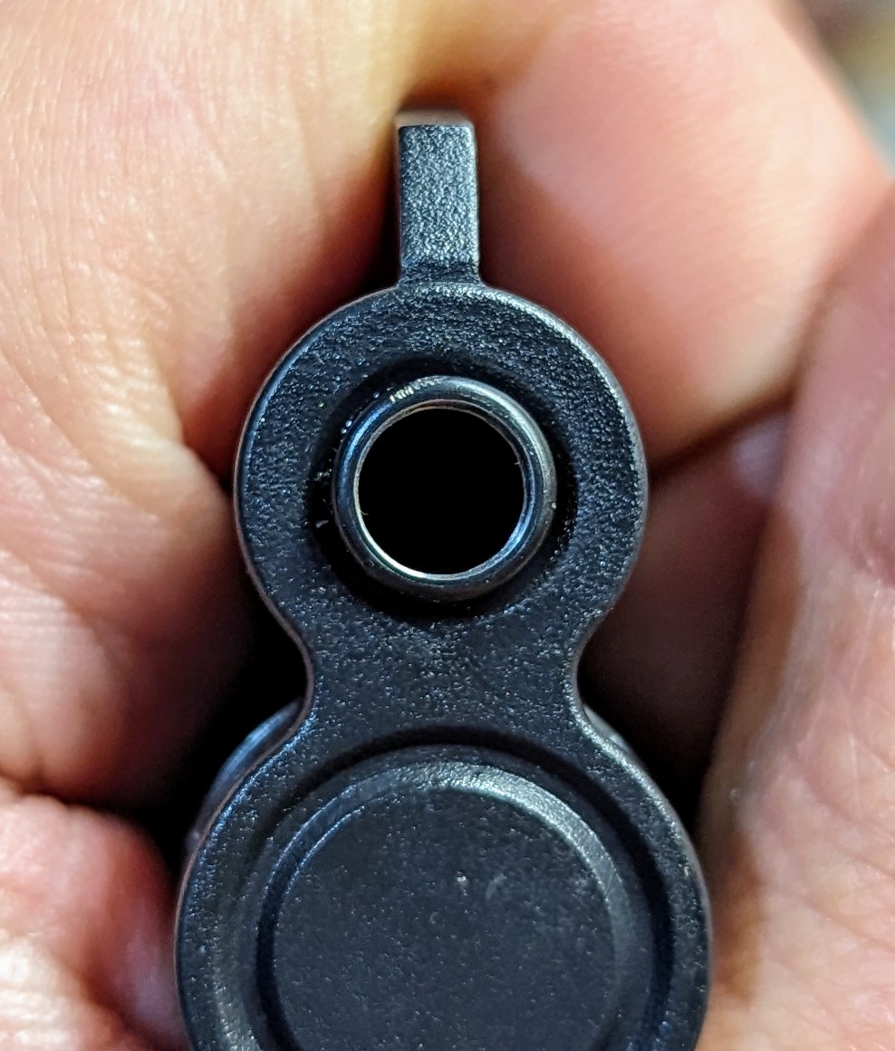

This is my first post. I bought a 1322 from Amazon. I installed a baker aluminum breech and a red dot sight. Accuracy seemed acceptable right off the bat and from the bench I proceeded to shoot off hand over the last month. I used it to dispatch a couple juvenile groundhogs in a live trap and shot a couple rabbits and a squirrel out of my garden and I've done quite a bit of plinking. All seemed well. A few days ago I installed a 1399 stock and added a pool noodle cheek rest which still doesn't get my eye up to the ideal height, but it's okay. Yesterday, I was plinking around and noticed that I was missing a medium size soup can at about 12 to 15 yd. This seemed weird because with the new stock my stability was very much improved. So I got out some paper and started shooting from a bench. It's all over the place. Don't know if accuracy was slowly diminishing and I just didn't notice it shooting off hand as a pistol or what. It's shooting like 4 in groups at 15 yards. I tried crosman domed, pointed and some Gamo hunting pellets all had the same results. I cleaned the barrel and it took forever until the patches were fairly clean. That did nothing. I took the Red Dot off and shot open sights but that did not help matters. I took the metal breech and barrel off so I could inspect things. I noticed that the bore seems off-center in the barrel at the muzzle. Also, the crown seems weird. There is a bevel on one side, but almost none on the opposite side. Hopefully my picture attaches. I'm not sure how things could have changed from when I started shooting it. I've probably got 300 pellets through it, maybe more. What do you guys think of the muzzle area in the picture? Could this be causing my troubles? It's pretty frustrating because I know this can be an accurate pistol from everything I've read and I don't want to shoot at animals if it's behaving like this. At four or five pumps, I had good lighting to watch the pellet travel against the white of my paper Target. Some of the pellets seem to just veer off one way or the other. Looking for advice. Thanks!

I've had 5 factory barrels that were all bad. .22 caliber. Not to say good ones don't exist. I'd at least try cleaning the barrel. Could be a pretty rough rifling job making it foul badly. If so, you can try polishing the bore.
Personally, I'd pony up the change and try and see if crosman will sell you a 14.5" Lothar Walther barrel. You have to call and give them the part number. They normally reserve these for custom shop guns, but if you try enough times, maybe call every other week they'll probably sell you one.

Wow, I thought this had died as I was not getting any more email notifications. Apologies for the neglect. Good news, I got in touch with crosman and they sent me another 1322. Received it today. Did some side-by-side shooting, first with both guns in their stock form and then with the new gun equipped with the aluminum breech and Red dot. The original gun continued shooting erratically with about a 2 and 1/2 in spread and the new one was shooting about an inch at around 9 yards off hand in my garage. Crosman domed pellets. Hopefully it continue shooting well with time. The only thing that has me a little concerned is that they sent me a Canadian version that has a bunch of French on the box and a claimed Max velocity of 460 opposed to 550 on my original purchase.

IF it was shooting good as you say THEN it wasn't . I would say it is not your barrel /Barrels do not just go bad , I would advise to take a small wooden dowel and slowly push a pellet through ,feeling for a slight snag ?
I believe that it WAS shooting as good as this new one IS currently shooting. I agree, I don't think The barrel itself changed, but I could see there being some issue with the bore that caused some sort of fouling after shooting it for a while.
I see this post is old but I hope you figured it out. It could possibly be a small bur that is catching the pellet as it travels over the transfer port. I've seen it where there will be a small bur on new barrels, maybe it was exposed more scraping the pellet. Only time I experience a pellet gun do this is when I swapped breeches and forgot to tighten the grub screw.
