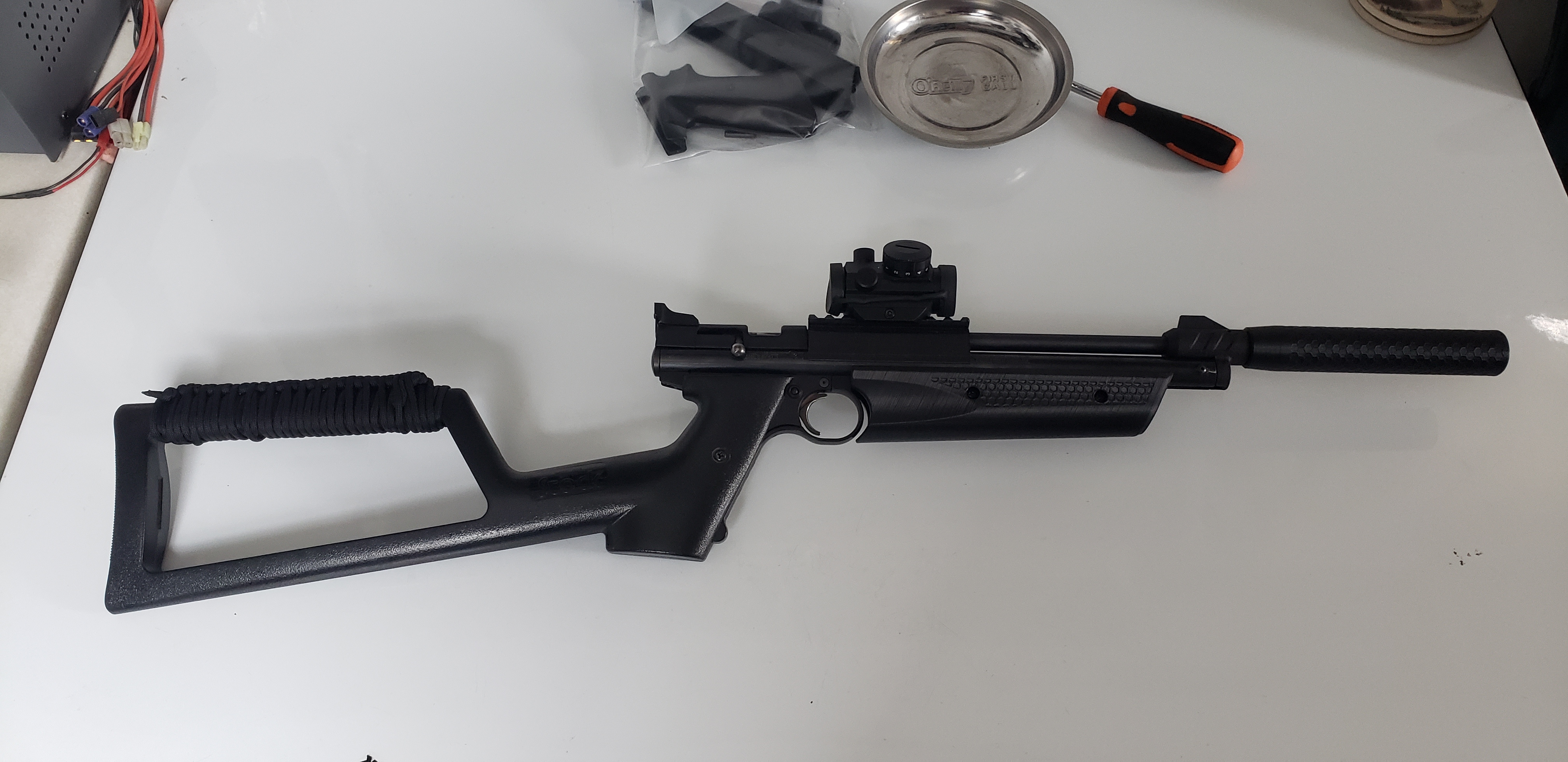

New package from Buck-rail.com and this 1322 is almost done, now for the 1377 lol.
What- no steel breech? Just kidding. Nice build, the 1322 is a sleeper IMO and well worth having. I really want to build a nice shoulder stock to make mine a carbine, but haven't made time yet.
Lol thank you and no I think that will happen on the 1377 build and I agree this platform is as much fun to build as it is to shoot. I'll be watching out to see what you come up with 👍

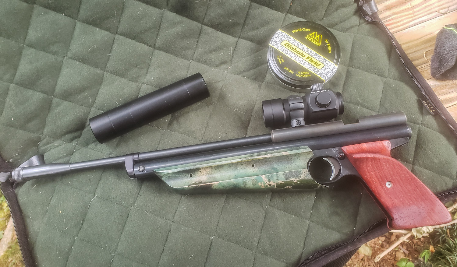

Fwiw, I think even with metal parts these guns are still pretty light. Honestly I prefer more weight. IMO, makes for a more stable gun. Translates into more accurate shots. I've got 2 1322s myself. One is a pcp, and it is very heavy. Heavier than my all steel 5" .45 acp 1911. The pumper, I don't know the weight of, but it still feels light ish. Steel thread adaptor, steel breech, aluminum barrel band. Used to have a solid brass piston, but now has a composite one. Has dense African rosewood grips. Dense grips can have a pretty significant positive affect on stability and accuracy as well. I have ebony ones on the other one.
Of course theres plenty of reasons to want a light gun. And the rabbit hole is deep :ROFLMAO: so, sometimes it's best to keep it simple and effective. Effective being the most importaint aspect.

That's a beauty and I do like weight in some of my target guns I agree that it adds stability, this one is more for ratting so quick pointing is a plus. Yes I am discovering that the rabbit hole goes way too deep on the 13xx's but that's the fun in em right 😂
