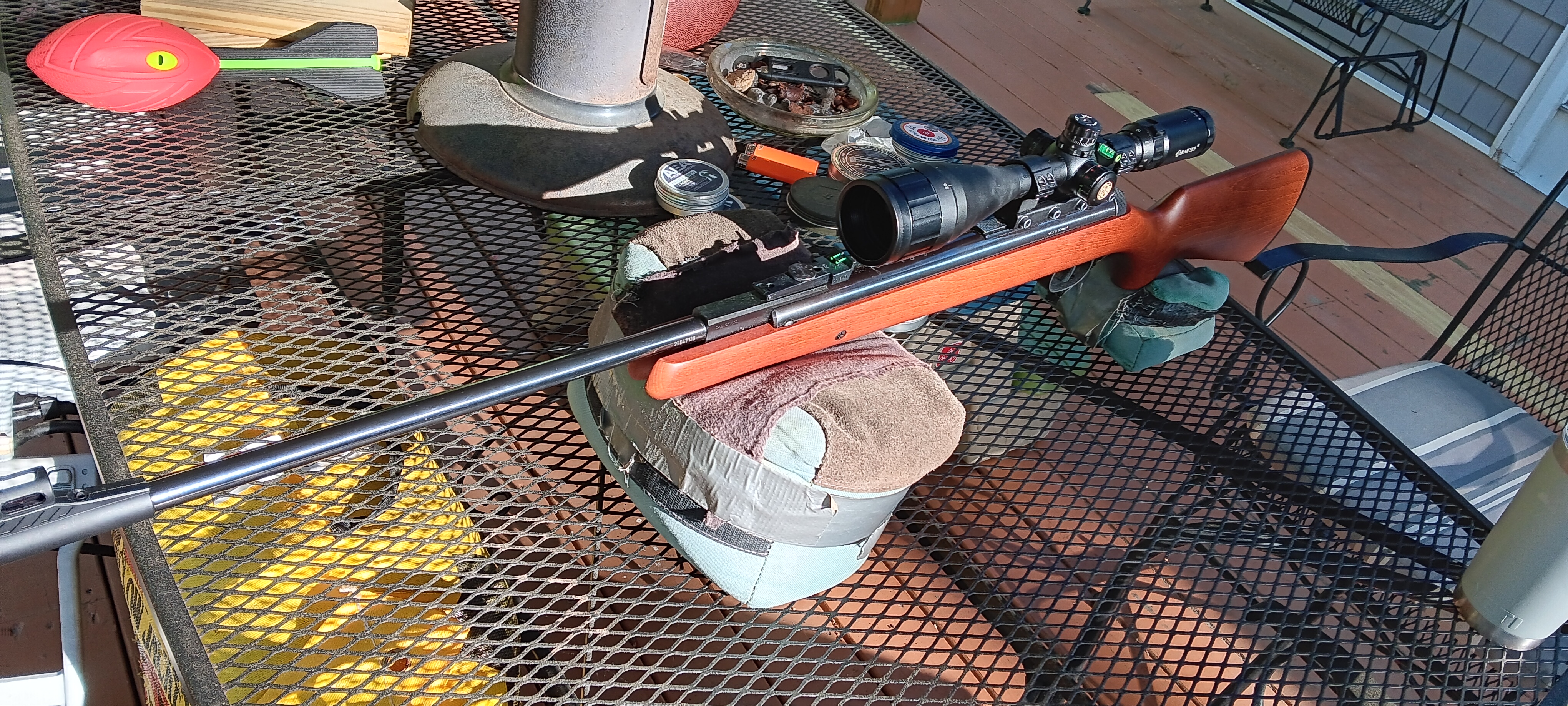

Get the diana 34 22 cal with a wood stock and never look back. I have own way too many springers and my 34 will do basically the same as a hw97 . I actually bought mine from PA as refurbished and it looks perfect . Stay away from the ems version just get what I have .
