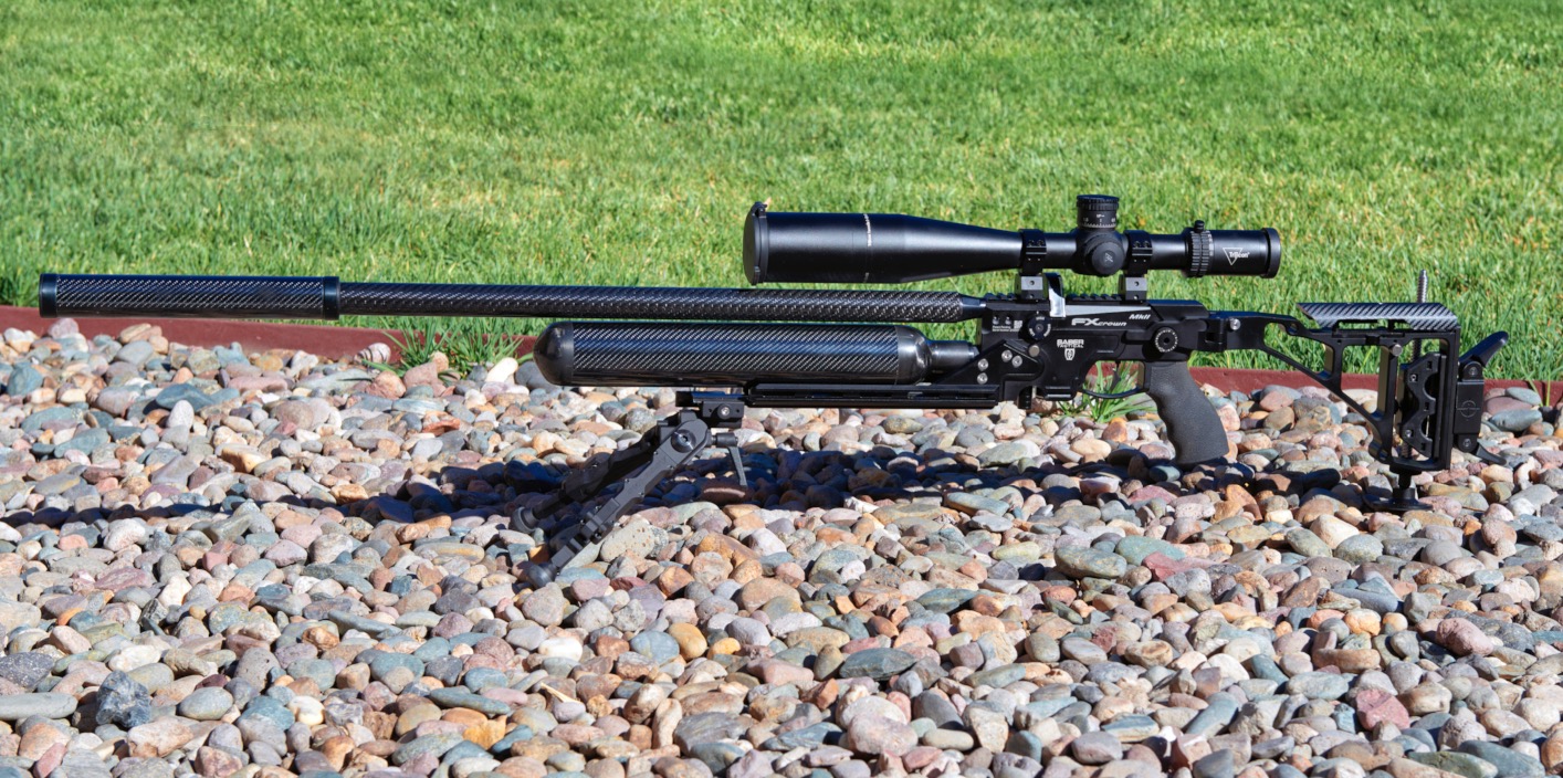

Sweet!Get the FX Crown with the quiet Silent Thunder Ordnance Accipiter moderator, Saber Crown chassis, 700cc bottle, shooting the 25 cal JSB 33.95 monsters and top it off with a Trijicon 5-50 and never look back

I picked up a used FX Maverick in 22 caliber, which I've now changed to a 600mm 25 caliberI would look for a used raw or fx
I'm almost surprised that you eventually changed your Mav out to a .25 cal after how you had it shooting the .22 cal 25.4 grain pellets. Unless you wanted the extra hitting power of the 34 grain pellet or heavier slugs?I picked up a used FX Maverick in 22 caliber, which I've now changed to a 600mm 25 caliber
I switched to the 25 caliber for the extra knock down power. It's now generating 71 FPE with the diabolo 33.95 heavies. I rarely shoot out past 50yds, so less BC isn't much of an issue. I do miss the higher shot count of the 22 though. Even when I back the power down to shoot the lighter hades pellet, it's still hitting around 52 FPE.I'm almost surprised that you eventually changed your Mav out to a .25 cal after how you had it shooting the .22 cal 25.4 grain pellets. Unless you wanted the extra hitting power of the 34 grain pellet or heavier slugs?
If shooting pellets the 25.4 gr .22 should have a better BC as compared to the 25.4 gr .25 due to its smaller cross-sectional area. I have a Mav Sniper in .22 and love its performance out to 100 with the 25.4 pellets (I shoot 99+% pellets).
At any rate, the Mav with its big plenum is a great gun for you to have chosen, especially in any of the longer barrel configurations where that plenum volume can be so well used. Congrats.
