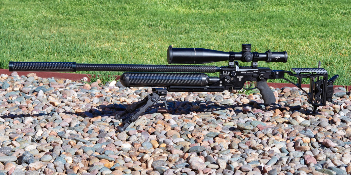

Just wanted to update everyone on the Maverick. Quick recap, Maverick in 22 caliber with 600mm barrel, Huma Mod40 moderator, sekhmet mini digital gauges, 480cc carbon bottle, and carbon fiber barrel sleeve. I added a UTG 4-16X44mm scope I had laying around, and picked up a Saber Tactical bag rider.
Last couple of weeks have been a learning experience as I've familiarized myself with the gun. It came to me perfectly tuned to shoot jsb 18's around 925fps, but as expected I eventually wanted more power. I've been tweaking and tuning constantly, trying different pellets/slugs along the way. Thanks to this forum I was able to get plenty of tuning tips by searching, and now seem to have found my sweet spot.
Regs are at 160/125, internal hammer screw 4.5 turns clockwise from maximum. On pw7 I'm at 945fps with FX 25.4g pellets and the accuracy is amazing, even pushed out to 100yds with 1.5" repeatable groups in favorable conditions. FX Hybrids also group fantastic and have been my go-to round for the medium size critters. PW7 has them around 975fps. I can also dial the power wheel down in the 3-5 range and shoot both jsb hades and H&N barracuda extreme hunters very well. I like using the lighter weights for birds and squirrels inside of 35yds.
Overall I'm extremely happy with the Maverick. I haven't done a full shot count yet as I typically just top off once I get down to my first reg pressure of 160bar. That's good for around 60-65 shots at full power so I'm guessing I'd get at least 80 shots before dropping under the second reg. I noticed a measurable difference in air consumption once I started to really get a grasp on the tuning, all thanks to tips learned on this forum.

I switched to the 25 caliber for the extra knock down power. It's now generating 71 FPE with the diabolo 33.95 heavies. I rarely shoot out past 50yds, so less BC isn't much of an issue. I do miss the higher shot count of the 22 though. Even when I back the power down to shoot the lighter hades pellet, it's still hitting around 52 FPE.
The best part of the Maverick is the fact that I can always move back down to the 22 caliber in the future, I'm keeping the 22 set-up in case I get the urge. But I doubt I ever will as I have a couple of other 22 caliber PCP's that are also tack drivers. That was another reason I went to the 25 caliber since I already had a couple of 22's. They are in the 32 FPE range with JSB 18's. All in all I've VERY happy with the Maverick. I really love the fact that it's not very ammo picky either, at least with pellets.
