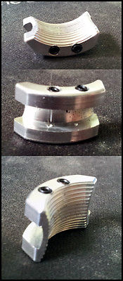

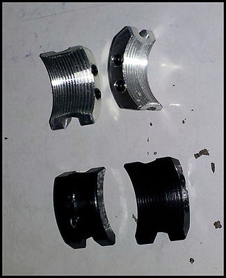

I highly recommend putting a trigger shoe on. It made my trigger feel 24 times better.
Here's what I went with. Much cheaper ones available but I liked this one.
https://www.ebay.com/itm/Crosman-1377-1322-2240-2250-2300-2400-Black-or-Silver-Aluminum-Trigger-Shoe-/331555692256?varId=540711193038&txnId=1646431374014
Trigger in the background.
The Trigger shoes I've used have the two grub screws and the shoe is not as long as the trigger blade so it can be moved up and down the blade while retaining its own curve and based on how high or low you place it along the trigger blade and how deep you set it against the blade. Mine is not completely flush with the blade itself because there was enough adjustment in the two screws for me to get it to what I liked most. It's hard to imagine until you start playing with it and adjusting it to your own actual finger.

I think one of those trigger shoes might work out if the trigger doesn't get to close to the front of the trigger guard
