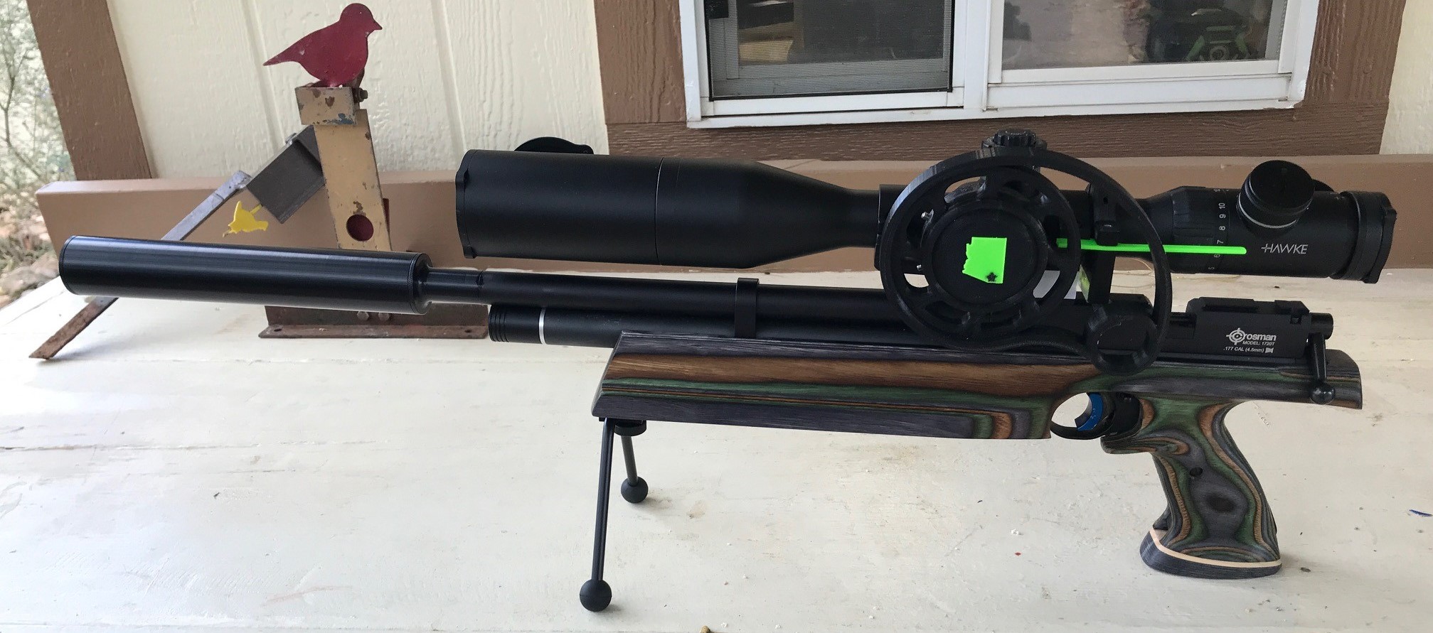

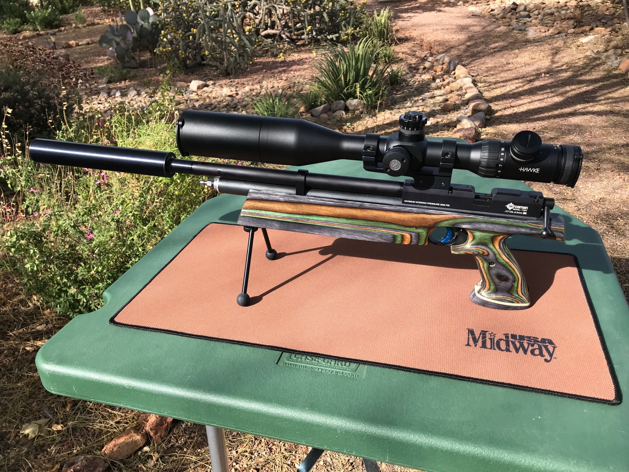

Correct. This is the adapter (from DFL) to attach your Donny or other mod. I'm currently using it to attach a Donny FL Sumo on my 1720T. It says you don't need "to remove the supressor to fill the gun". I'd love for someone from DFL to show me how they do that. Bout' a 1/2" or so too short and the air line coupling hits the back edge of the mod. I have to remove the Sumo every time to fill. Maybe with a supressor that has a taper at the threaded end it's possible.....
Or, if you go with the Hill 8" mod. you don't have to take it off every time to fill. And the adaptor is built in as part of the moderator. Sound level is ever so slightly louder than the Donny FL Sumo. I'm not using it now, I just use my Sumo. So, if you have any interest either PM me or I can list it in the classifieds.
