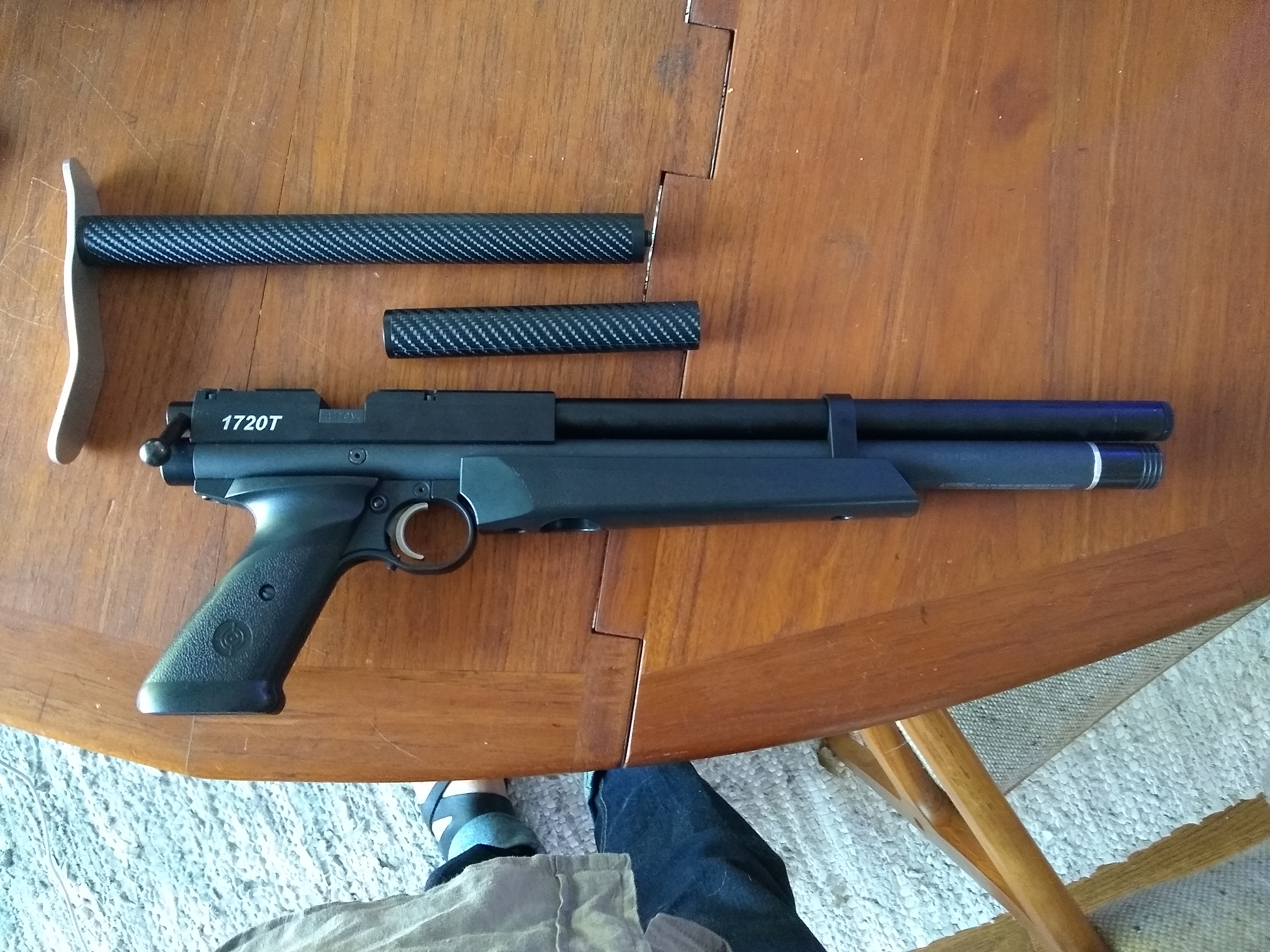

Here's mine: Corcoran furniture, tuned by Mike at TKO who also provided my moderator and the carbine extension. I replaced the aluminum butt pad with an old model Wokbutt. I'm running an Immersive Optics 5x24 with a single 1.26" BKL doublestrap ring. The stock mounts didn't quite fit right -- they impinged the loading area of the breech.
This is the easiest to shoot gun I've ever owned. Point and shoot.
It shoots Polymags at just under 800 and is an absolute laser.

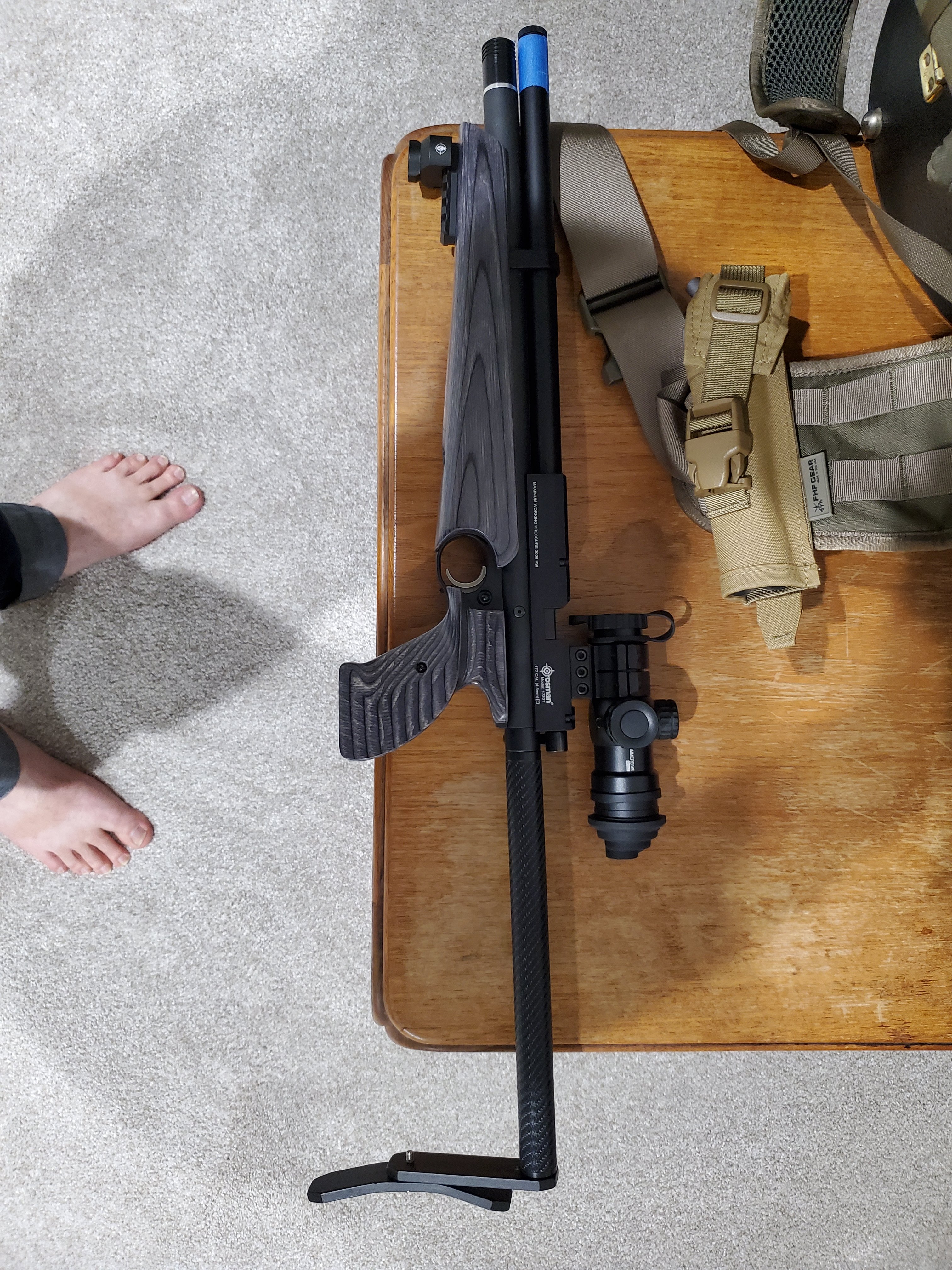

Here is my version of a 1720T. Currently tuned for 3-4 mags at 12fpe. I milled the breech for use with Mrod style mags, using an end mill in my drill press. Huma regulated with the larger plenum, sub 10gram peek hammer, peek poppet with 2mm stem diameter. The Rapid 70 bullpup kit was not very easy to shoot in as delivered form. I converted the pistol grip to use an AK style grip nut for ease of attachment with an adapter for using AR grips on an AK... This resulted in greater distance between backstrap and trigger. This improved trigger ergonomics significantly. I added a shotgun butt pad that I had lying around. Now it shoulders nicely. Prior to these 2 mods I was unhappy with the Rapid 70 kit and on the verge of selling it....the In the pic it has a 12 shot mag for a Umarex Synergis.
It is UGLY, but carries/shoulders/shoots very well.

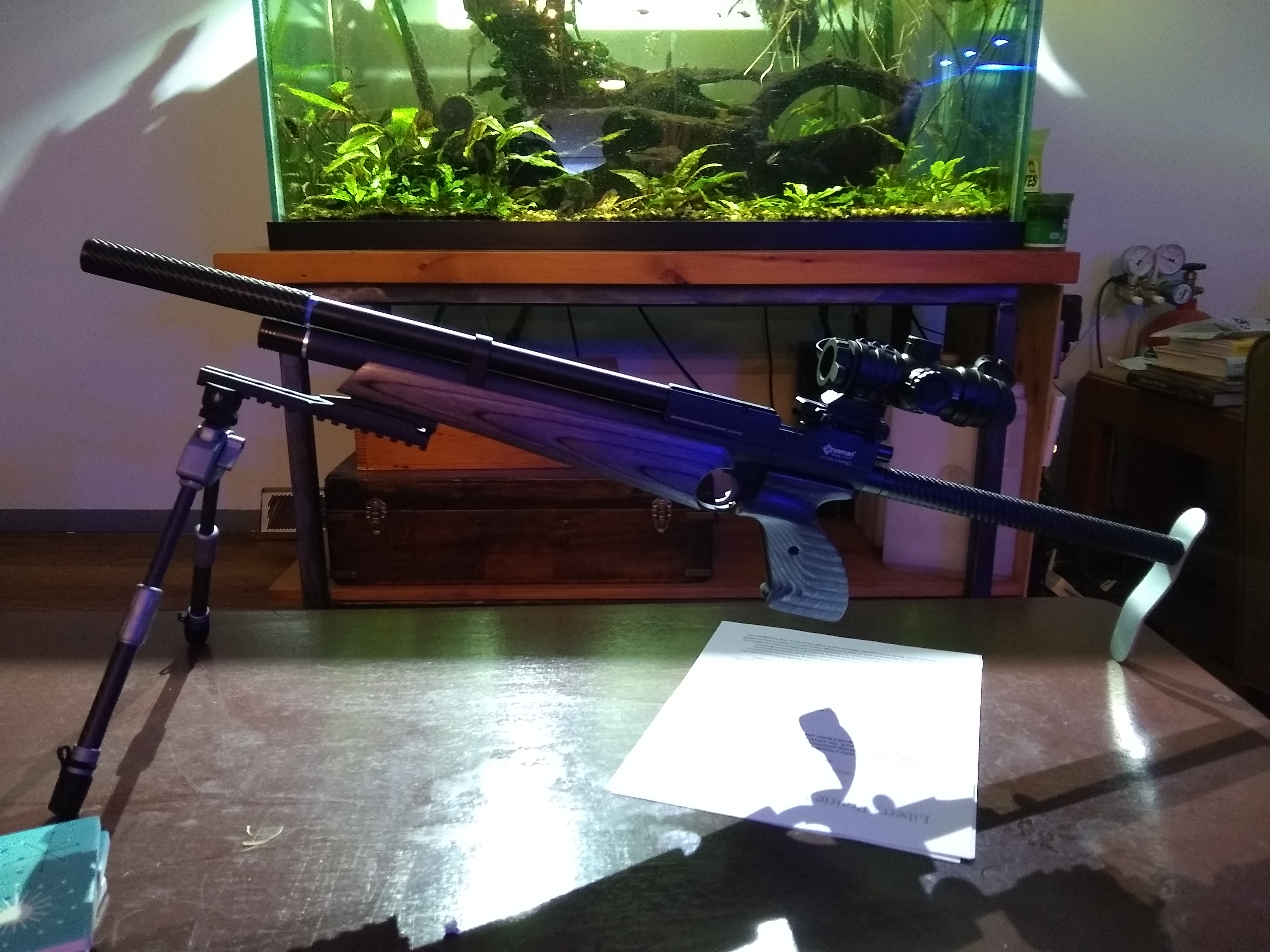

I really like mine as it's very accurate. I wanted this gun to behave more like a 2000 psi fill gun, so I swapped the spring INSIDE the valve for one from a Benjamin Maximus.
Cut the tube to 10 inches and added a drop block and bottle, reg set at 1500 psi for just under 18 fpe with AA heavies at 885 fps.
EDIT: Used a 21" DISCOVERY barrel purchased from Alchemy Airwerks. It is well prepped with an actual target crown. I have two.

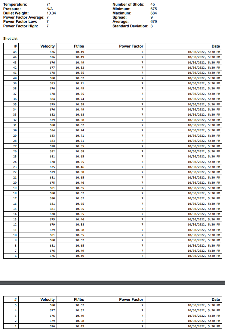

Here's the current tune on my 1720T......
I fill to about 3000-3100 psi then shoot about 30 to 35 shots then refill, rinse & repeat :)
I opted to remove the gauge when I installed the Huma regulator so I can't tell you how many psi I shoot down to, but I can tell you that after the 45 shots the poi starts dropping like a rock.

Wow, impressed with the mag conversion. Was it dicey, or straight forward?
It's getting kind of late here so I'll try to take a picture tomorrow and get it posted here.

It is straight forward but not very refined. One has to be willing to risk ruining the breech and having to buy a replacement.... A simple slot cut in the breech then the bottom of Mrod mags needs to be clearanced a bit. due to the close barrel to tube distance there is not enough meat in the breech to machine deep enough for unmodified MRod mags.
I was concerned with loosing accuracy when going to a mag, thankfully there was no discernable difference.
It's not the prettiest, but it works very well.

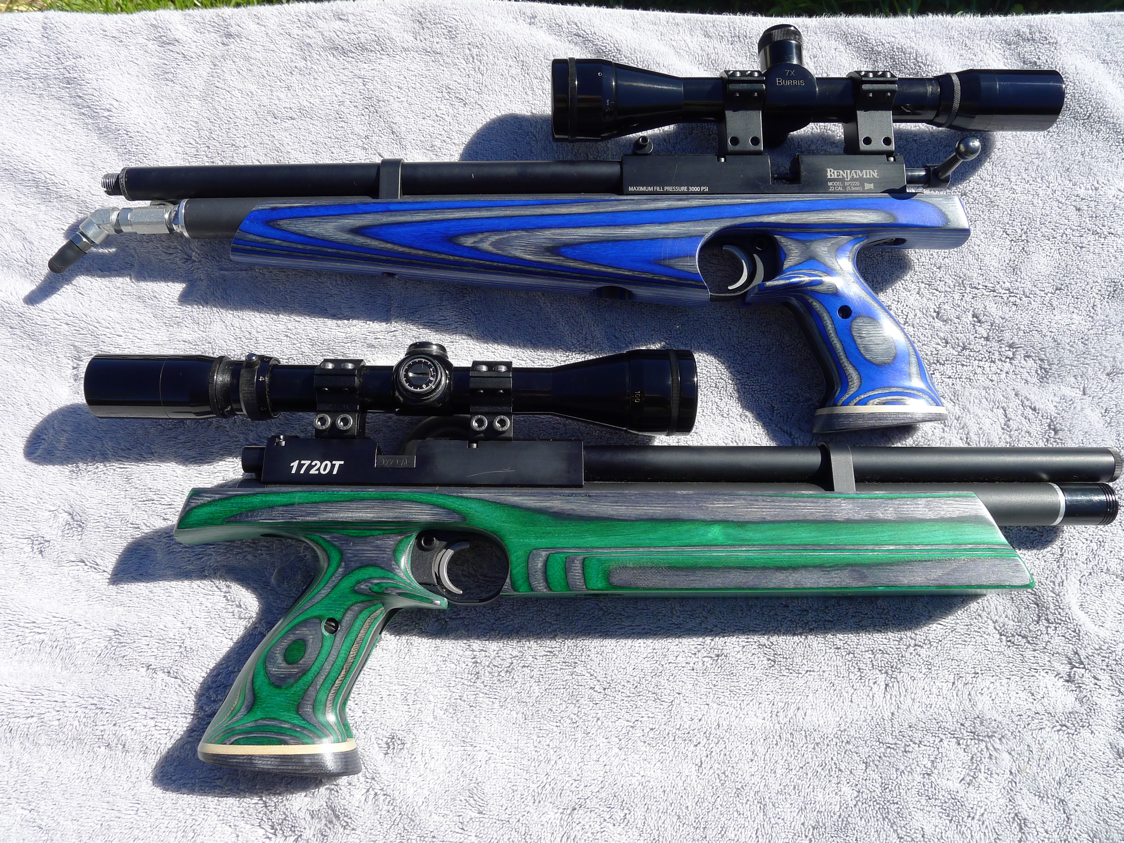

"Nice furniture --- Vernon Austin?"
His grips, refinished with the bullet-proof Fullerplast I used to finish custom longbows and recurves with; in order to get the soft lustre I prefer. The fore-end was inlet and rough shaped by a buddy, then I finished the shaping and Fullerplasted it (also).

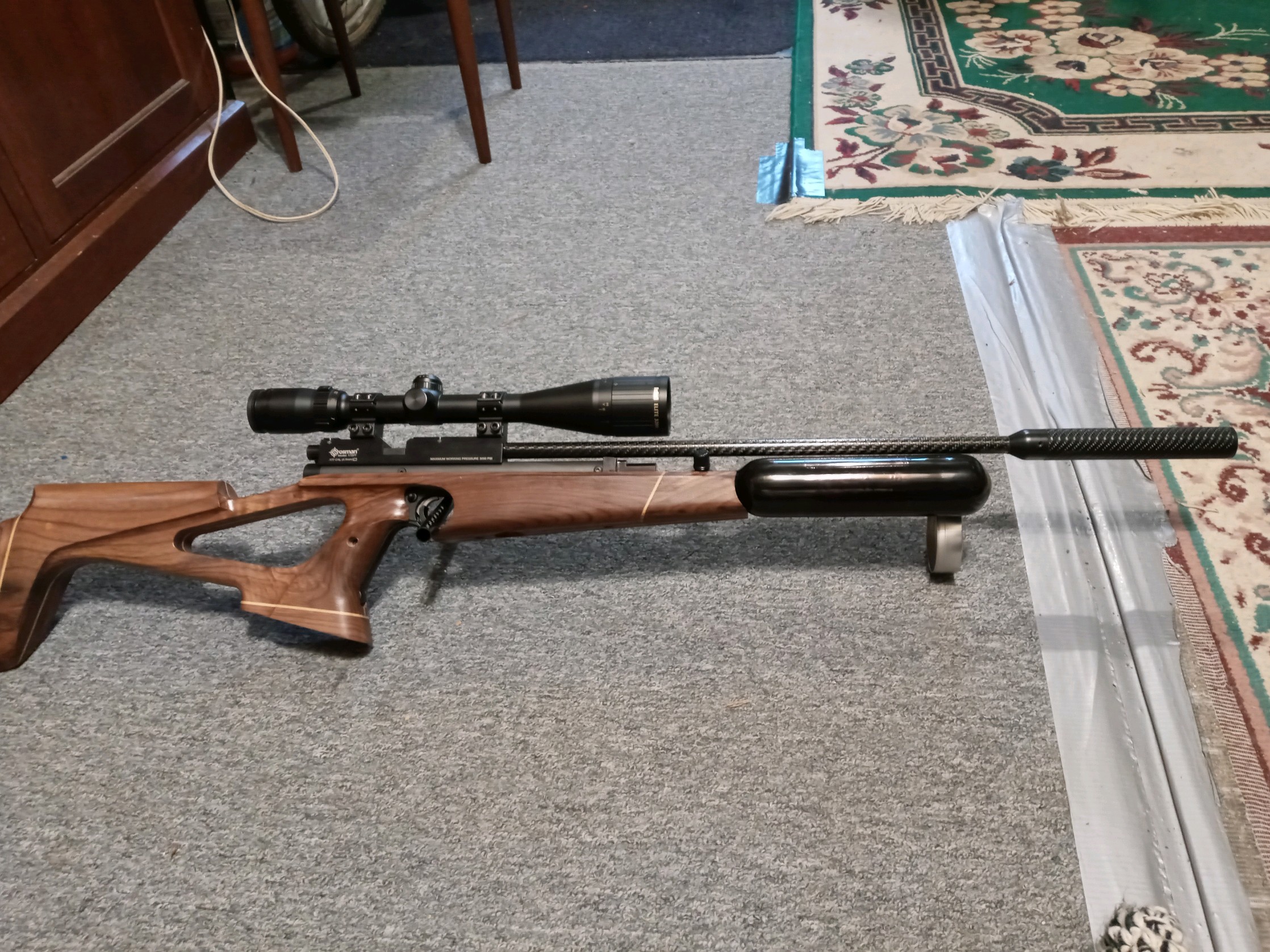

I've never been a very good pistol shooter. 2 handed on a rest and I am decent. My one handed pistol shooting is almost comical. But I do like short shoulder fired guns, including carbines. For my Prod/1720 based guns I have 2 identical powerplants/tubes/trigger systems the uppers can swap between. One is in the above pictured bullpup. The other uses a Gen 1 Mrod trigger and old QB78 stock.
