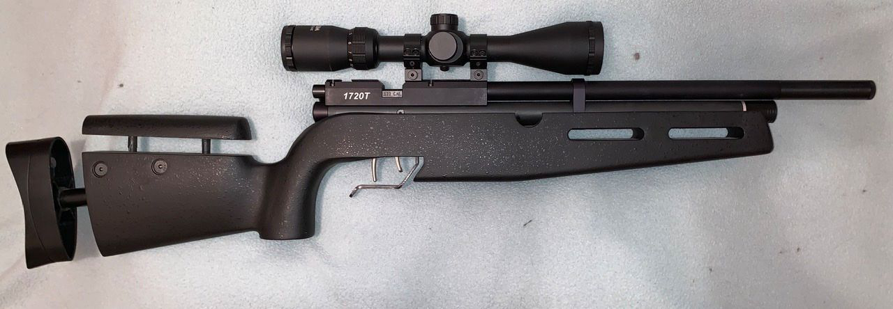

I've never been a very good pistol shooter. 2 handed on a rest and I am decent. My one handed pistol shooting is almost comical. But I do like short shoulder fired guns, including carbines. For my Prod/1720 based guns I have 2 identical powerplants/tubes/trigger systems the uppers can swap between. One is in the above pictured bullpup. The other uses a Gen 1 Mrod trigger and old QB78 stock.
1720T Carbine
Prod Carbine

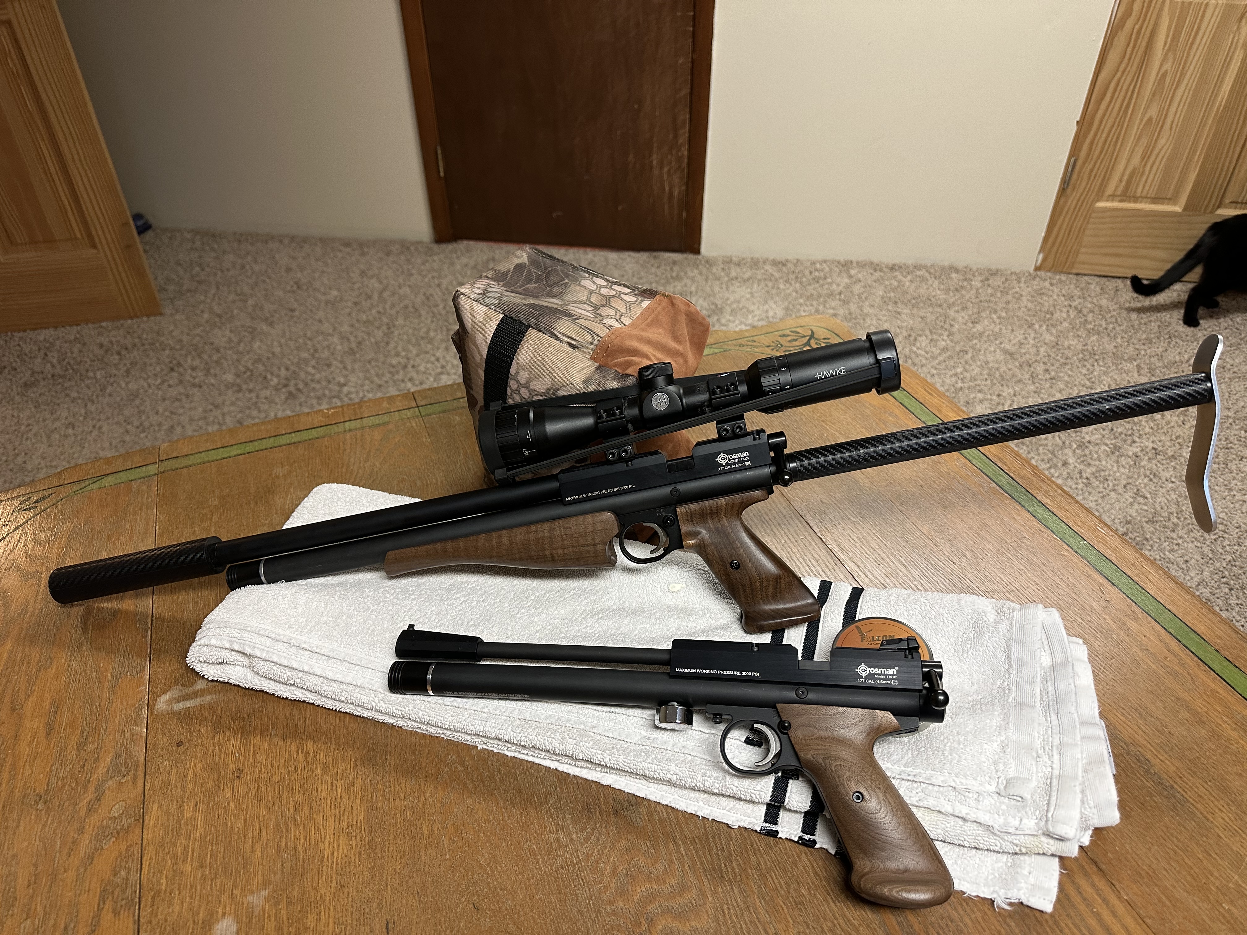

Getting ready to list one for sale, I even have a Corcoran Carbine stock I'd sell with it pictured here on my prod.
That has a Marmot M barrel, Huma reg, porting, lw hammer, trigger work, tko and other secrets done to it. It gets 24+ shots at 20+fpe.

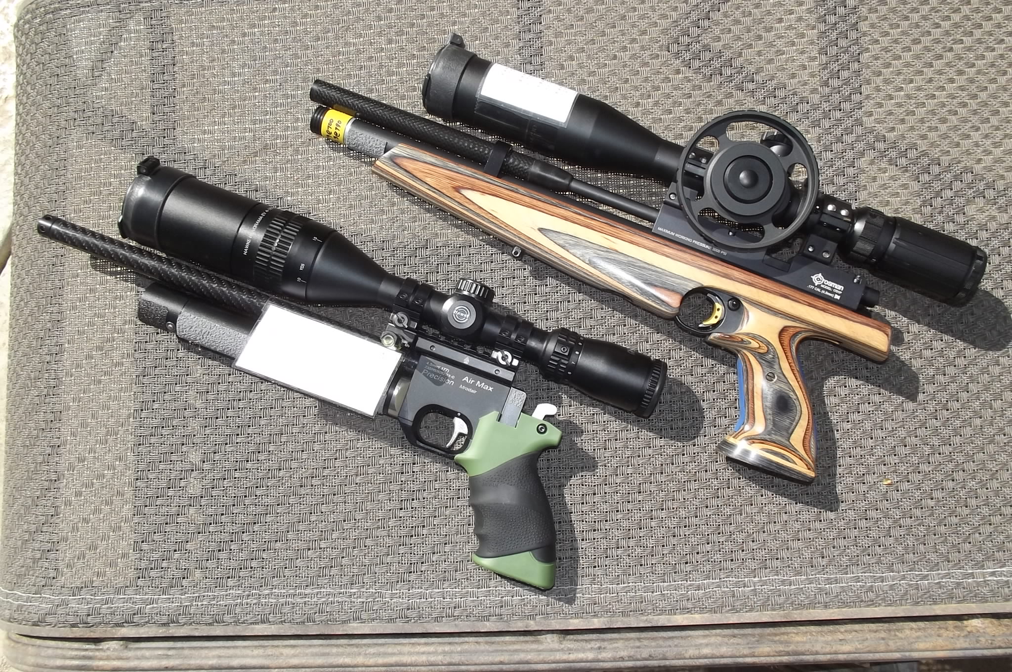

Up top ...
While not a 1720 ... a 1701 with the 1720 / prod air tube.
huma regulated, modified valve and LW hammer ( yea modified )
It won me 2 AAFTA HPFT state championships.
Love it. I have told several people the 1701 is worthy of a scope and will print fine groups at 50 yards. With your mods it must simply be an outstanding setup.
John

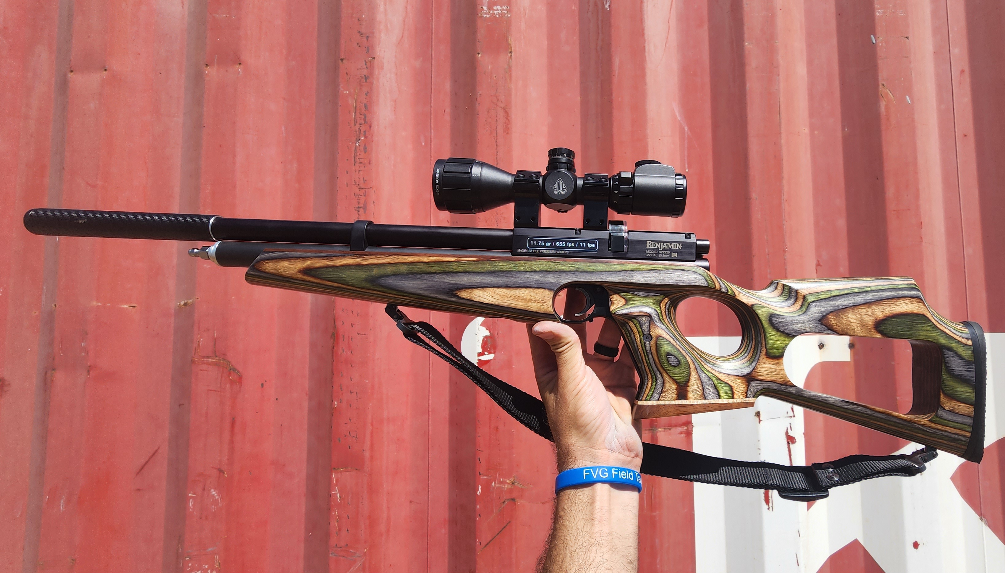

Hello @Kerndtc
That top rifle that you are holding is just beautiful :love: (y)(y)(y), is that a .177 cal.
ThomasT
The top one is a Marauder pistol, it is .22 cal and a tack driver. It's almost a little too nice for me. A perfect compact 20fpe .22 that shoots Hades lights out.
The stock it's in can be swapped between the 1720 and the Prod.
What barrel did you swap in here?
A Discovery barrel, I edited my original reply. A .177 Discovery barrel doesn't have the nice flat spot milled for the transfer port, but I used ice maker tubing so it doesn't matter. Don't let anyone tell you a Disco barrel won't work on a 1720, it does -
EDIT 12-6-2024 : I have since replaced the Discovery barrel with an M-Rod 20" barrel that HAS the nice flat spot for the transfer port.
