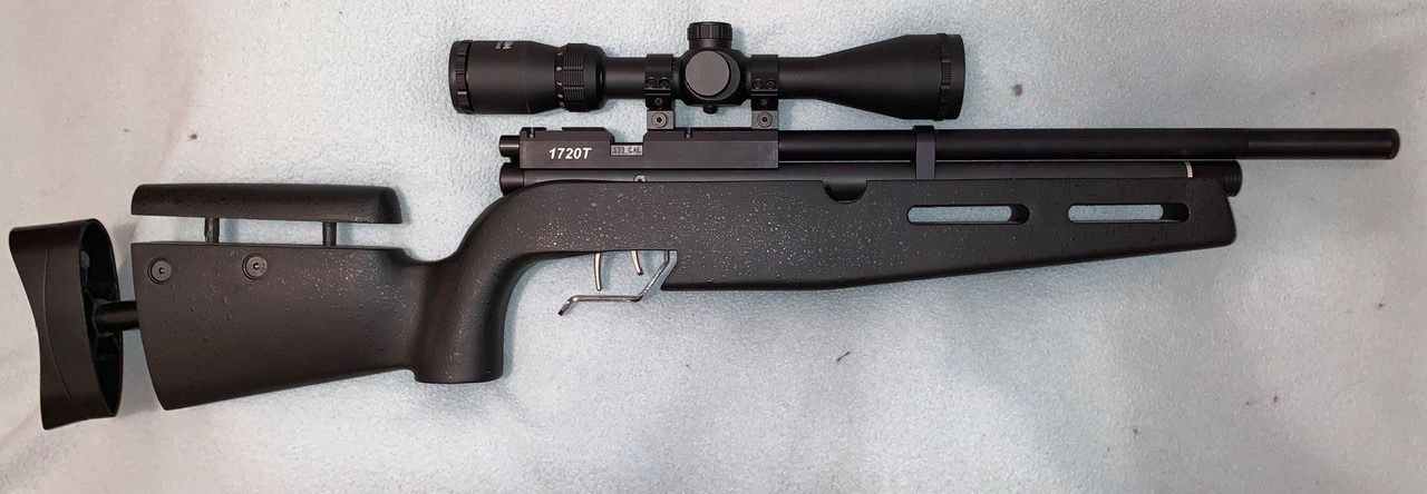

My project is to put my 1720T into a Crosman Challenger Stock. When finished, It will look exactly like the one in this picture. I have all the necessary parts and the exact same LDC as in picture. All I need is the time to do it!:)View attachment 309658
That stock is close to $400 from Crosman :LOL:
Asked them today when I ordered an extra .22 MROD Lothar barrel and a Fortitude tube.
The Fortitude tube can be modified by drilling two 4-40 holes (front ones, as the Fortitude breech has differently-located front breech screw holes and closer to the pellet loading port; the rear ones being spot on) to attach onto a PROD/17xx top.
Internals will remain the same, albeit the aluminum spacer between the valve and gauge block needs to be removed.
The advantage of a Fortitude tube is that you can mate it with a Boyd's Disco stock, with the air gauge in direct correlation to the stock's gauge hole unlike the PROD'S/1720T's-----that and double the shot count.
I'm making mine into a rifle with a Boyd's Varmint stock with an adjustable cheek piece.
It gonna look like a shotgun with an extended tubular magazine that is longer than the barrel----kinda rad, lol!

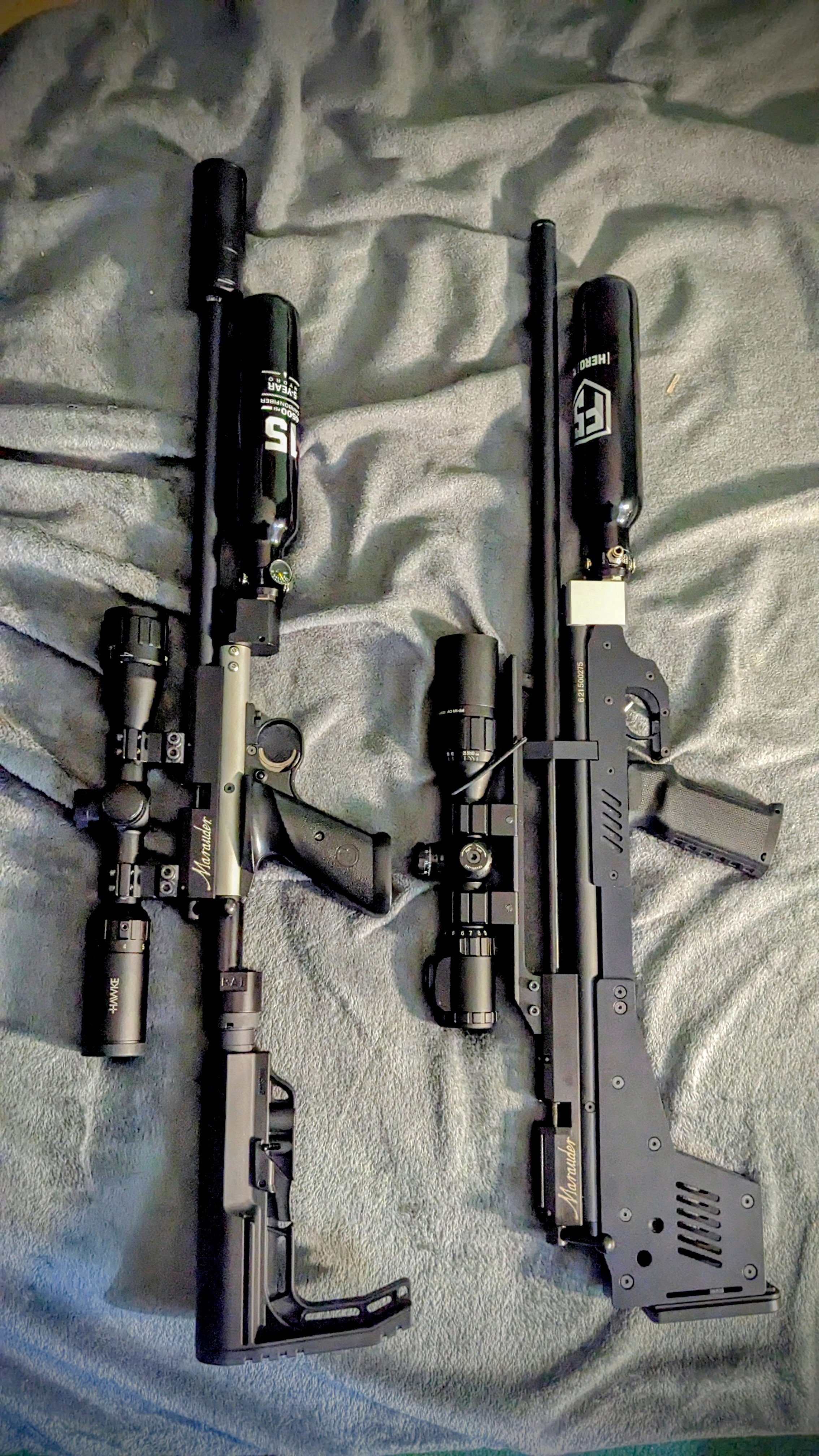

Hope I'm not crashing the thread by posting Prods, but here are my wife and I's Prods.
Good looking Prods. Lots of shots!!! I especially like the short tube version. I built a Gen 1 Mrod similar in that the is tube just long enough to allow space for the valve and tank block.
