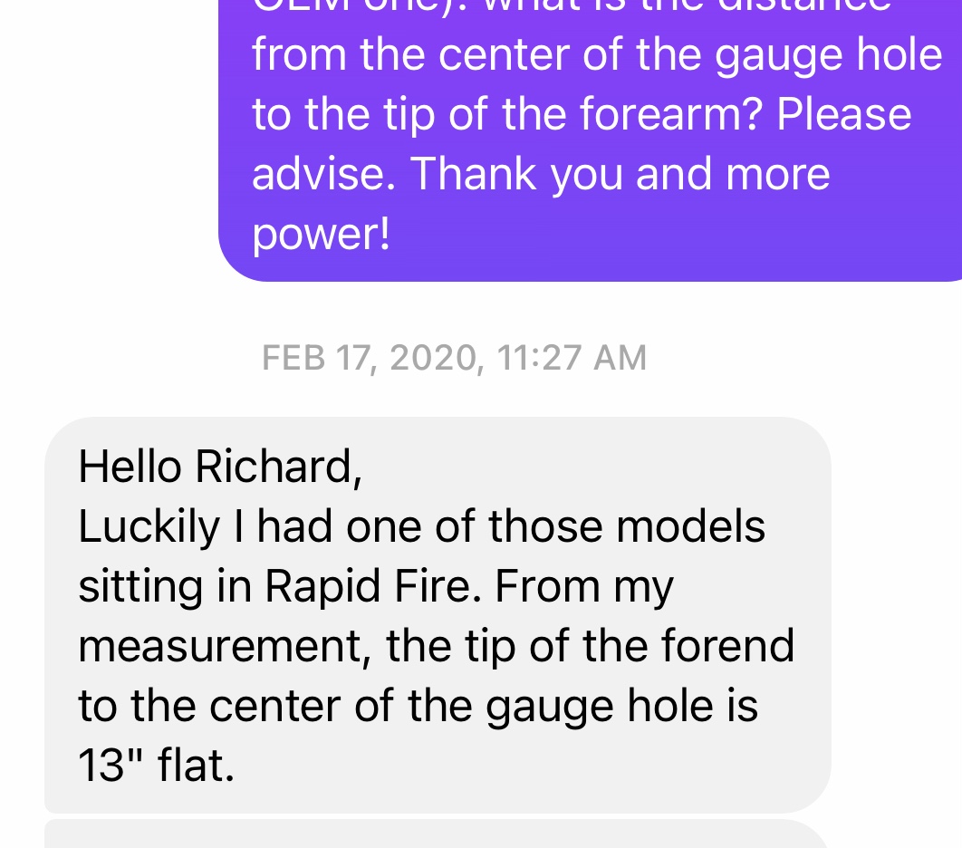

I was actually also considering the Benjamin Discovery Boyds thumbhole with all Adjustments for FT. Do you think it could work for the Prod and 1720T if it was shortened to accomodate the shorter air tube?
Yes, that stock would work except for the gauge alignment.
Yes again, you have to cut a couple of inches.
I’ll get back and check the measurements Boyd’s gave me.

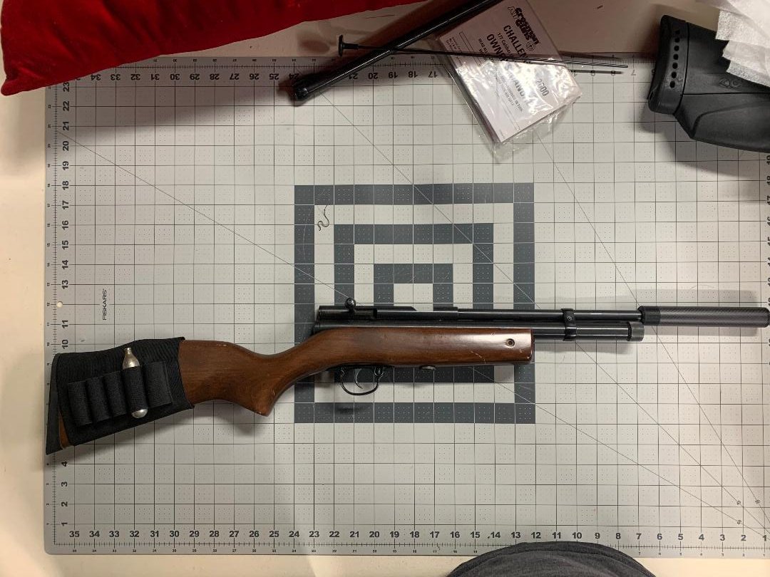

If you put a Prod/1720T on a QB79 stock, you would not regret it. It will become one of your favorite carbine shooters. If I didnt put my Prod into a Bullpup, I would have gone with the QB79 stock for it. It would have been one sweet hunting carbine. It would also be awesome in a QB thumbhole stock too.. I took a QB78 and put the action in a QB 79 stock and cut the barrel, it is a fun 35" co2 rifle for plinking and perfect for young shooters. Still refining the rifle but just holding it makes me want to put a prod action in it.
If you put a Prod/1720T on a QB79 stock, you would not regret it. It will become one of your favorite carbine shooters. If I didnt put my Prod into a Bullpup, I would have gone with the QB79 stock for it. It would have been one sweet hunting carbine. It would also be awesome in a QB thumbhole stock too.. I took a QB78 and put the action in a QB 79 stock and cut the barrel, it is a fun 35" co2 rifle for plinking and perfect for young shooters. Still refining the rifle but just holding it makes me want to put a prod action in it. View attachment 323574
Agreed 100% on the QB/Prod combo. for some reason I really like the way QB stocks handle and their simplicity.
Some day I hope to finish this one. it is still in a rather crude state of shoehorning....

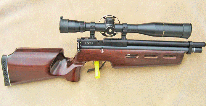

"the front furniture looks bulky to me , is that necessary or could you trim to a slimmer look ? thanks Stan".
It was bulky by design Stan; to add as much weight as possible for better stability from a bipod. Not necessary at all, but functional for field target competition. I could have trimmed it to a slimmer look when I owned that 1720T, had I wanted to reduce the gun's functionality; but can't now.
This is more like I'd have made that 1720T fore-end, had aesthetics been my priority-
Better?
