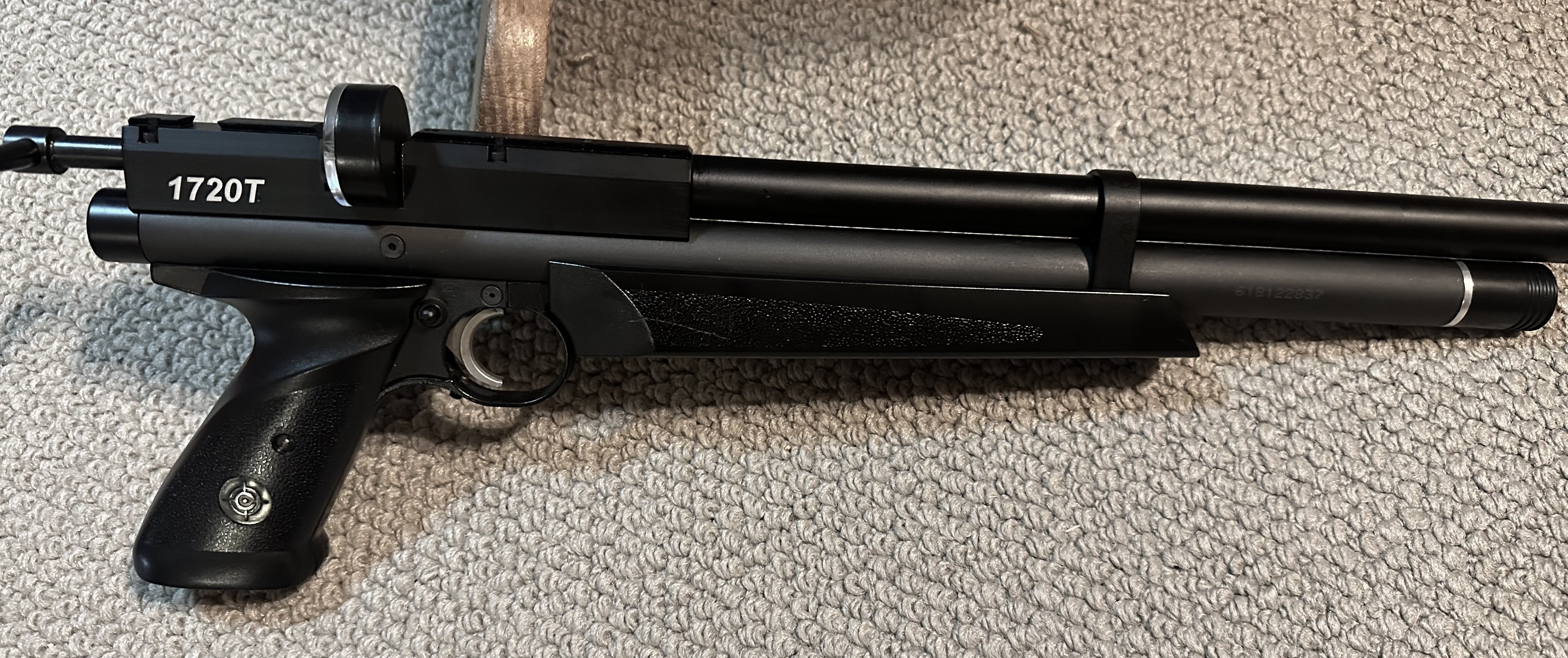

1720T thread!

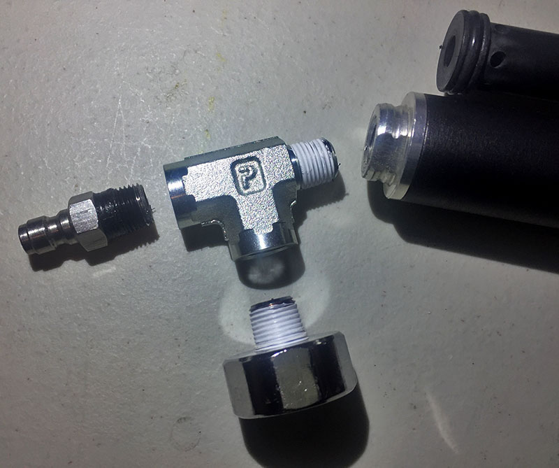

You don't have to give up your tank gauge :)

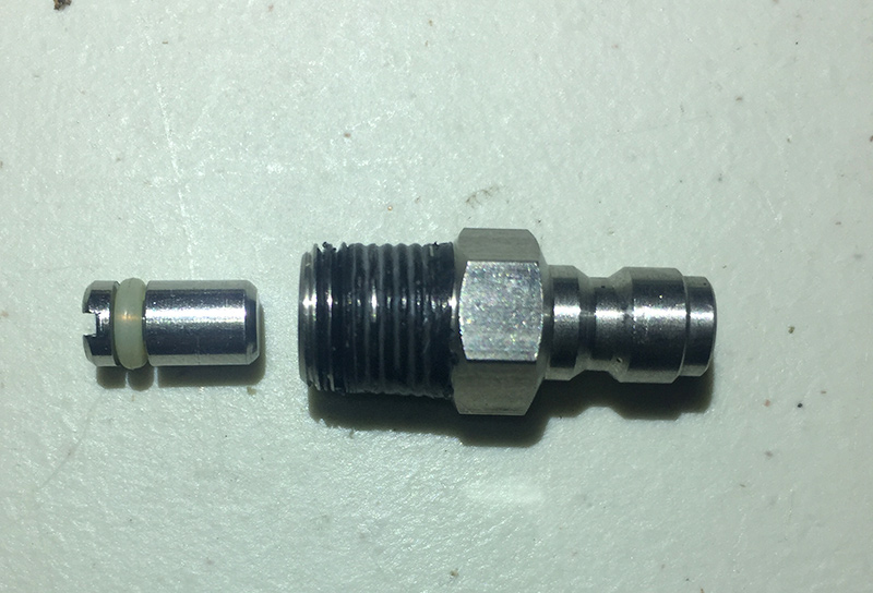

You'll need to remove the OEM fill nipple and replace it with a right angle tee adapter. I use this one from Mcmaster:
Assemble like this (You'll reuse the gauge you removed for your Huma:
You'll also want to replace the OEM fill nipple with one that has a self contained check valve. This is the OEM:
You' want one like at the below link as there is no longer a back stop for the OEM check valve when using the tee adapter:
(I also found some cheaper ones one ebay)
It sucks not being able to monitor the PSI in the tube. This is great solution that has worked perfect for me.
Wow! Thank you so much. Simple, sensible all of it. Appreciate it!

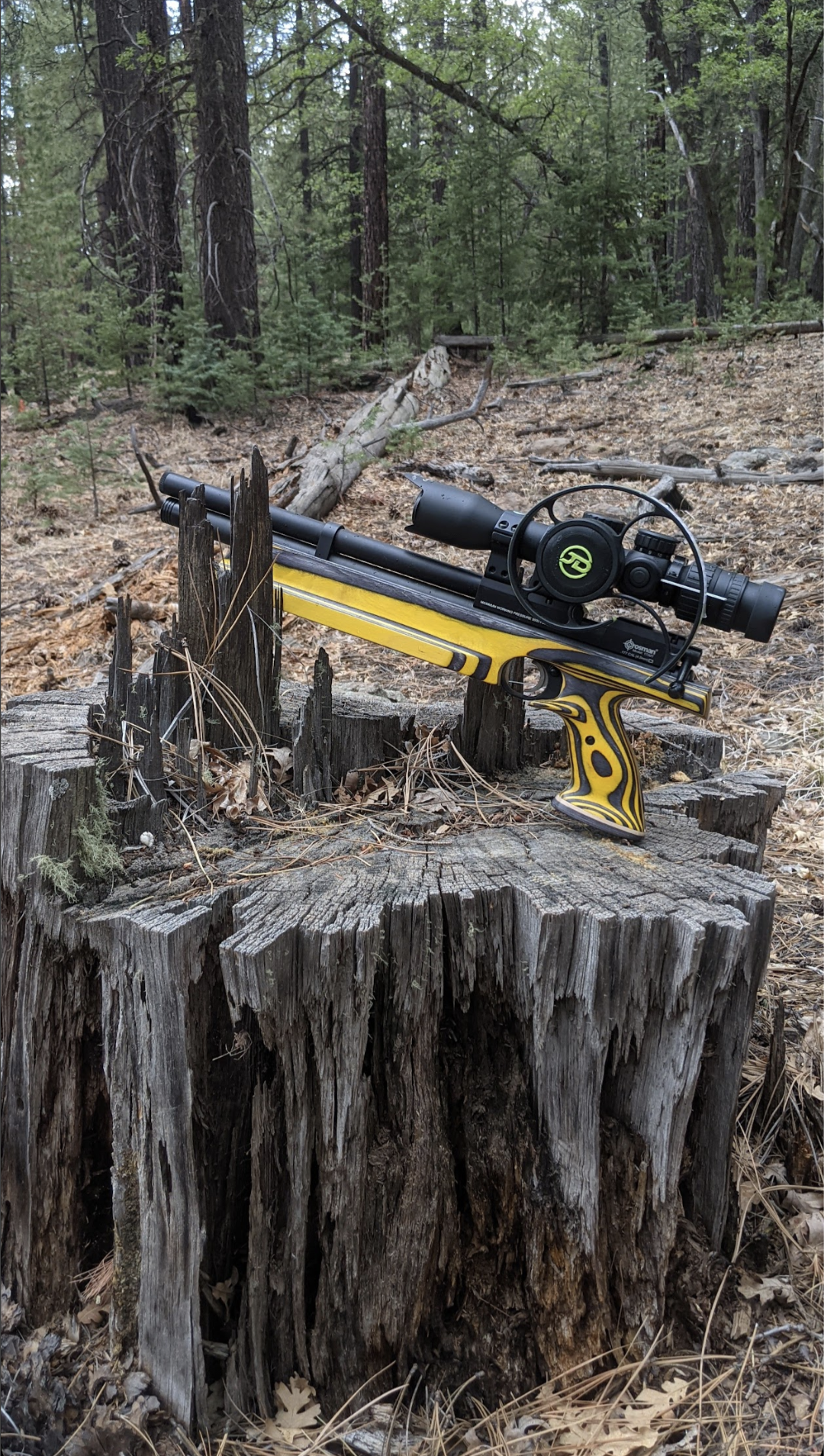

When the fever hits, it can be bad. I love my 1701 and 1720, I couldn’t not have the 2220 Prod, right?
A used one showed here yesterday. Nothin fancy, but last touched by Motörhead.
Runs a little over 19fpe with FTT 14.66 for about 16 shots. It came with a TKO, it is as quiet as my 1720, but I can’t hear anyway.
In my world this is big medicine in a small package.
The bunnies were out again this morning taunting me and the Buckdog.
I can assure they will not be eating my garden this year.

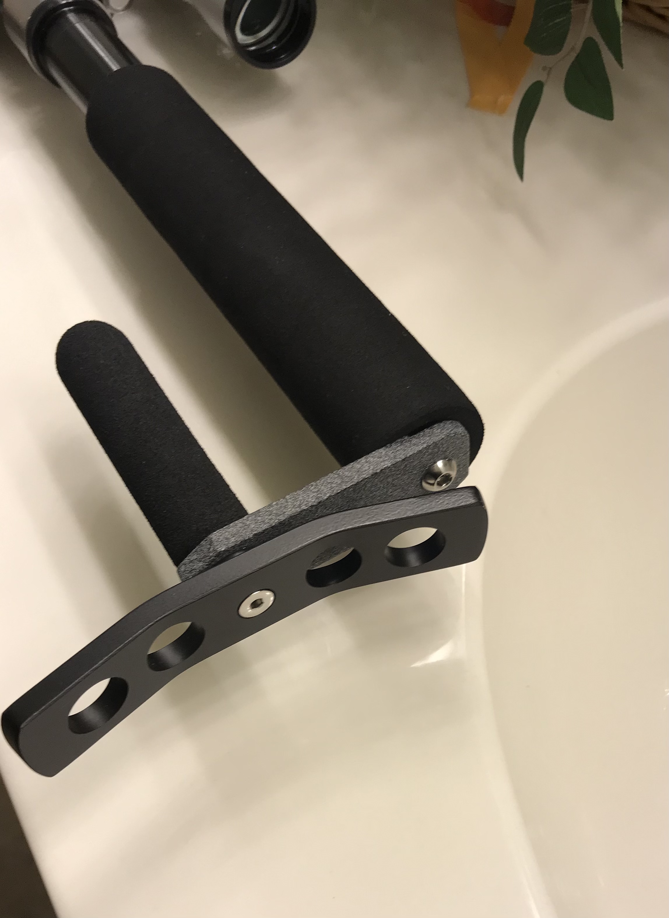

Nice! I've got a Wokbutt on mine as well -- big improvement over the basic aluminum bar I had originally from TKO.
They’re too expensive (more than $80 shipped) for what they are though, Larcat sir.
Mine was brand new, too, and unused from a GTA member for half the price.

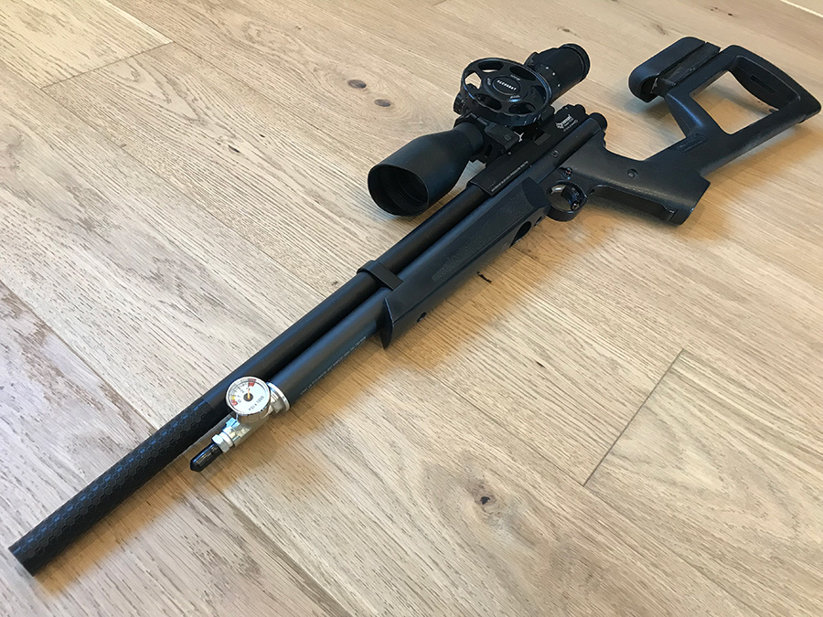

First mod complete.. Took about an hour total, mostly getting the nerve to take the first cut. :) Breaking in my new hobby milling machine.
Next will be some sort of stock to turn it into a carbine. I already have an RAI AR style stock and I like the minimalist look , but I am thinking a nice wood stock for something different.
