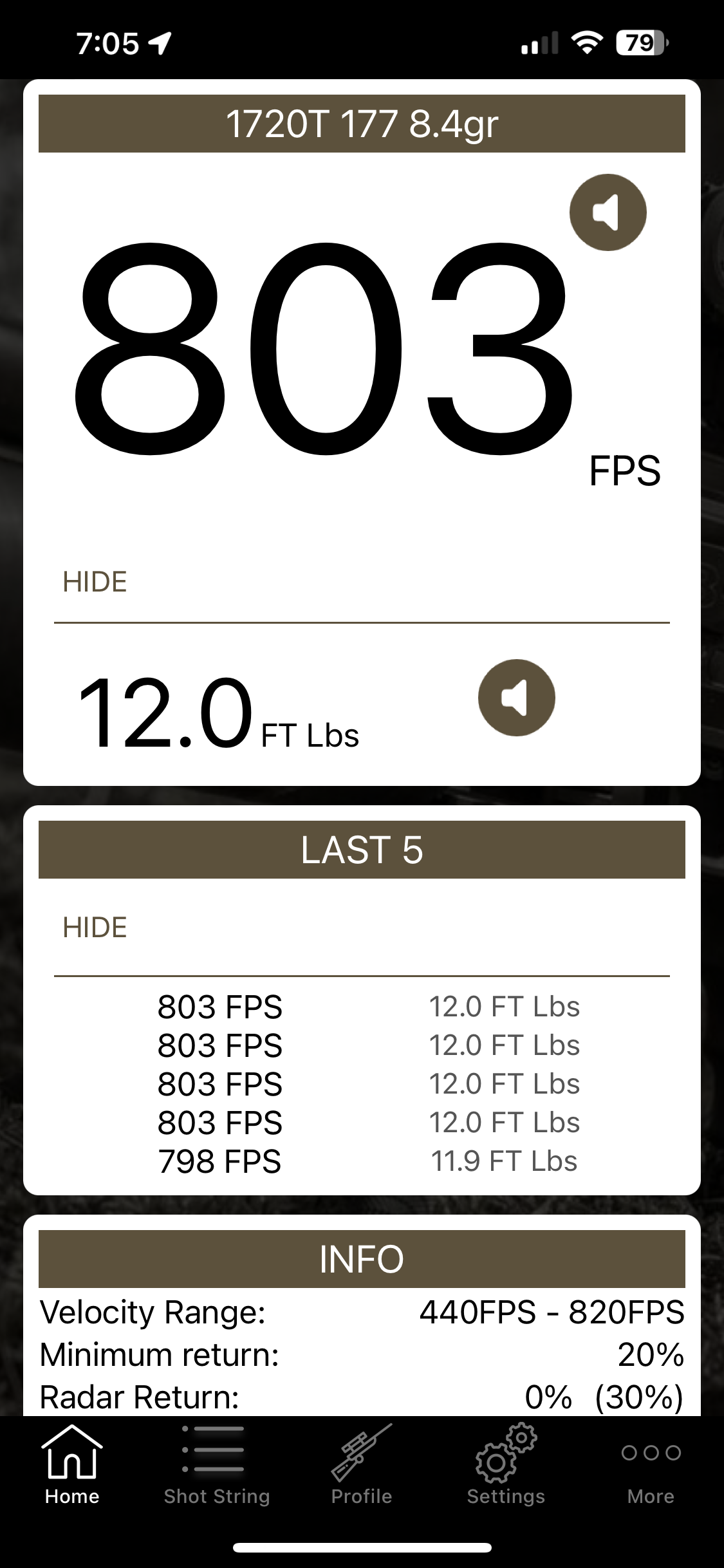

So just acquired a 1720T. Trying to tune it. Have 3 orings in for the bstanley mod. Heres the best i can get so far. Everything is stock. Seem reasonable? 8.4gr pellets.

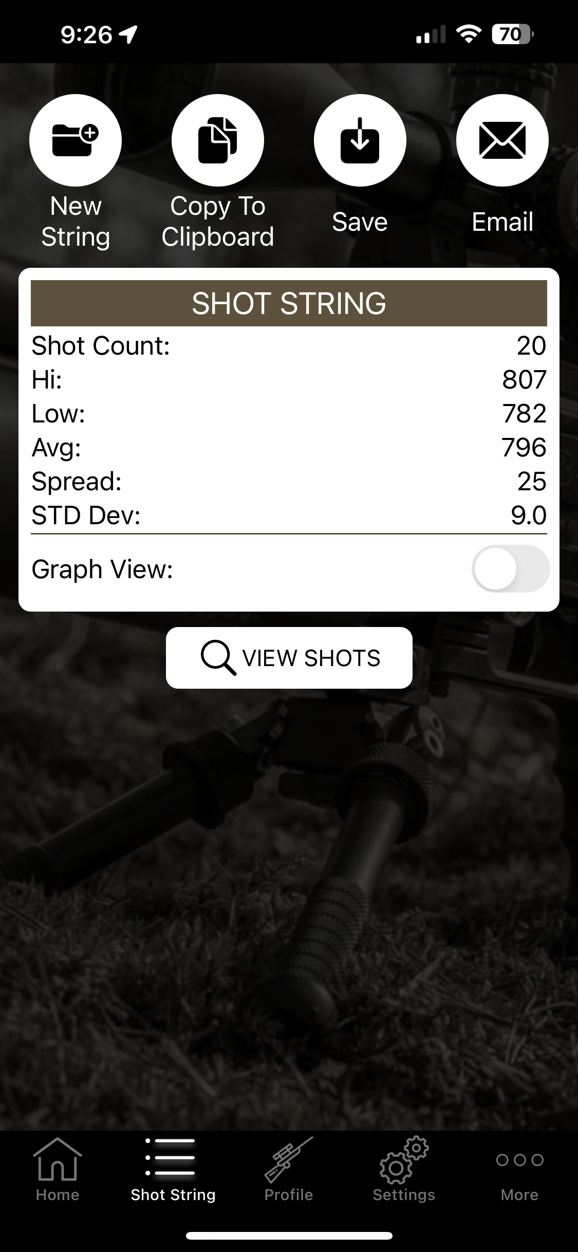

We need to see a shot string containing more than five shots - is that the velocity peek of your shot string? Or according to you velocity range, a 400 fps spread?
The string shows 20 shots with a 25 fps spread. 20 is the most i can get. Tighten up to about 10+ fps and its about 14-16 shots.
