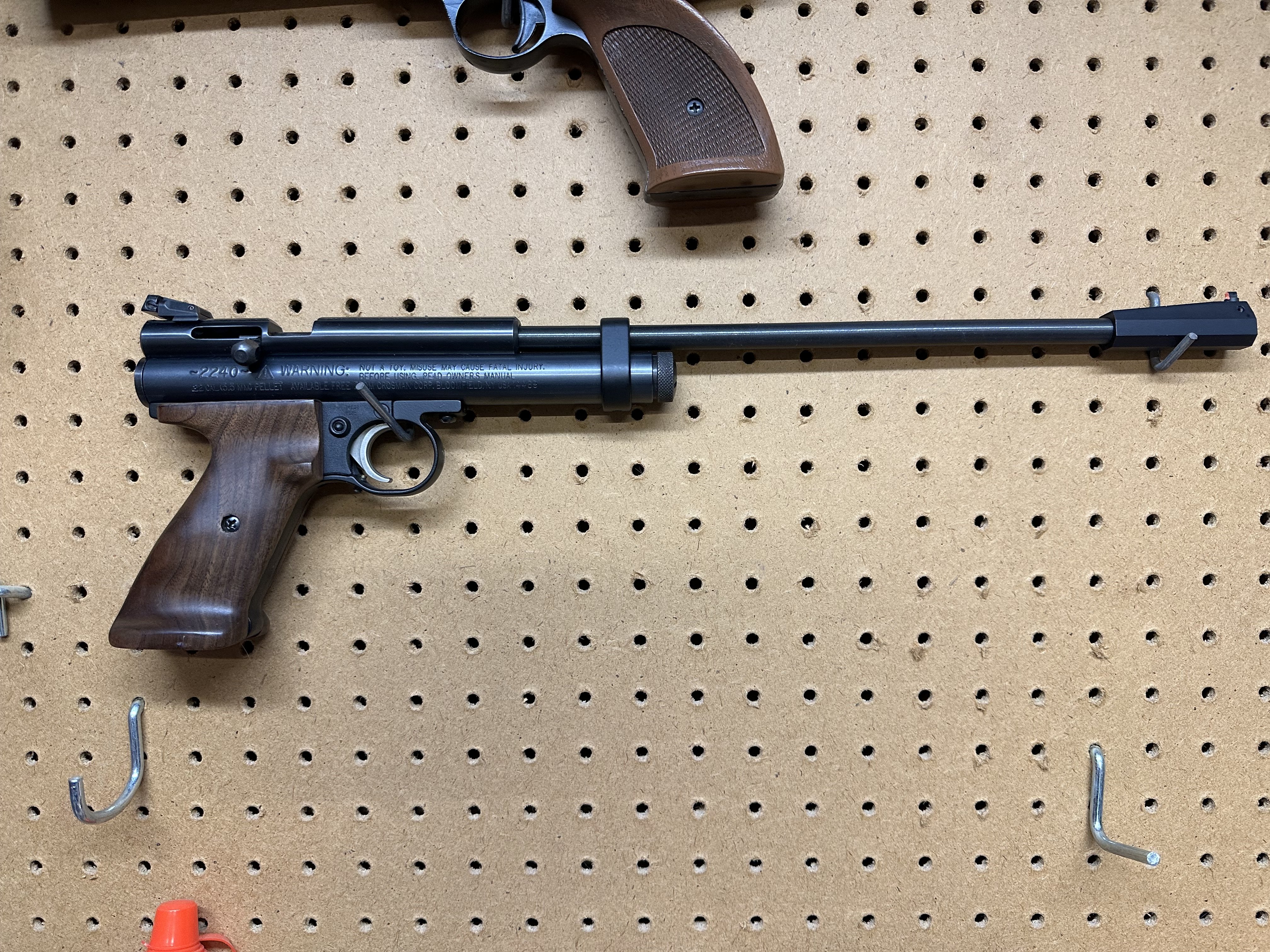

Back in October I purchased my second pcp, a 1701P.
I am very impressed with this pistol and added some VA walnut grips. I did spend some time shooting it as a carbine and found it to be very accurate.

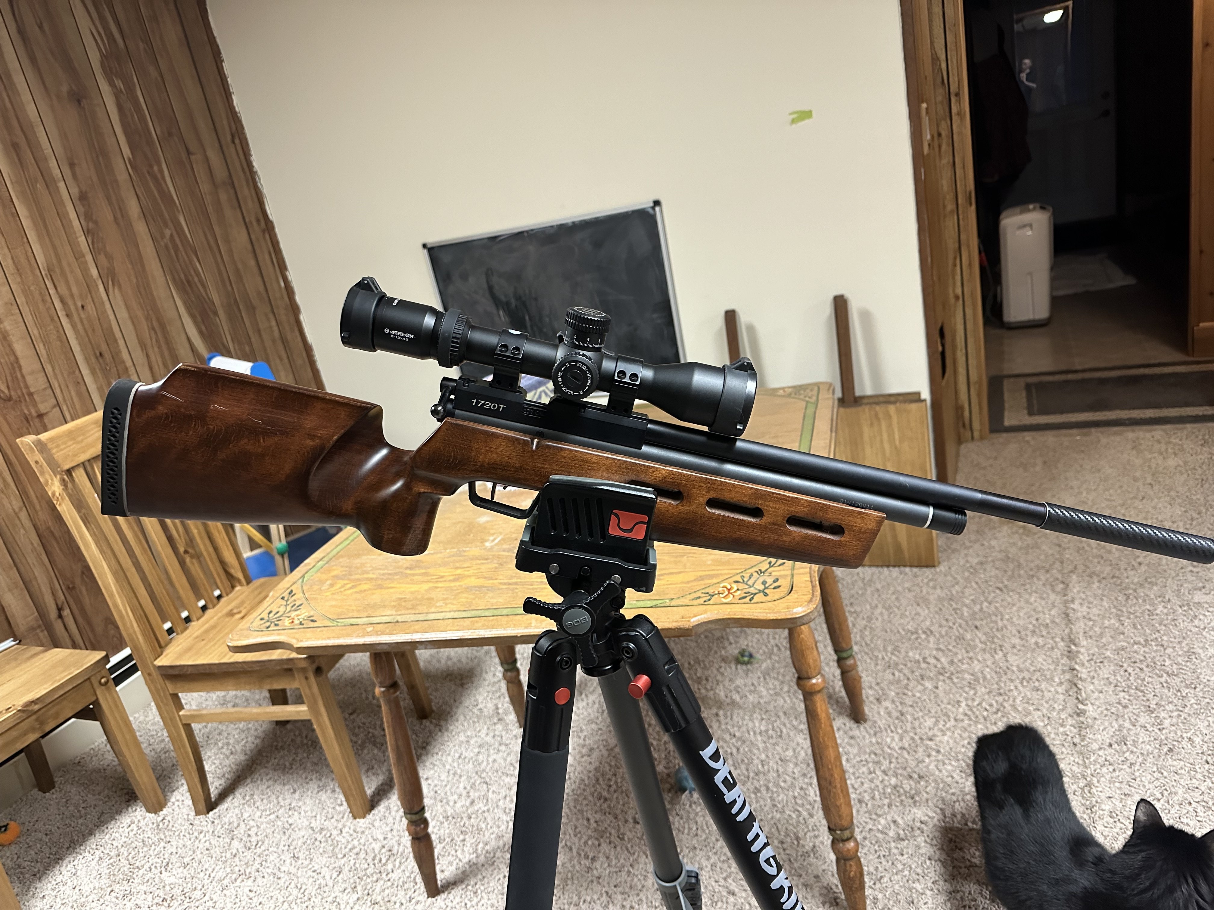

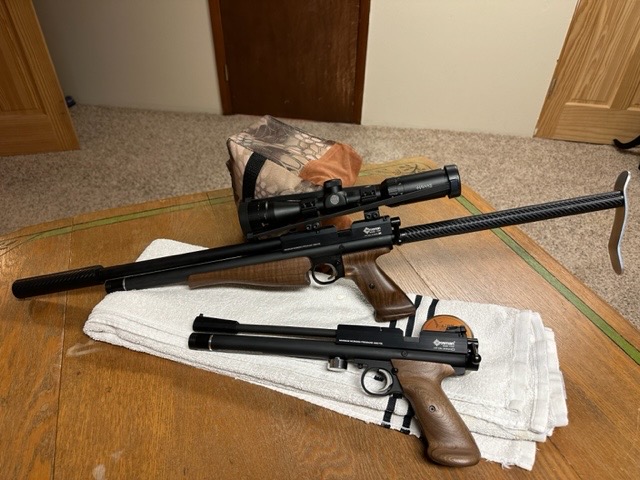

I needed something portable, light, small in the 10-15fpe range. Enter the 1720T.
I bought this one from lwm211 in the classifieds. Also the TKO stock and Steve Corcoran walnut.
I should have bought one of these years ago. Stunningly accurate, only limited by me.
7.87 @800fps. I will order some spare transfer ports and experiment as time goes on. But for now, just shoot!
Nice pistol and carbine. I'm considering placing an order for some grips. Can the wood forearm on the 1720T be used on the 1701P?
No, the gauge placement is different.
The 1701P's closer to the trigger guard by a few millimeters.
You can if you are willing to swap tubes. Yes, they are compatible.
Actually yes the fore arm fits on the 1701 with drilling another hole in the little metal tab that is used on the prod and 1720.
This one fits tight and ther is nothing holding it on. So now the 1701 looks exactly like the 1720 did in my original post.
My 1720 has been living in an old 140 stock. Today I put it in an AR2078 stock. Tuned to 10fpe with Supermags. Big medicine for chippy.
Your 1720 looks awesome in that AR2078 stock. That was a really cool idea.
