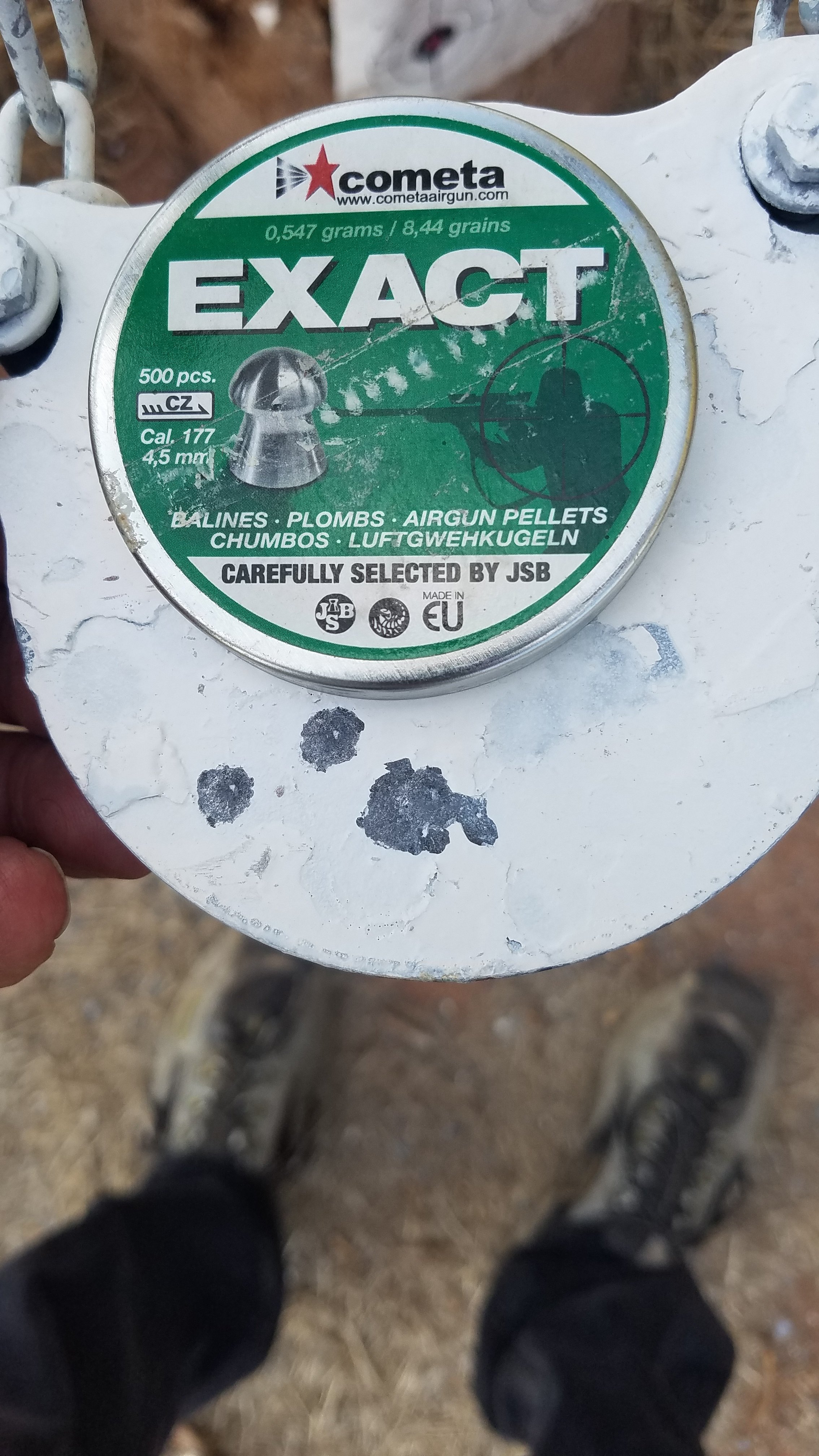

I was working on a Steyr LG100 a while back... just 12 ft lb and it shot SO incredible in the mild conditions that day that I decided to throw a few at 100.
The first 3 are stacked on the right and I could barely feel a change so held a little for the 4th but not enough, and just a tiny bit more change on the 5th so I was holding about 2 inches on it but blew it further. Notice the vertical
. This was 8.4s at 800...
Soo... the little 177s can shoot 100 yds... yes... but can they compete w the big boys?... probably not at that range... Still a hoot though...
