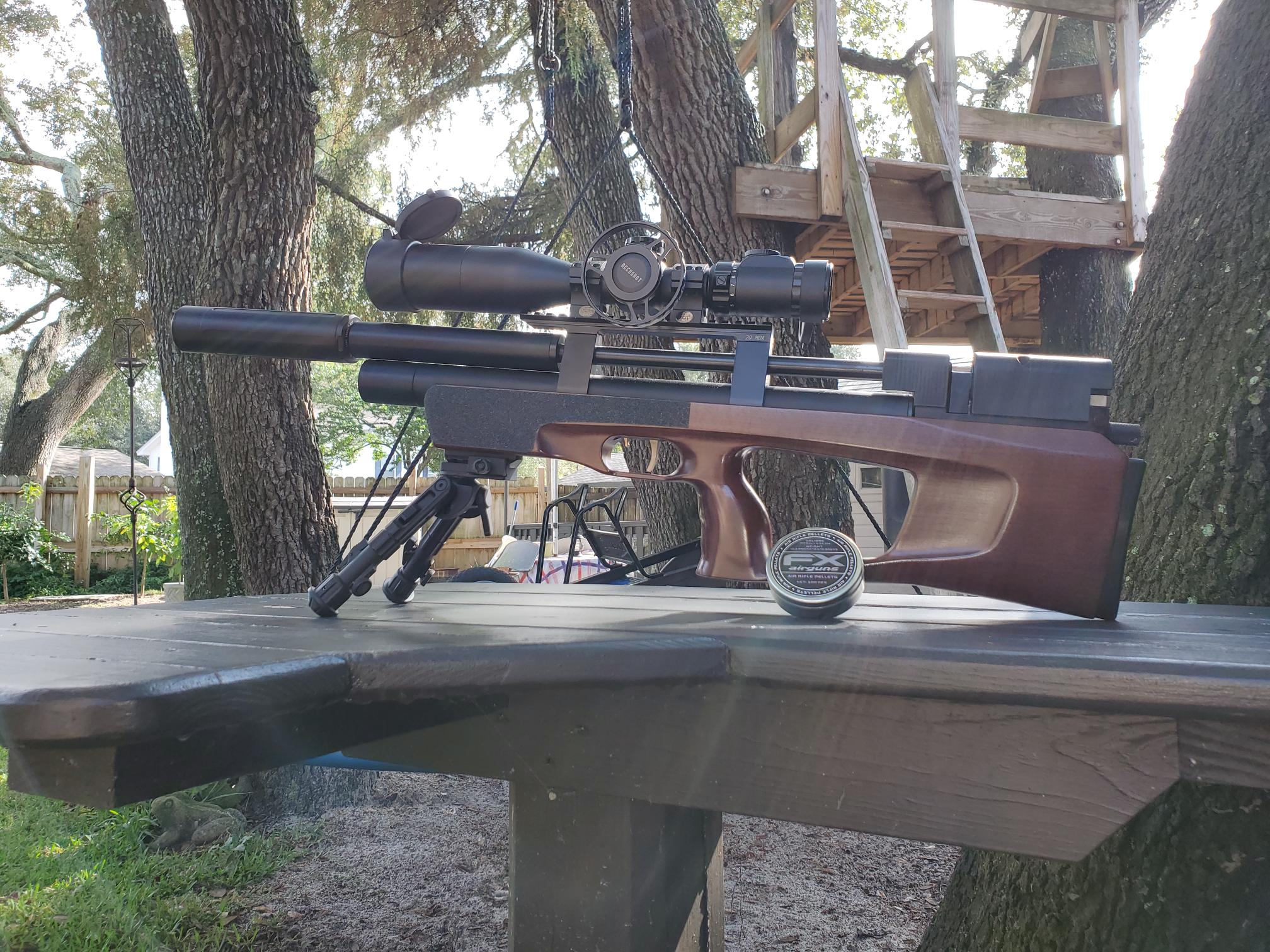

Taipan .177 backyard friendly Tiapan set up
I setup a .177 compact for the backyard.
Tuned down to 850 fps with a sumo moderator.
10.3 fx pellets
Laser accurate and the pellet hitting paper is the loudest thing.
I love shooting this setup
UTG Op3 4-16 x 44

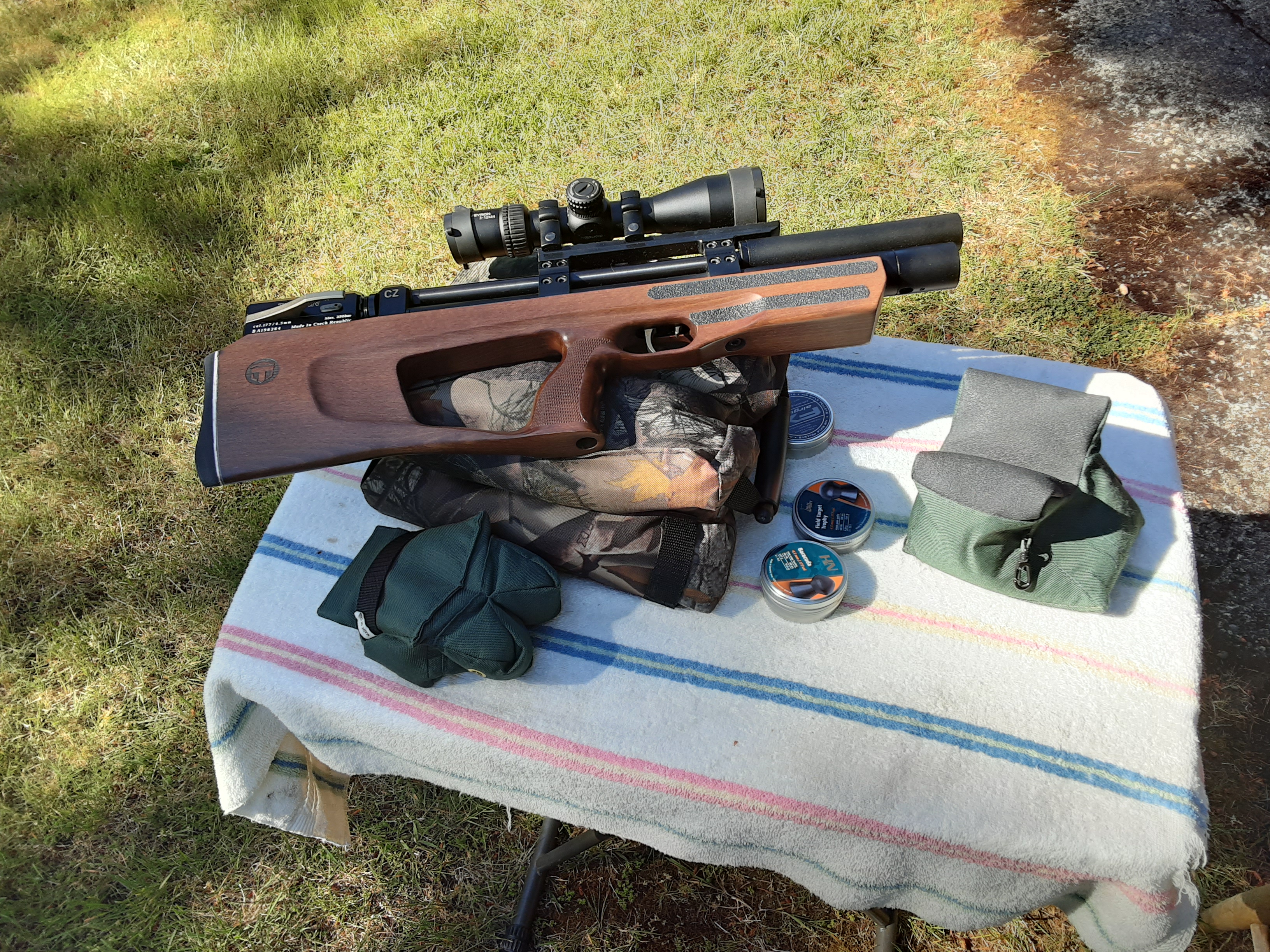

The Veteran makes a great low power .177.
The original Veterans were offered in .177 as a factory option. I've seen a few of the .177 Shorts, but it seems like many more .177 Standards were made. The Vet Short is about a 24" gun, and the Standard is around 28" long.
My .177 was originally a .22 but was converted to .177 by using a .177 CZ barrel from the CZ200 series guns. The Taipan OEM reg that was in the gun was not very consistent in the conversion so my .177 Vet has a HUMA regulator in it. My frankenVet also has a custom smaller transfer port, single hole and appropriate for .177. This was b/c the large dual transfer port from the .22 was also creating consistency problems. So I certainly went about getting a .177 Veteran the hard way, but it was worth it as it is extremely accurate. Reg pressure is 90bar. Shoots the 10.34s just shy of 20fpe. I'd estimate the shot count is up around 140-160shots per fill. And it is VERY quiet.
