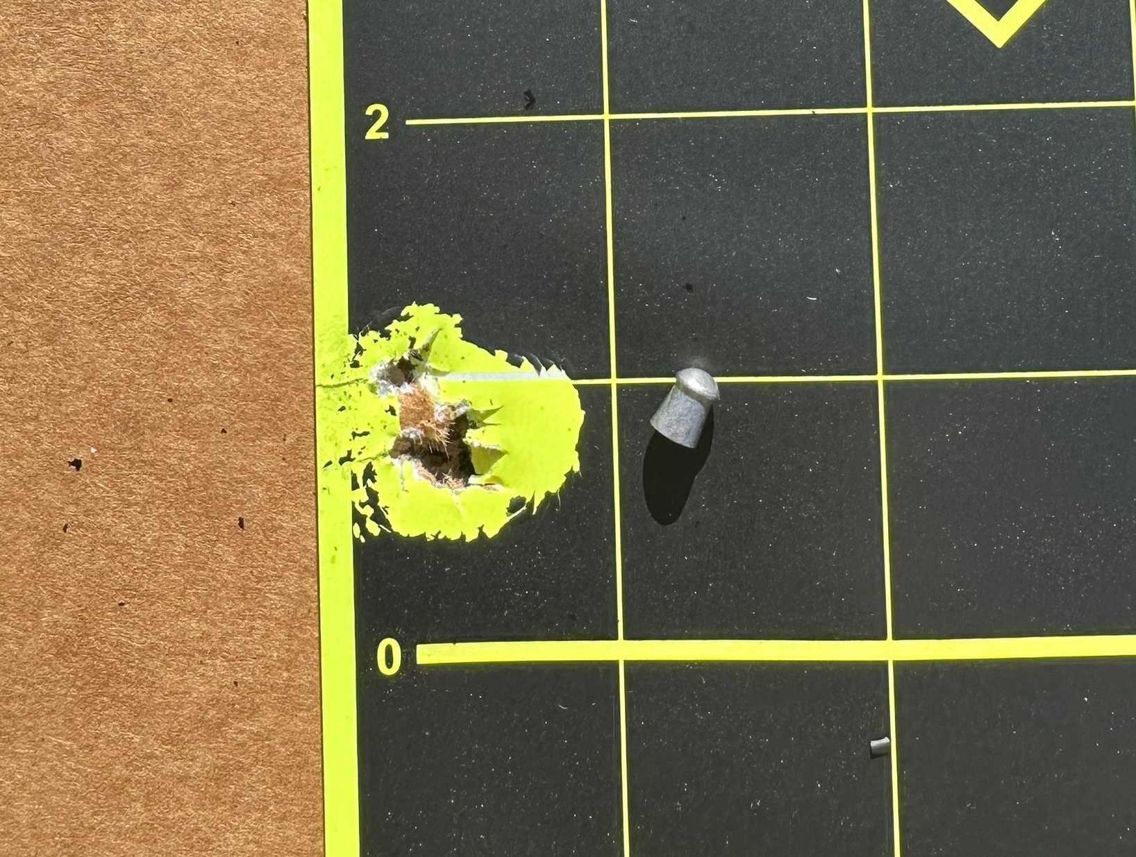

Airforce .177 Condor Slugger *FAIL*

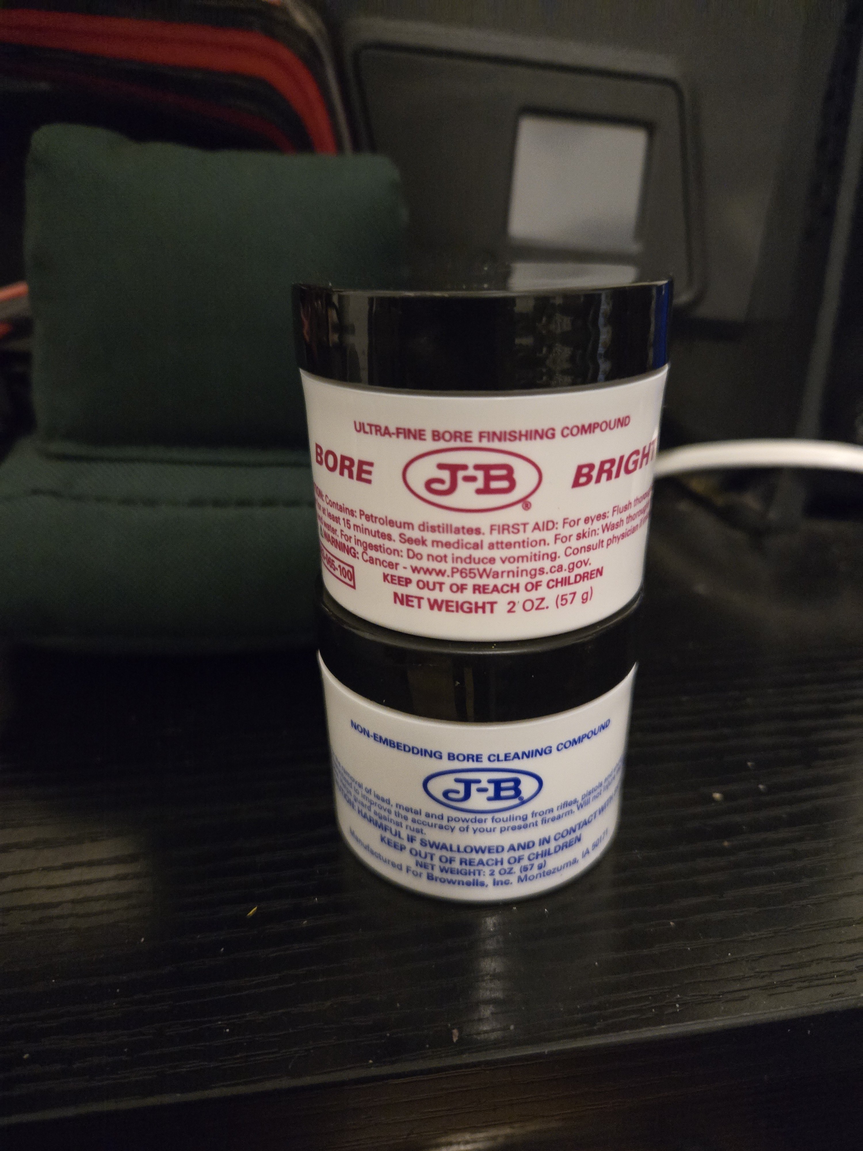

Rob, J&b is your friend. Use the red first and give the choke area a really good work out. Clean really well and hit with blue. Repeat choke area. You should pick up 30-50 fps and groups should tighten up. A lite lube on slugs will help. I use synthetic shock oil.
I'd tried JB bore paste back in the day and have some around.... I had put a WTB ad and a few folks have responded so I should have some to try out, but failing the others, I will give this a go, thanks!

Will keep testing, but yes sir... this is the 24 inch choked barrel. I knew it was a long shot, but more testing to be done... and I didnt realize that JSB makes a heavier pellet than the 13.4gr so will try those as well!
LOL, I have some of that too, so will send it your way

I was able to get a .20 Condor to like NSA slugs, primarily by loosening the choke with some Clover lapping compound and a one piece rod. But a light touching up of the crown sure didn't hurt either.
Even with the barrel in peak slug status (to the best of my abilities) the slugs started out and of course continued to fit loose in the "leade." They shot well anyway, just had to make sure to keep the gun level between loading and firing, lol.
Lots of general use airguns that I've had come through seem to have these same barrel specs of a really tight choke in a 12 land and groove Lothar barrel. I've found in a couple small bore barrels now that slugs and chokes arent completely incompatible, but agree with each other much more if the choke isn't crazy tight.
Another part of the recipe I've found for small bore slug success is lubing them up with Gunzilla, pretty liberally.

Was sharing to encourage you to try to get your .177 barrel to like slugs. It may have come out of the box not living slugs, but that doesn't mean it can't be coaxed into shooting them well.
I focused my lapping compound on the really tight choke, but also spent some time focusing on the tight spot right where the barrel diameter goes to the full 16mm. I imagine yours has the same two constrictions.

Definitely was encouraging, thanks... and seeing the results was a bonus. As per Motorheads recommendation, I'll get a .17HMR rod so I can feel where the restrictions are better. I still have some others to test and if they do well, I've found what I need, but barring that, I'll give this a go
