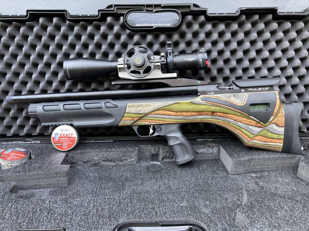

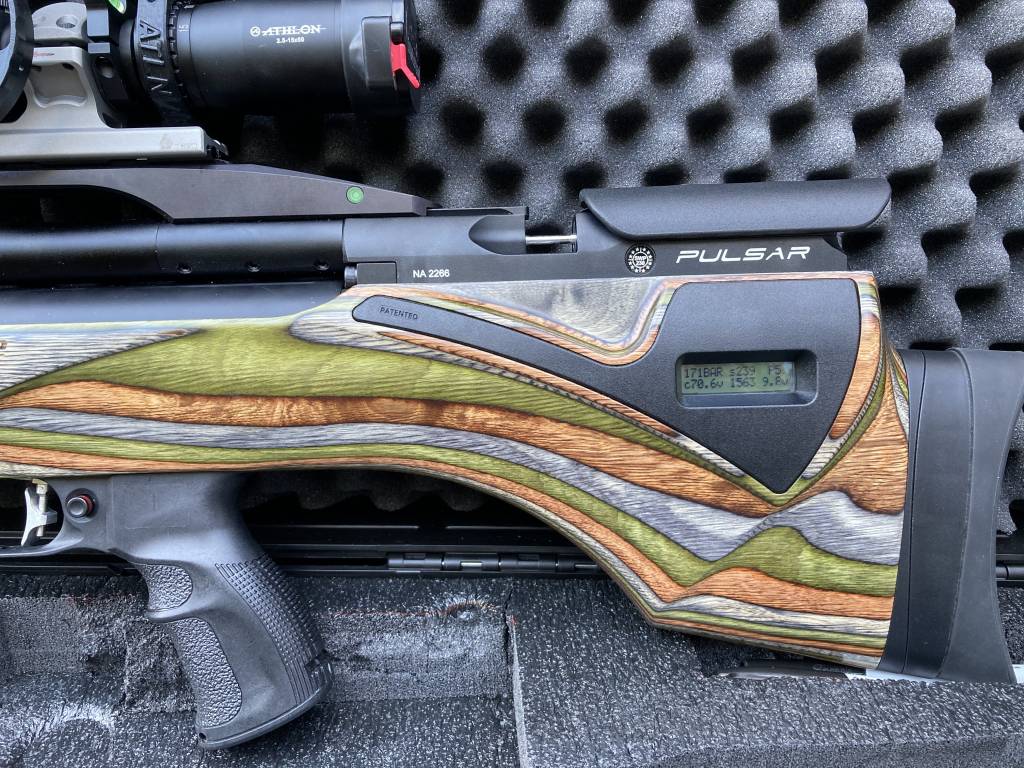

Finished tuning my .177 DS Pulsar with HeliBoard yesterday. Tuned to shoot 13.4 grain JSB RD Monsters at 815 FPS which is just under 20 FPE. I bought this gun on sale at AoA for shooting Field Target in 2021 Hunter Class.
The results are amazing. For a 90 shot string from 250 to 160 bar, my muzzle velocity was 811 to 819 FPS for an ES of 8 FPS. That’s with pellets straight from the tin. I’m done tuning, it just doesn’t get much better than that.

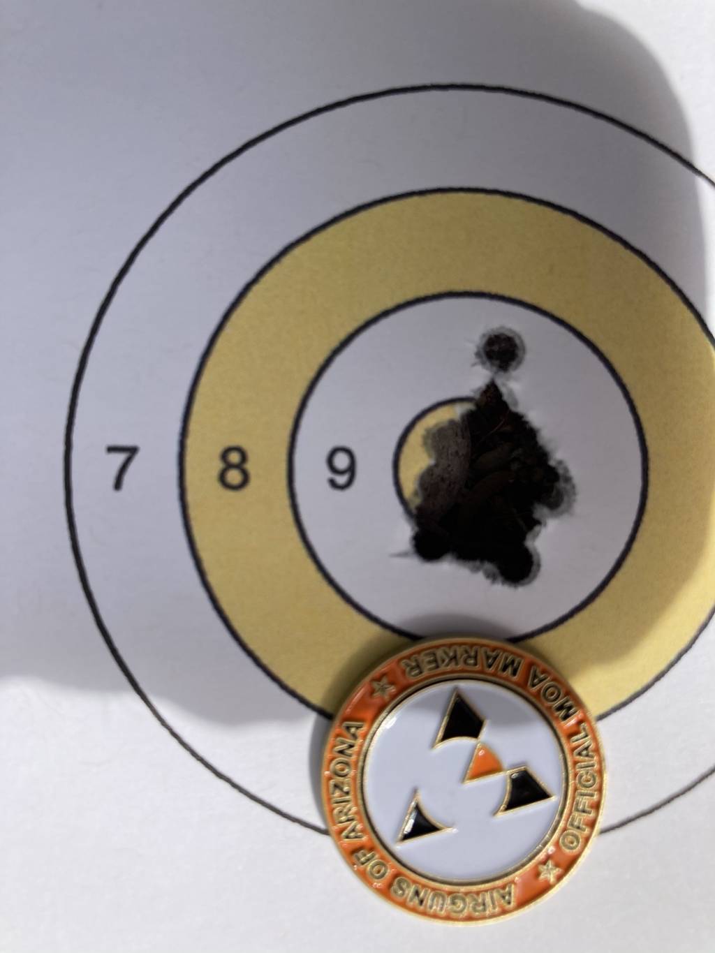

Two magazines, 28 shots at 50 yards in 10 mph wind from my 10:30 in prone position with bipod.

Yes, it took much time and many hundred of pellets to get it that way, especially since the setpoints on either side of the selected setpoint (out of 20) cross affect each other to an extent. Its best to do it while shooting as you increase the pressure each ten bar or so to each setpoint. The gun won't shoot that much FPE consistently at under about 155 bar. I currently have it on level 5, but the voltage is raised from 69 to 70.5 volts. The gun will shoot accurately the JSB 10.3s at about 910 FPS, but they are much more susceptible to the wind than the 13.4 RD Monsters. There is a SIGNIFICANT difference at 55 yards.

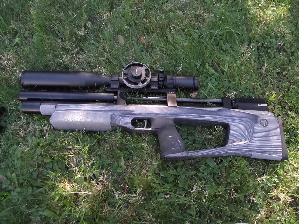

I was ... last BIG Hurrah for 2020 I went back to my tried and trusted TM-1000 that simply has been my never failing me Champion gun over the last 5 years.
In OREGON with the JSAR
few years ago in PRETZEL position with the TM
