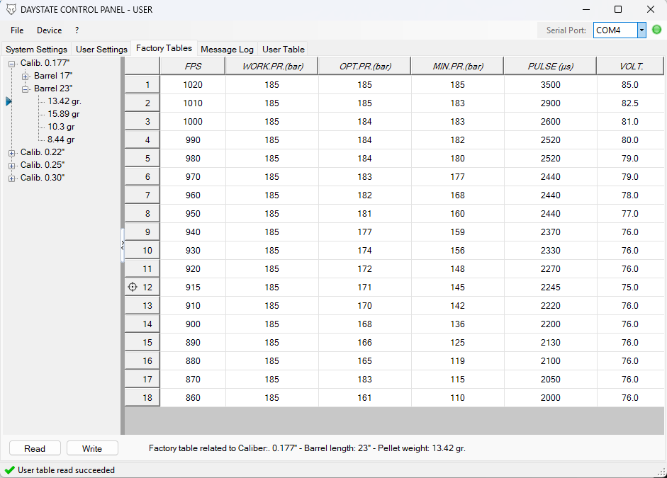

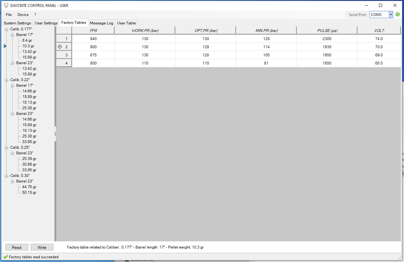

I didn’t have much luck with the .177 HP barrel that I had but that was 1 1/2 years ago. .22 was OK but not as good as Red Wolf HP. .25 and .30 are the way to go.ahh great example. Ok will try this. Thanks again. Also my gun is really acting up lately might have to send it to AOA. In .177 I cant get the rifle to shoot faster than 760 fps no matter my settings and reg pressure. I use to get 990 fps with my 13 grain ko. Now nothing is making it happen. I might try switching the barrel to a .22 to see if things wake up. Just did a latest firmware patch this was after the issue of the slow FPS just to try to reset everything back to a fresh setting. Will see tomorrow I will probably put on the 30 cal barrel or the .22 barrel. The .177 have taken the bottle off started with low bar pressure all the way up to 150 bar and no go it wont push any pellet or slug faster than 750 fps or so. Anyway, thanks again centercut. The red wolf Hps are my most accurate rifles love those .177,.22 rifles they are so simple low/med/high and all accurate as hell.
Once you find the low reg pressure for your setup in Factory mode you can go into the gun software with the tuner and see what settings the gun settled on. Cool
