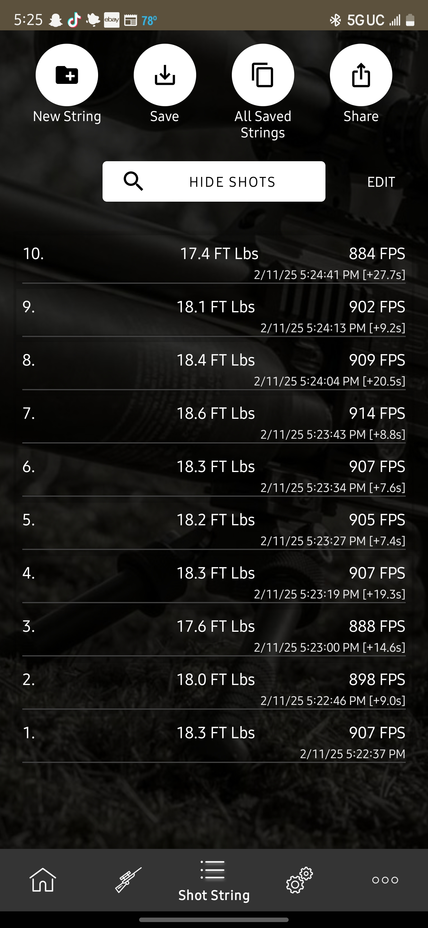

In terms of spread it better be better than this although it's not like the spread is eratic throughout the whole shot string. But 17fps spread was the best I could out of working in the day light.

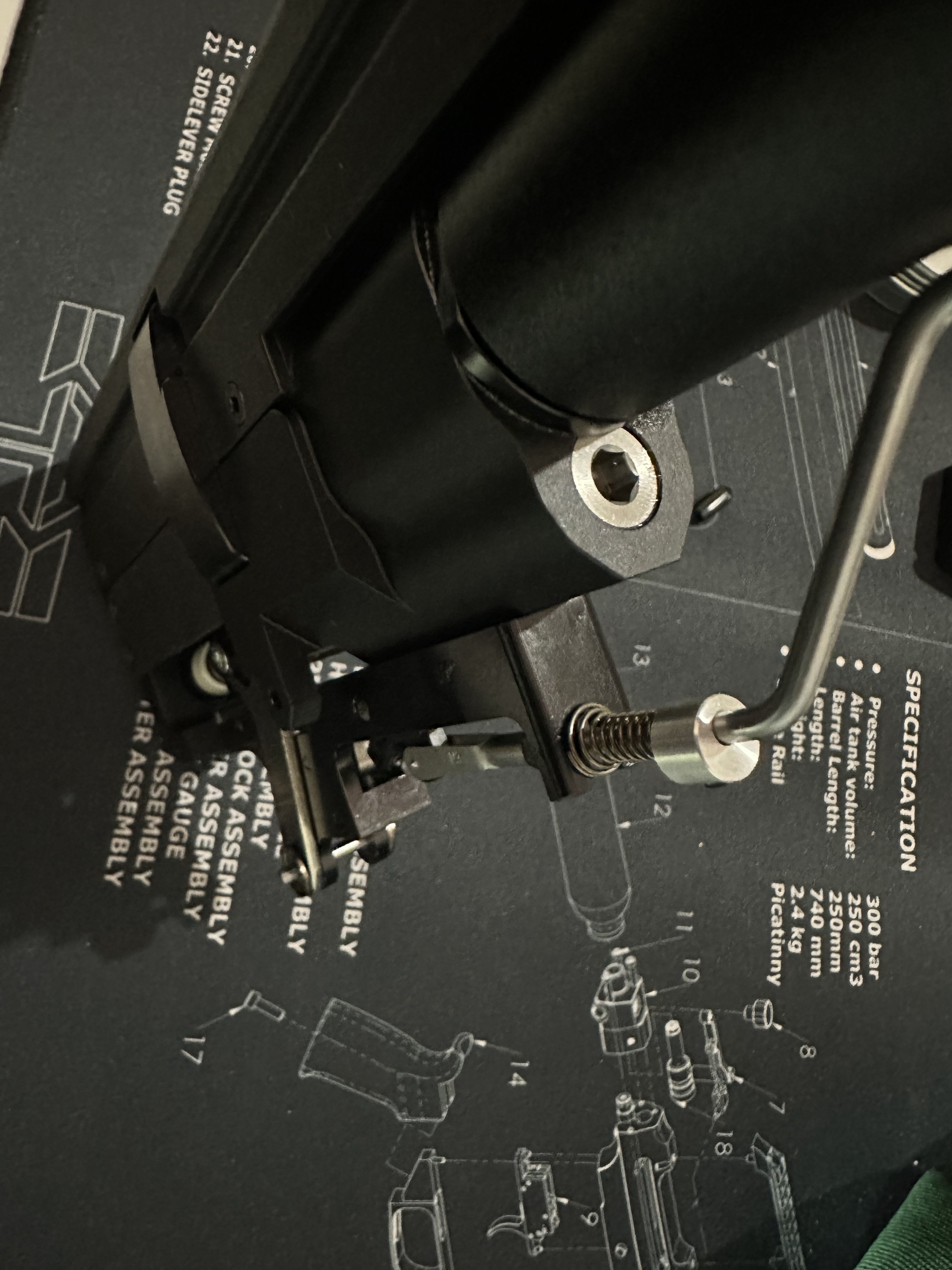

Ok ok, getting there I guess, played with the hammer adjuster and backed it waaaay out. Had to carve the bolster or whatever it is inside the stock to fit back in there with the hammer adjuster far out. Strings getting tighter and tighter though and I finally managed to get the chrony to read the H&N 98% of the time.

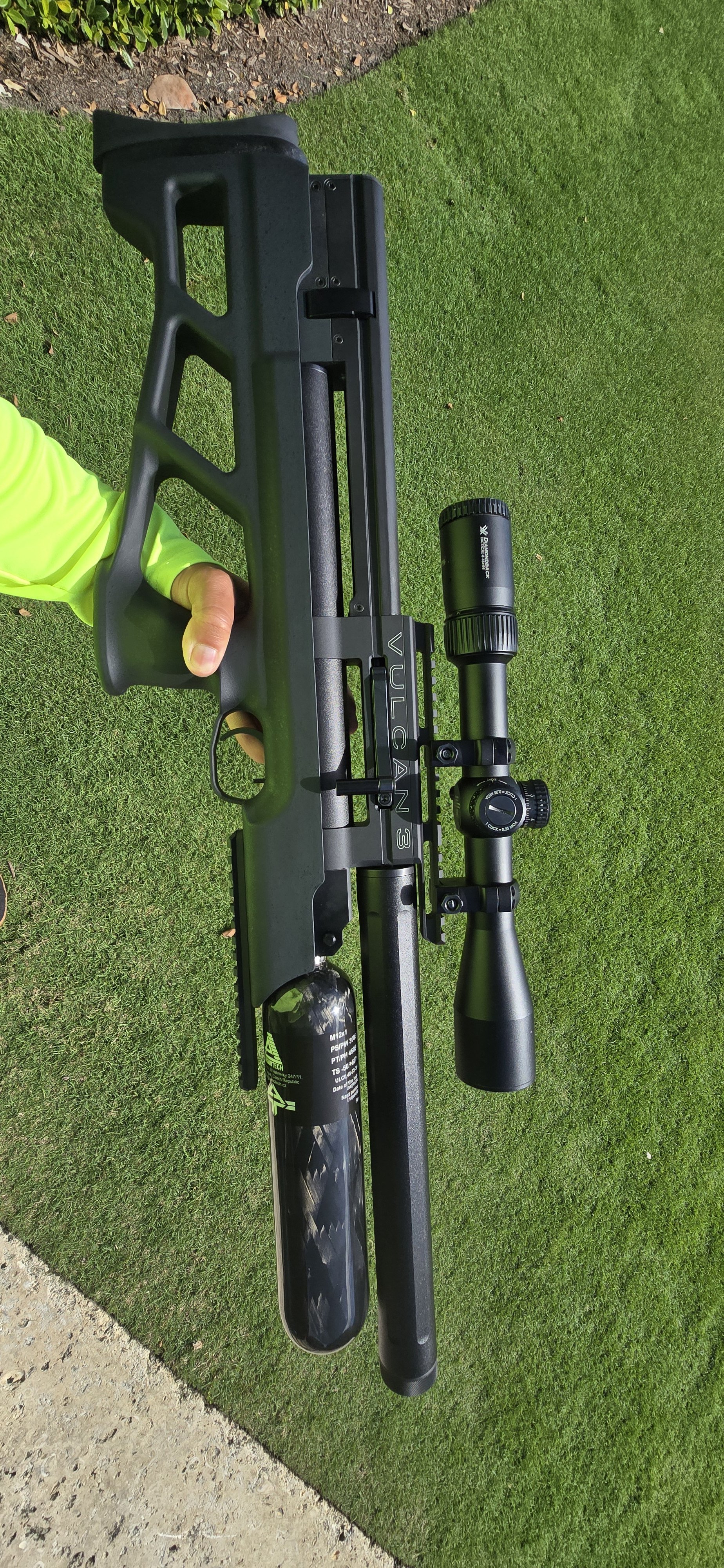

@JaceSpace1369 when you say “adjust the valve”, do you mean playing with this screw (for which I assume that the valve is behind) - see pic?

It's the screw underneath the plenum. Based on the picture you sent that doesn't look right though. It looks like the base of the plenum is interfering with adjusting the valve which was not the case for my U2 700mm.
Damn you had to carve the back out?

Yeah the plenum would be in the way if I would want to adjust the 5mm out beyond flush! But I guess adjusting it in puts more spring on the valve and if anything I want it to close faster?! Pretty sure it’s still waisting air…
Definitely had to carve the weird stuff in the back of the stock! Hammer adjuster is more than halfway out now :)
That's really strange as my U2 700 valve adjuster was not blocked in the slightest 🤔. I believe screwing it in leaves it open for longer, as I had to unscrew mine 3/4 of a turn to tighten up the spread on my U2 700.
Damn, that sounds like a lot of material to carve out.
I'm really wondering how you'd go about adjusting that valve if it's in your way. I wish I would've taken a picture of mine when tuning it before I shipped it out.
Damn. If going out closes faster than I really have to figure… will check tomorrow and see how far I can go out (and what happens).
