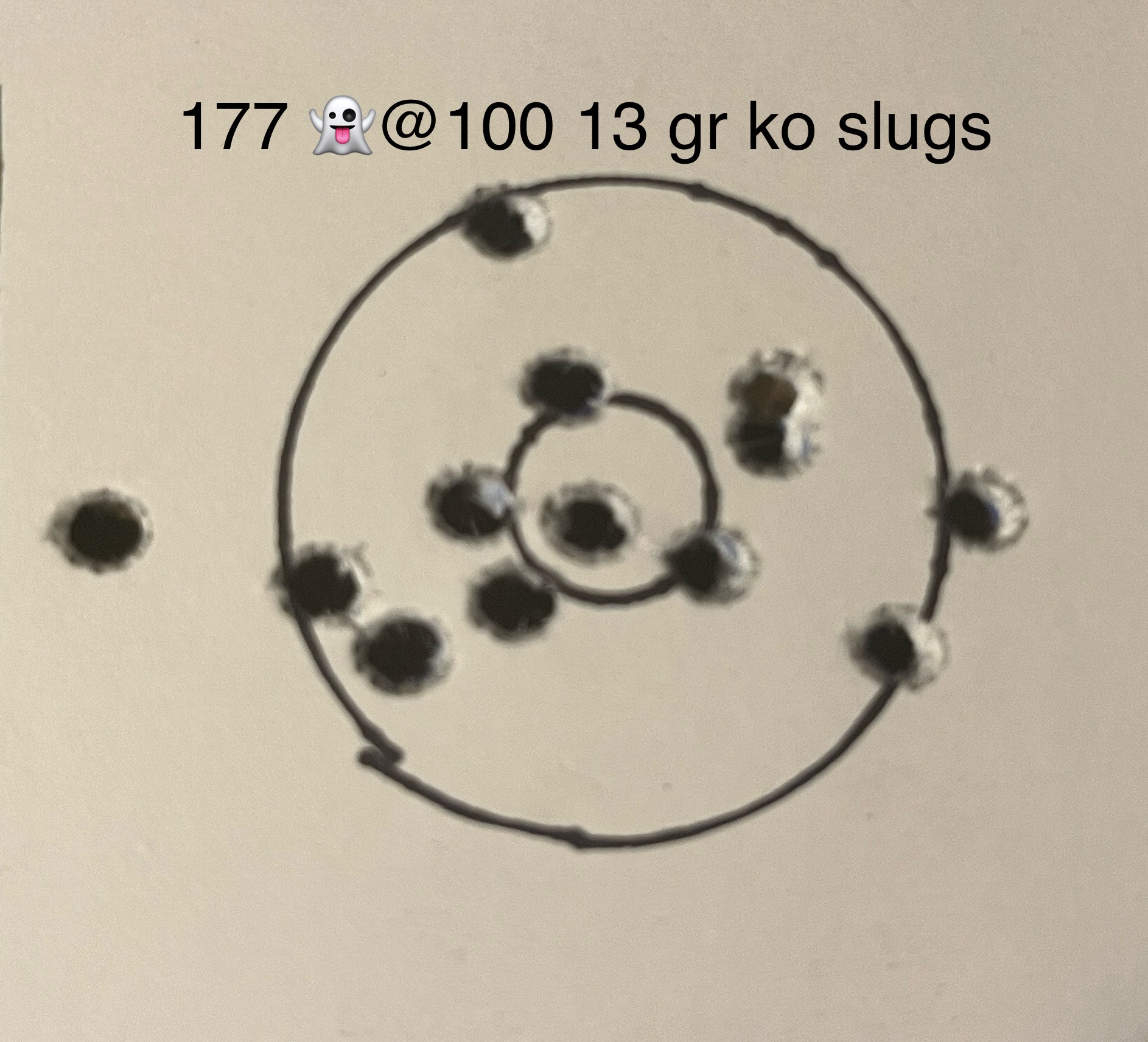

Haven’t read this whole thing but if you have a ghost and want to shoot 177 slugs get a 28” barrel you will love it!

Hahaha thanks, one .177 is enough for me :) got a ghost and it’s one of my favorites, .22 HP and a couple of other barrels, incl a 28 inch in .25 :) if they would ever get the 1:17.7 barrels out I might get one of those as well but seems like they are unobtanium…

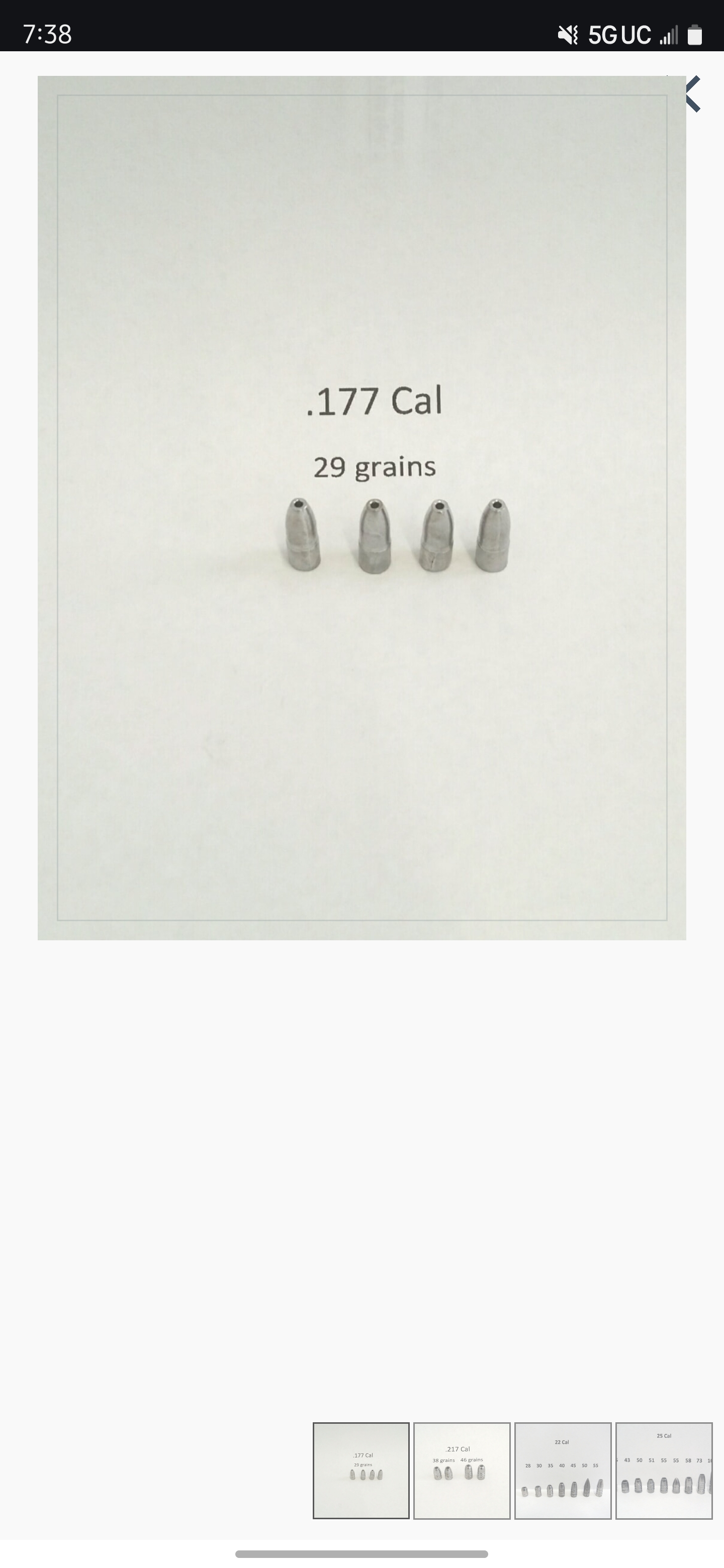

I mean why not? Lol. The mora comes in either 700cc 300b bottle or 1.1L 300b bottle, so plenty of air of anything hahaha. I'd imagine a 50fpe .177 would be way flatter shooting than even a 60fpe .22.
In terms of rimfire I will always choose .172 over .22 but there are clear advantages in that area.
If someone made a .177 heavy enough with a nice HP 50fpe would be devastating instead of being an ice pick.
