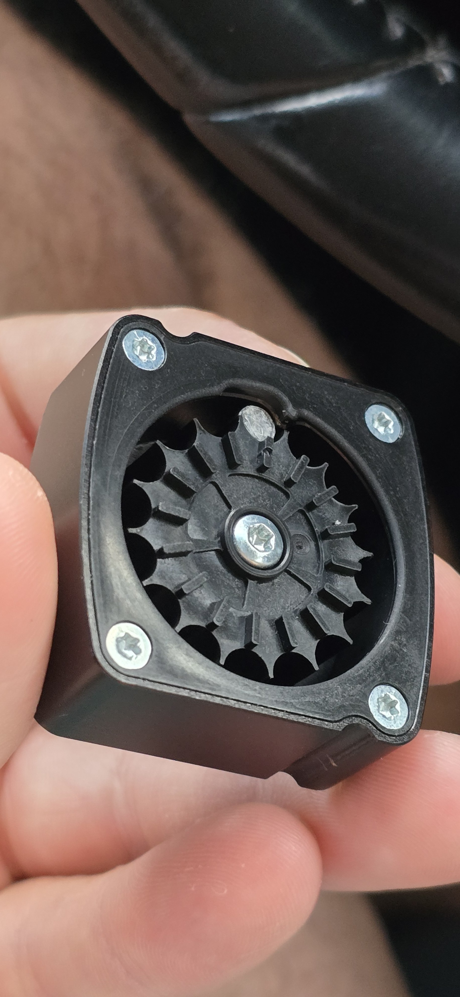

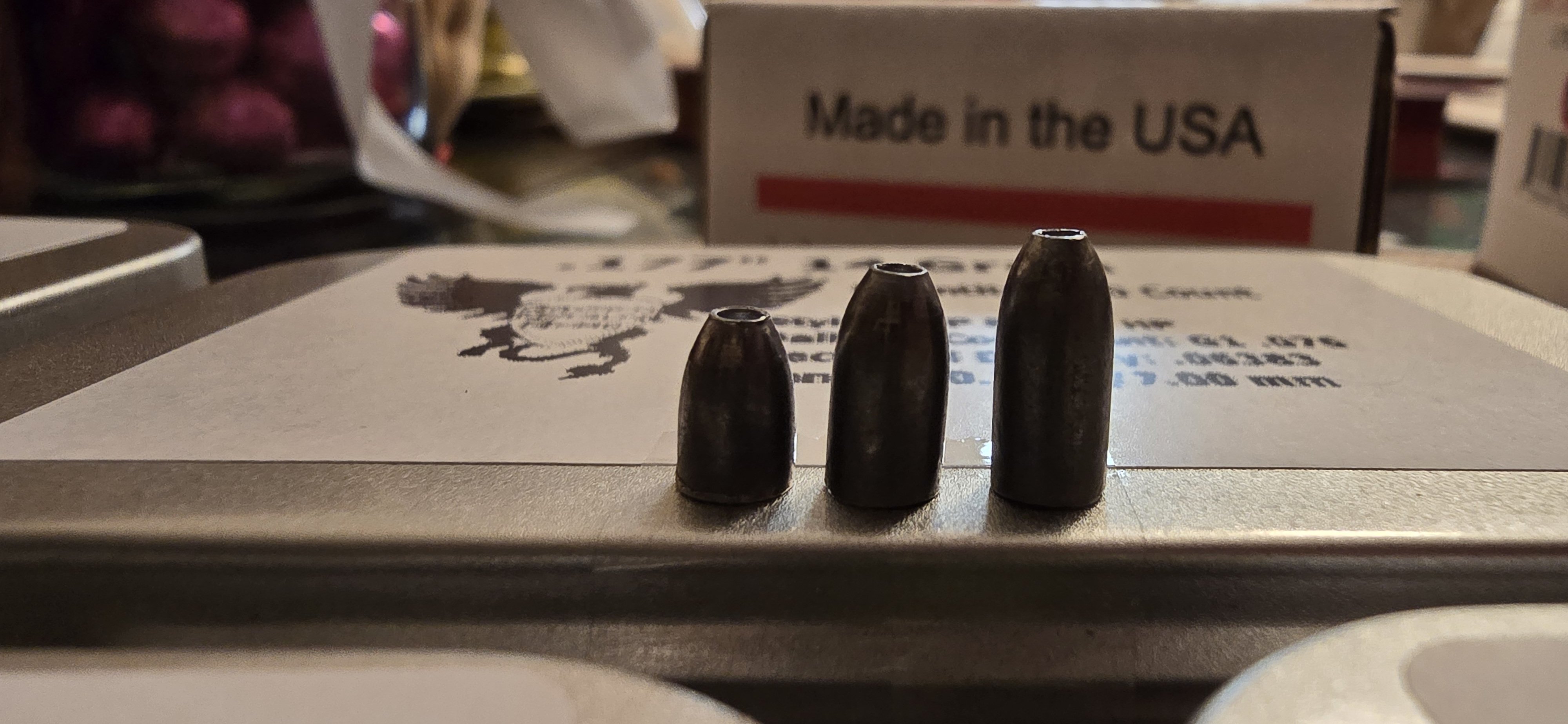

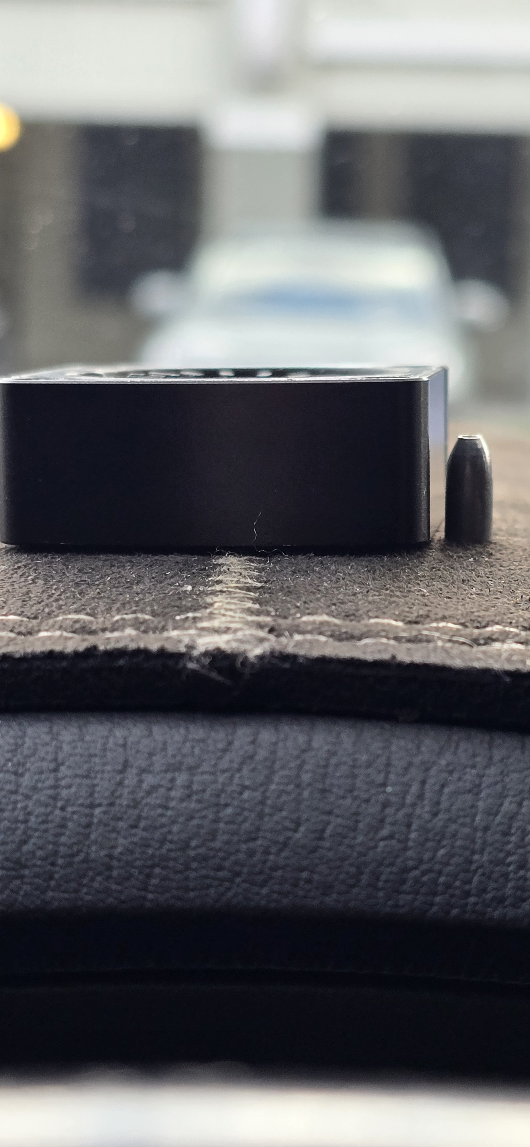

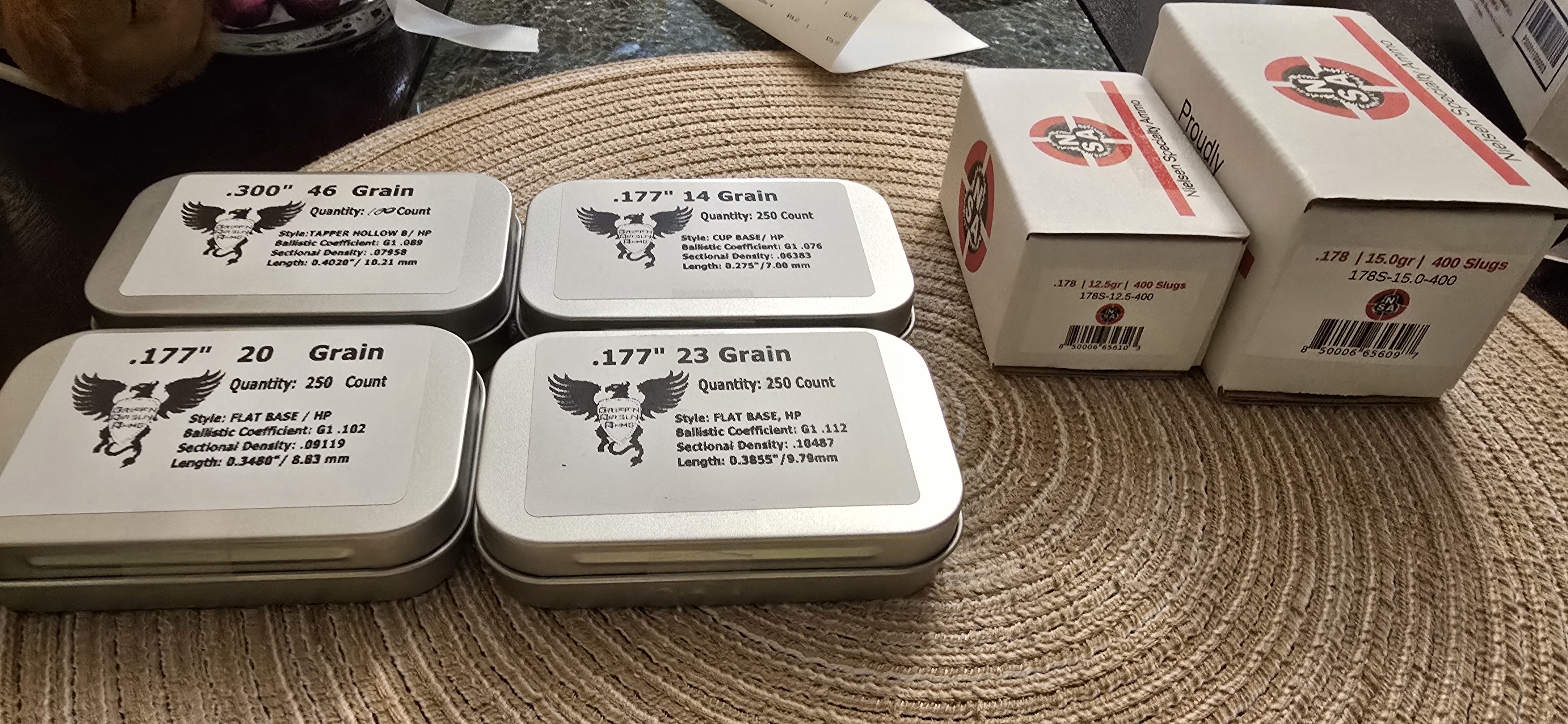

So my griffin and NSA order came in, the 23gr fit in the magazine with maybe .5mm of clearance but it fits and rotates without issue! Given the current tune they should be moving around 810fps, 20gr around 860fps, 14gr going 1030ish
