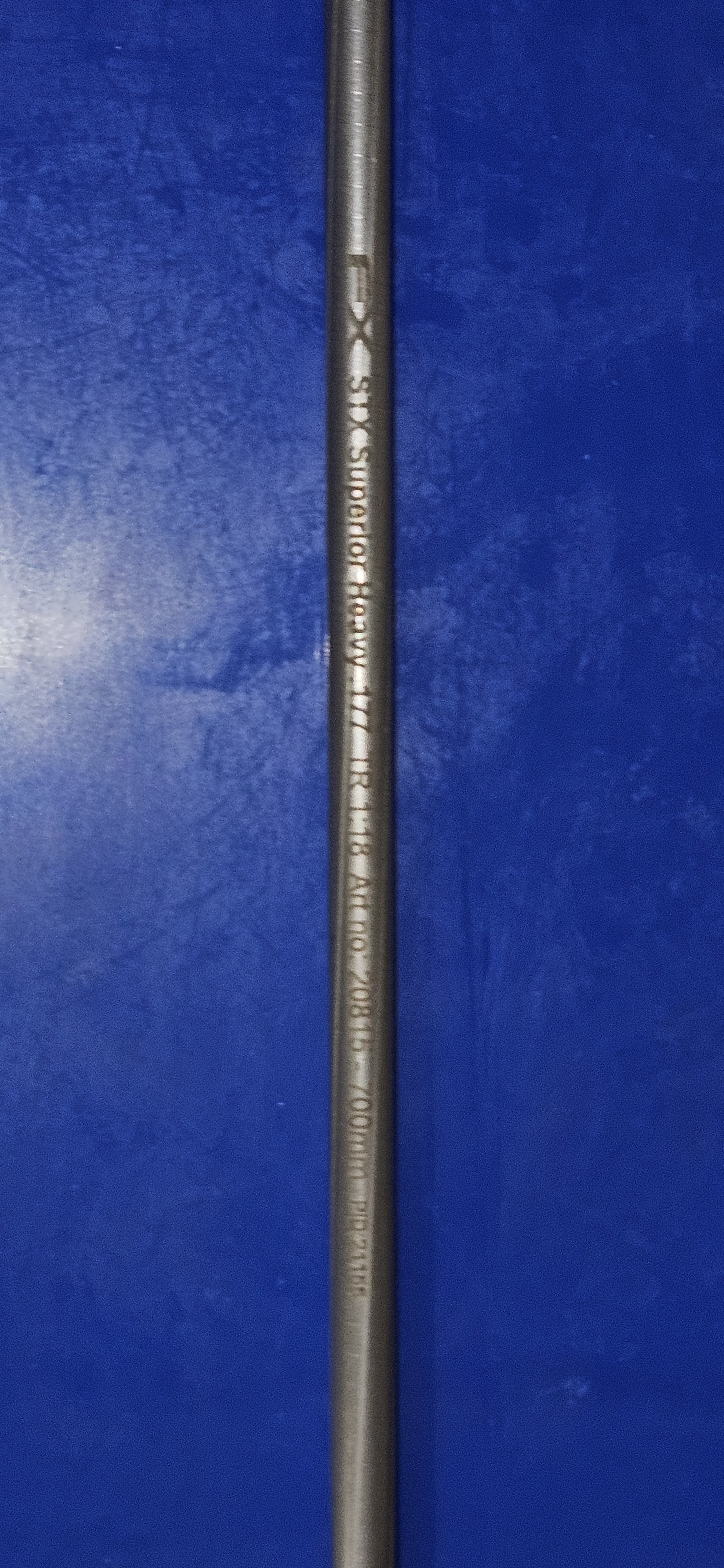

Utah. STX 177 700mm Heavy.. Got 2 of them. :)
I thought they were all 1:18? Just a slightly different 1:18

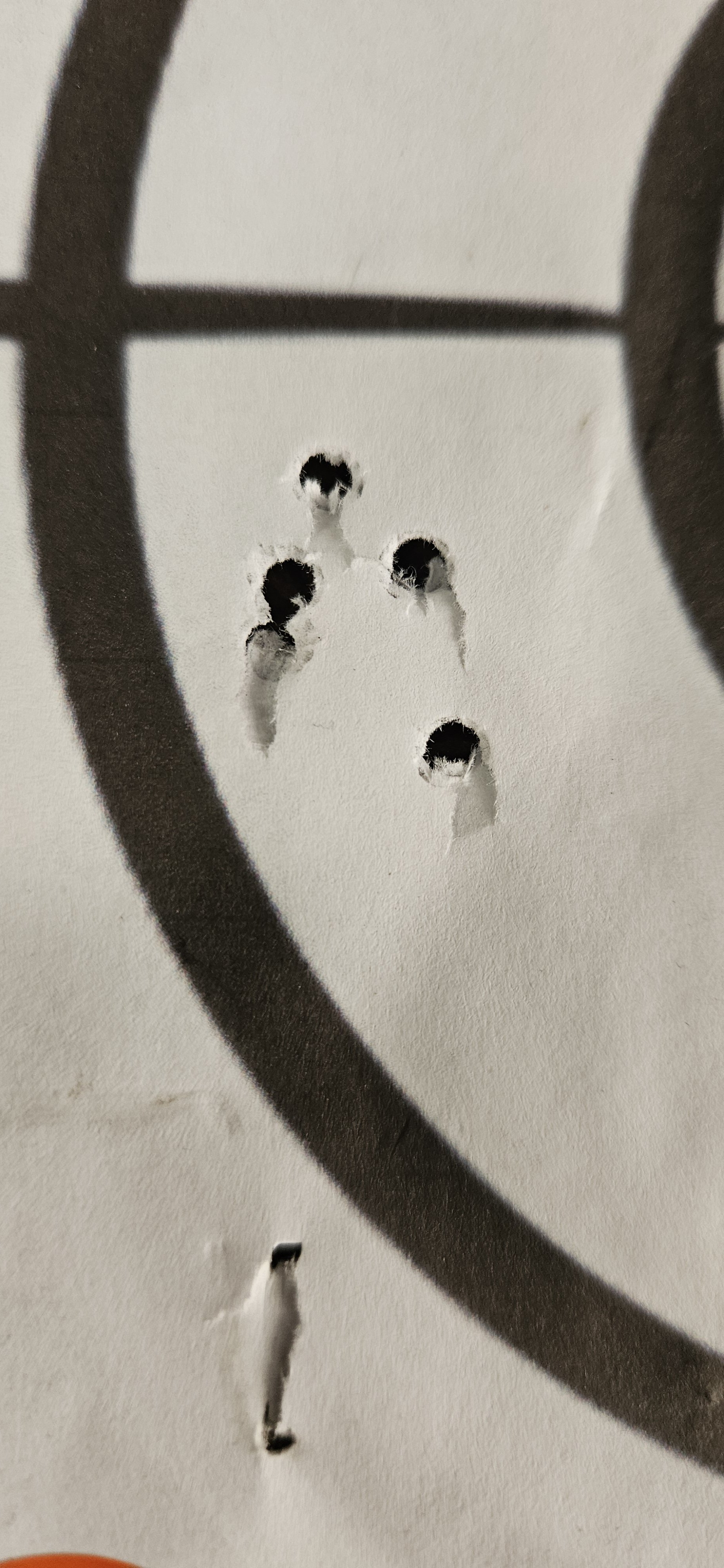

A 100 yard paper i shot today i soon noticed a LEFT bias and so was holding a little high and to the Right, but still some shots wanted to drift left, and also a little low.
Okay there is also a bias for my shots sort of landing where i was aiming or only drifting a very little.
Contemplating if this can be scope / eye alignment issues, i do after all go off the scope and back on for every shot i make using a single shot tray.
10-at-100-png.545107
Also some times shooting far, and with really low winds, i notice a drifting bias to one side, often one i can not blame on wind.
This is always sideways and hammering a paper i see the shots drift slowly to one side, not necessary shot after shot, of course also with a little up / down spice in the mix, so at some time i will have to add a click, and it is like a reset button, but only for a while then the process repeat.
Not for ever t hough at some time it will stop or start to move to the other side, which freak me CUZ often that would be up against the wind.
I swear i will never get this hobby, but fortunately i am not here for the science in it.

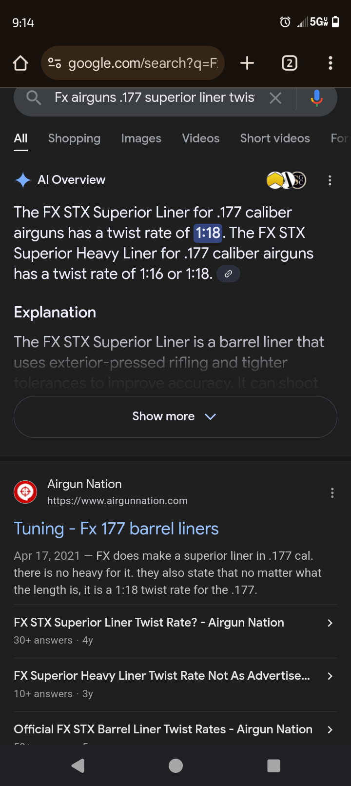

Where did you manage to find a 1:16 twist FX liner for .177?
I need to make a correction. The FX barrels are not 1 in 16 they are 1 in 18.. I asked Utah twice specifically are these 1 in 16 barrels and they affirmed. Well the 22 barrels are 1 in 16. Anyway according to Utah Air this was the best combination for slugs. We have one on an Avenger that shows a lot of promise in accuracy that is making 40 ft lbs with 15 gr NSA's. I did ask what twist the normal 177 barrels had and he said 1 in 24. So the 1 in 18 is a big improvement.
That doesn't sound right either @Sicumj
Fx stopped making 1:24 .177 barrels in 2021, or supposedly they did. And all STX superior barrels are supposed to be 1:18 twist. With the stx superior heavy being what I assume is unchoked, making the biggest difference. Either way, best of luck! Glad you got a power house of an airgun!
Reactions: RabbitofCaerbannog
Hes right .. I thought the exact same
FX superior .177 is 1:18 with a heavier choke,
FX superior heavy is 1:18 with more significant grooving and different choke specs
Utah add states 1 in 24 twist for the 22 in standard STX and 1 in 16 on the heavy. No listing at all for the 177. My 177 heavy has 1 in 18 lasered on the barrel. When i was firing NSA 20.5 SLUGS I notised they were keyholing. Disappointed in the twist rate. 15 is as big as I can get in my Akela magazines, which this barrel is goung in.
Yeah .22 has 1:24, and 1:16, but you said they told you .177 has 1:24, I'm just saying that's old news as of 2021.
Well that is what Thadius told me Saturday on the phone, from Utah Air. He is also the one that confirmed twice 3 weeks ago the heavy was 1 in 16. Supposedly Utah is the main distributor now for FX. You would think they would get their product info straight. The STX Heavy in 700 mm will not stabilize a 20 grain slug. When asked about this Thadius said the barrel is designed for 13 to 15 grain slugs. Not exactly what we were after when I initially purchased the barrels. Here is 20.5 NSA slugs at 50 yards.
