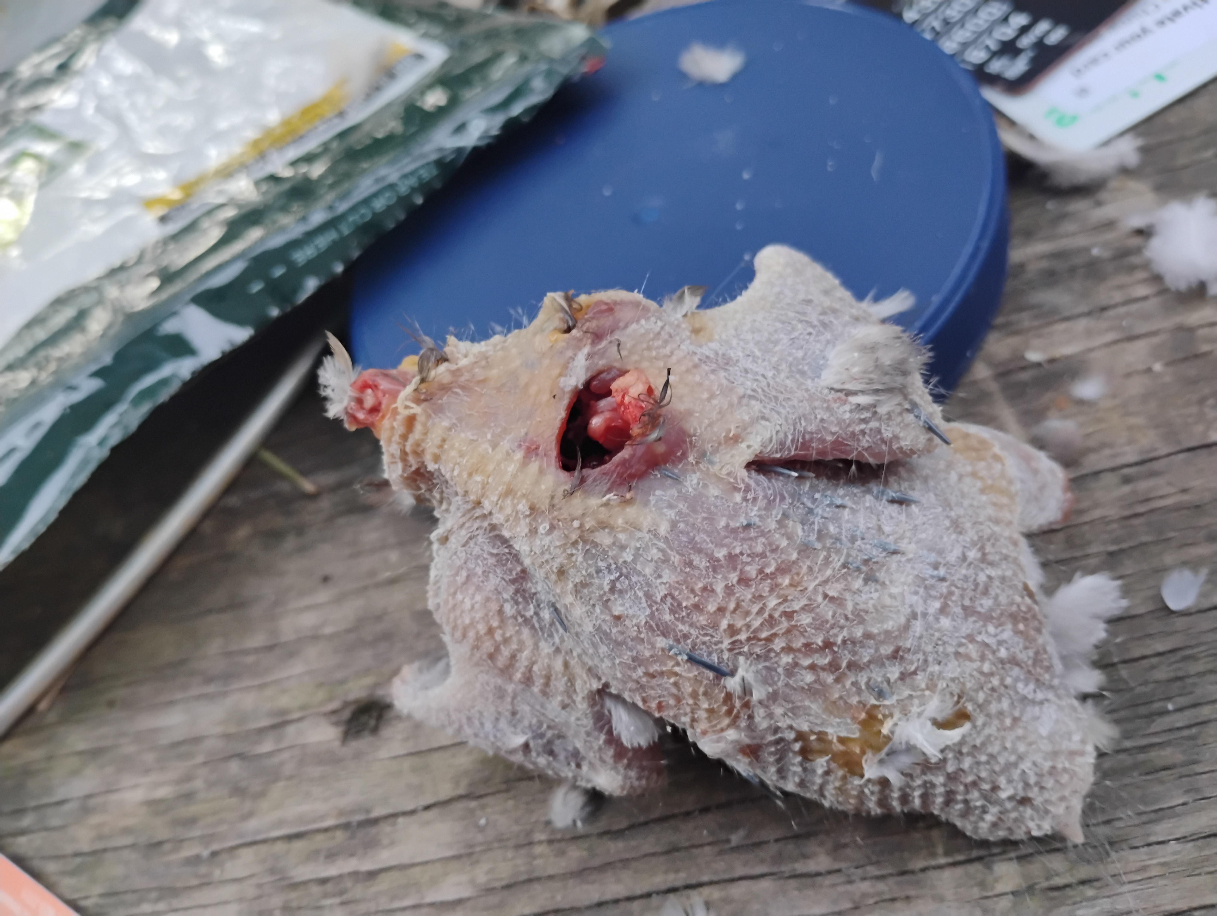

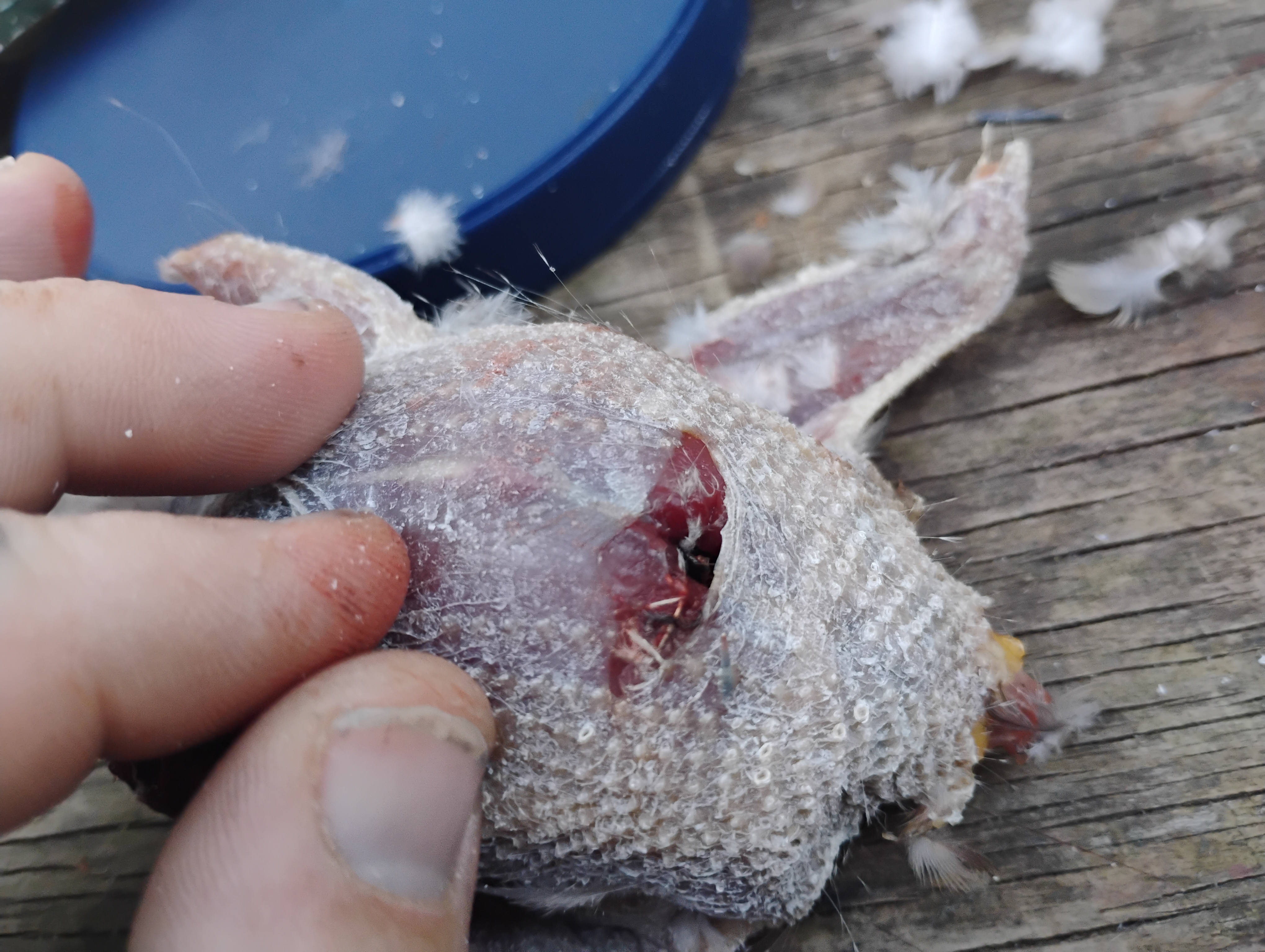

Im a big-time griffin fan. But in .177. I gotta give it to Varmint knockers. I got some metal on meat last night. The VK 13.5s at 860-870 were nuts. Even with birds... Pass through weren't guaranteed.
In....
OUT...
Nuff said. Eurasian dove.
The chest cavity was basically hollowed out.

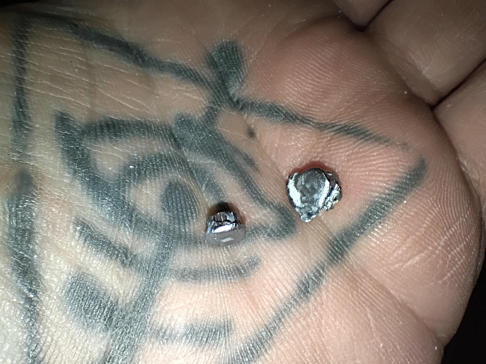

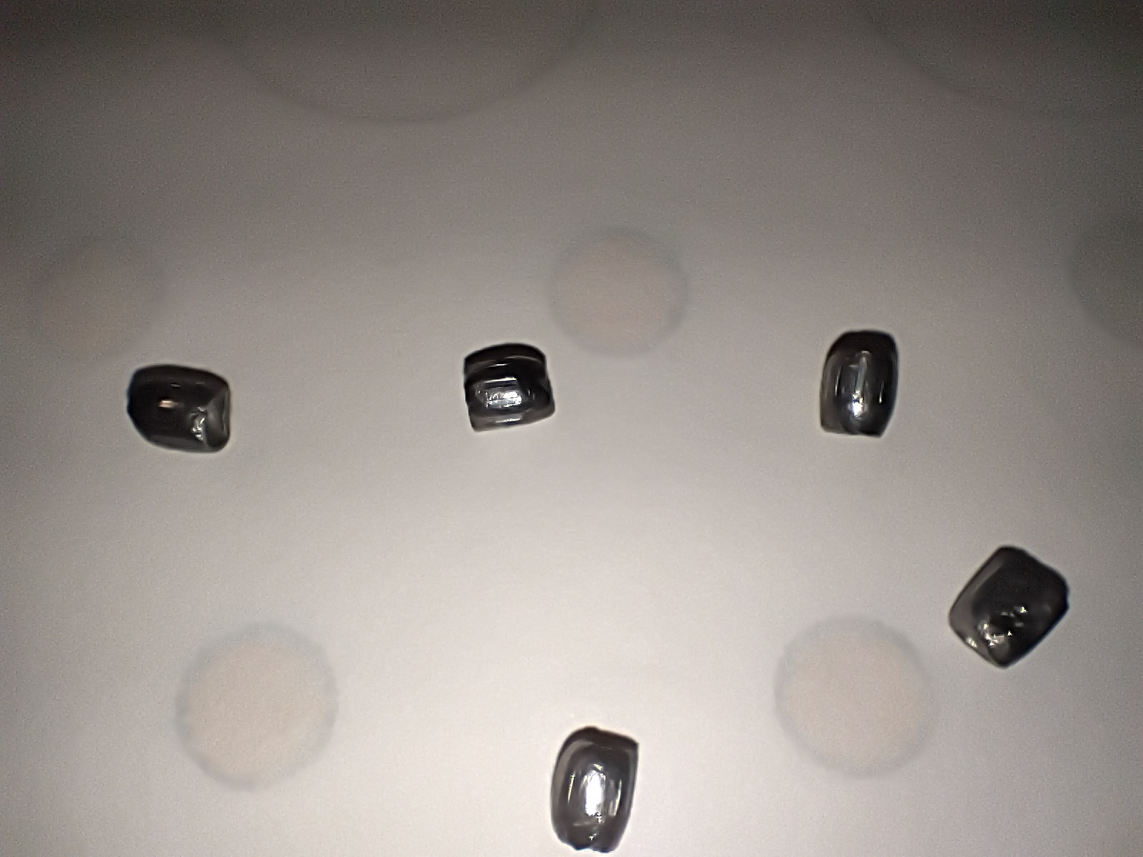

These slugs explode on contact just inside of the animal. Only the base plug of the slug exits. The rest fragments. Completely here's the left overs if slugs shot through my sparrow analogue ballistic medium. An 85/15 or 90/10 mixture of beeswax and lard or tallow mixed together melted, and poured into a hole at the top of a plastic easter egg. Once solid wrapped in a thin layer of leather from an old couches upholstering.
