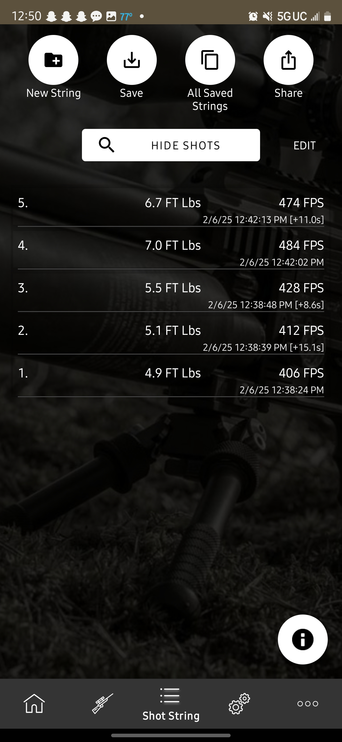

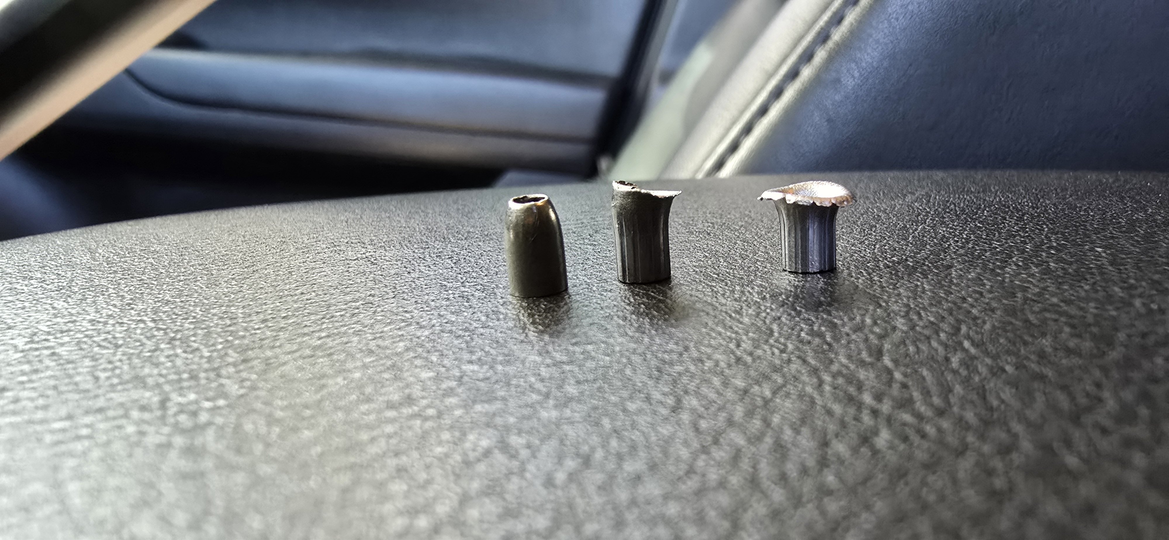

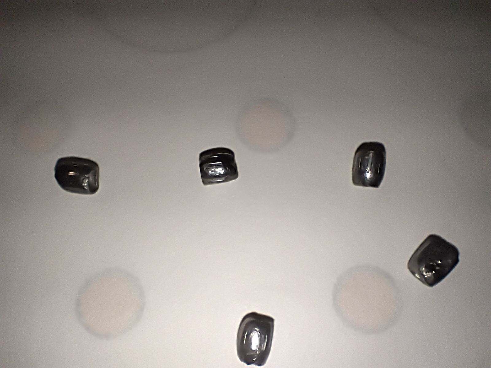

Unfired, 5fpe, and 6.7-7 from from my Akela shooting .1771 13.5gr varmint knockers into 3 foam cups stacked with water inside each. The 7fpe stopped at the last cup and did not damage the bottom of the cup. While the 5fpe was sticking out the bottom of the last cup on the corner.
But that 2fpe makes a huge difference even at low velocity.

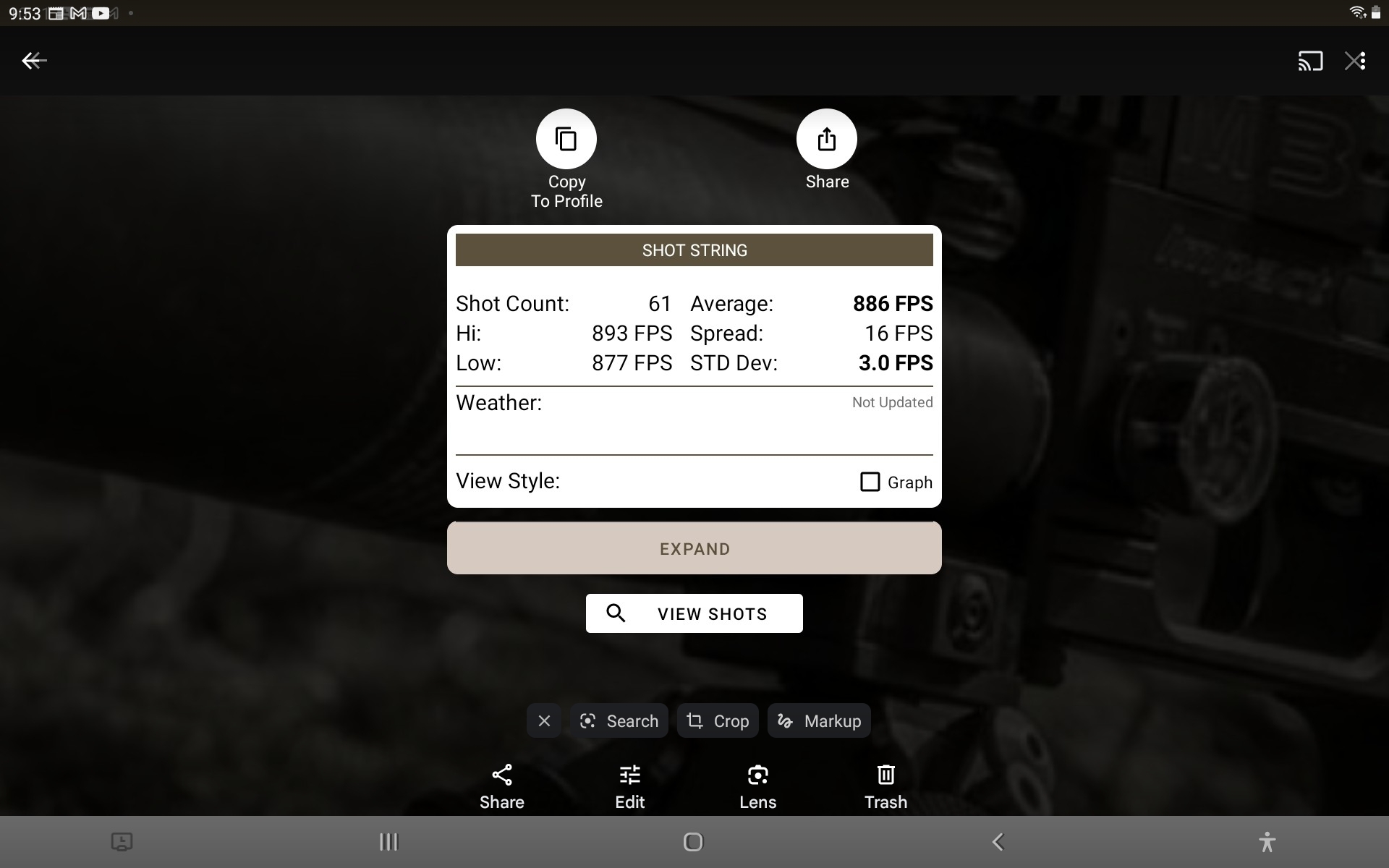

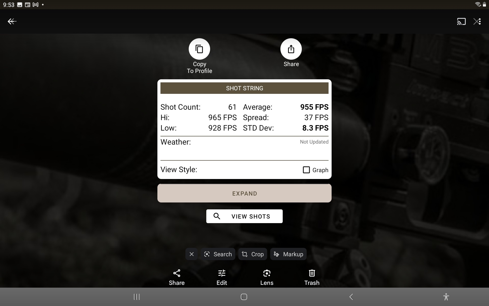

From the way my patchworm has less resistance compared to the hw30 it probably does have a larger bore . It has low SDs with pellets but haven't run a long shot string with slugs . Maybe I'll run a string to check the slugs SDs and ES if I get some free time . It is around 33° outside now and that could slow things down a bit .
Here's a couple 61 shot strings with pellets. The one at 955 is with CPHPs and the other with jsb 10.3s .
