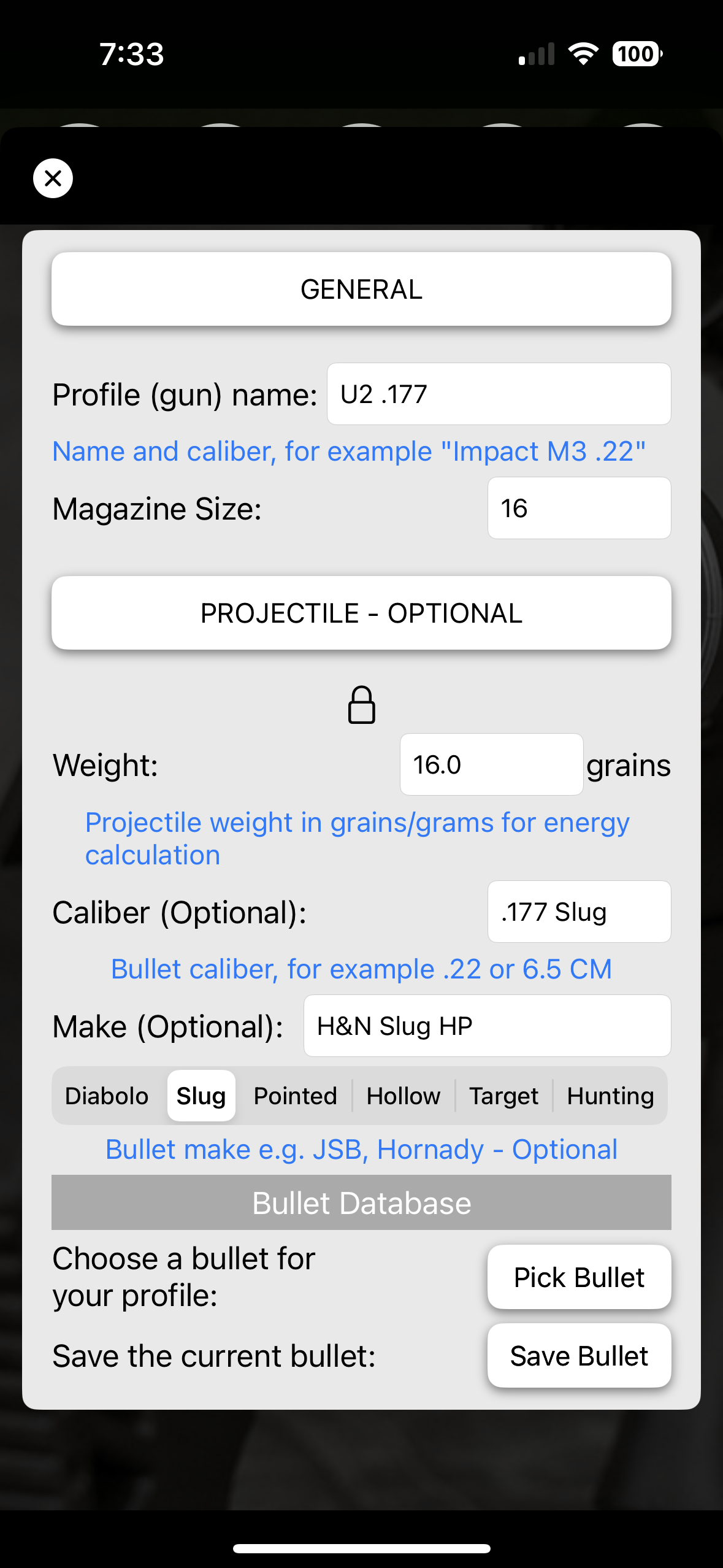

Separately, do you guys lube your .177 slugs?! I always lube and did so with these baby slugs a a well but shot a few out of the tin just to compare and based on the very limited sample it seems like they don’t like to be lubed?!

I make sure to lube my slugs in .22 and clean the barrel with wet patches or use the ballistol snake to leave a small film of lube on the barrel.
Did you clean the barrel to begin with?
It may just not like lubed slugs, are your slugs soaked with lube? Or do they just have a tiny layer? The only .177 slugs I've ever lubed are NSA and Zans because they dry out quick. But not the JSB KO, Griffins, or VK.

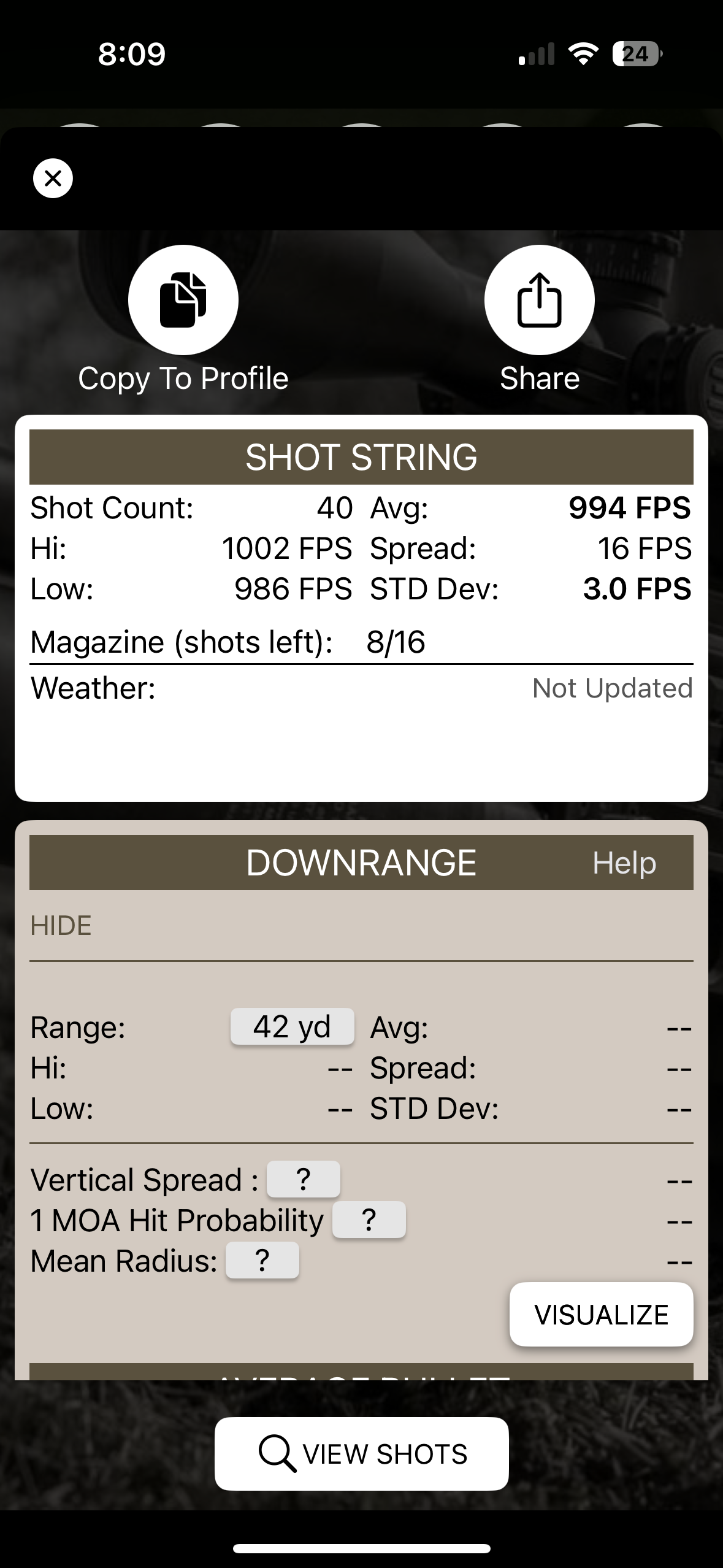

Also you'll eratic fps spreads. Like of you have decent accuracy but your spreads are over 15fps. Something like 905, 920, 912, 928, 907, 920, 899.
You definitely need to fine tune your valve. I wouldn't do any crazy turns.
My .22 was doing what I metioned above but from 990-1016 I did maybe about 1/5 of a turn out and it tightened my speed considerably and accuracy was retained.

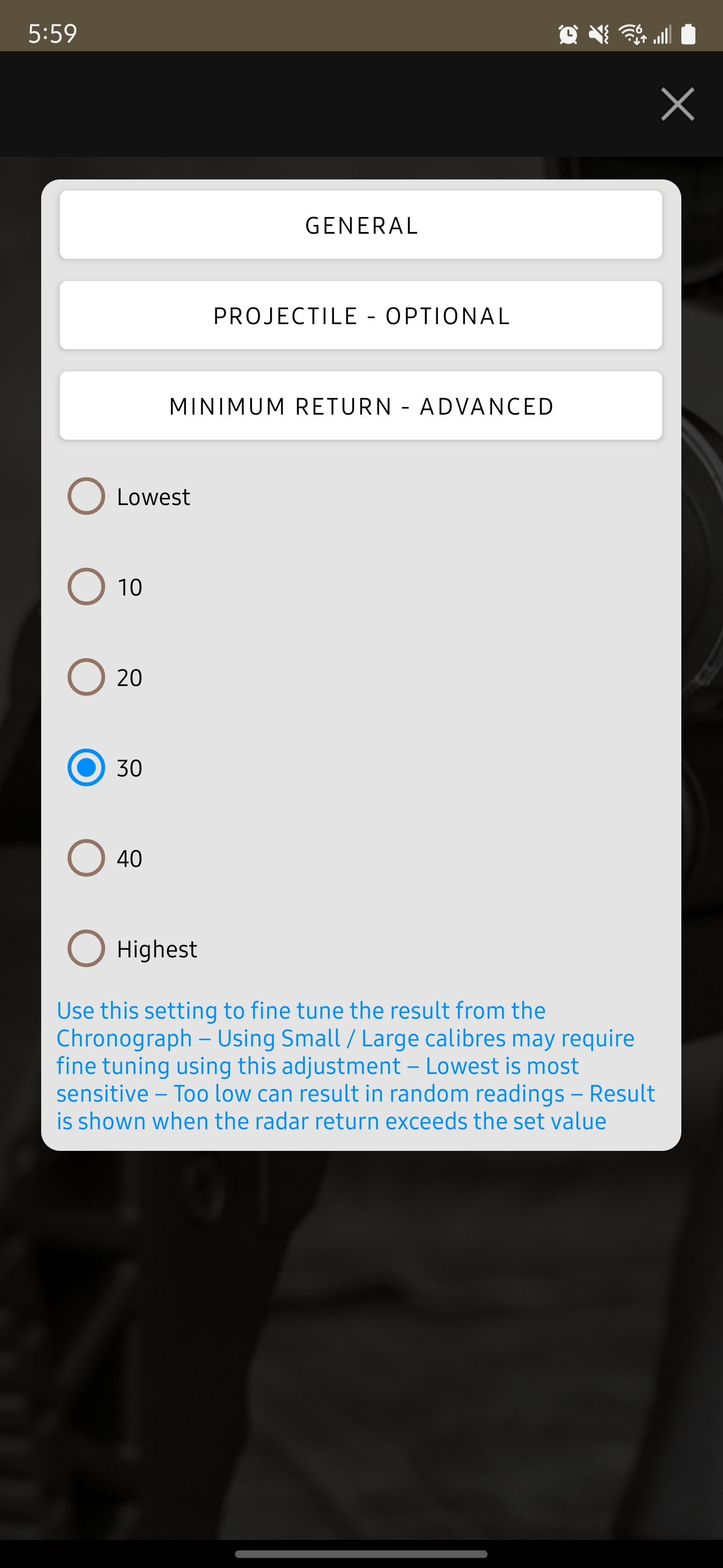

Spread doesn’t look bad for out of the box but the pocket chrony (v2) is missing a ton of shots, not sure what to do about that…

You'll have to adjust the chrony sensitivity for .177, chronys have a harder time clocking them. But that's not terrible, it can definitely be cleaned up though. This was with 10gr right?

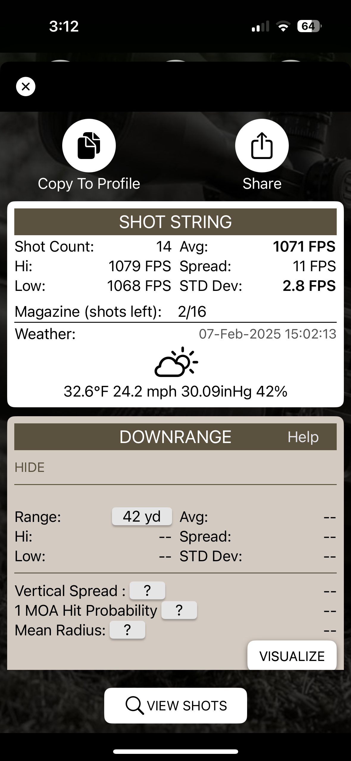

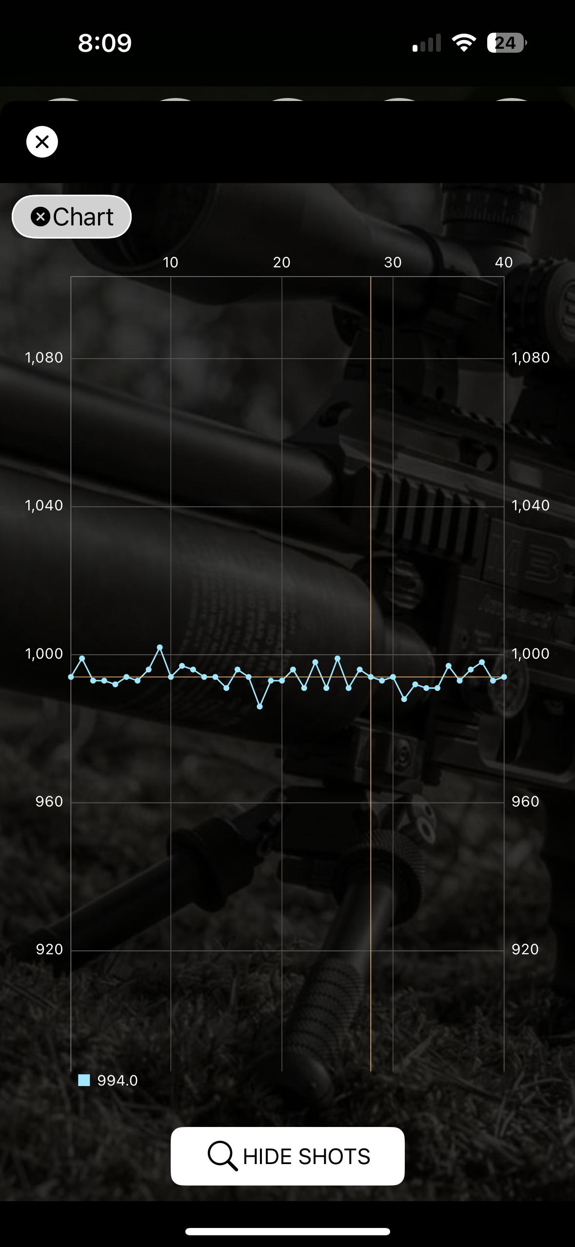

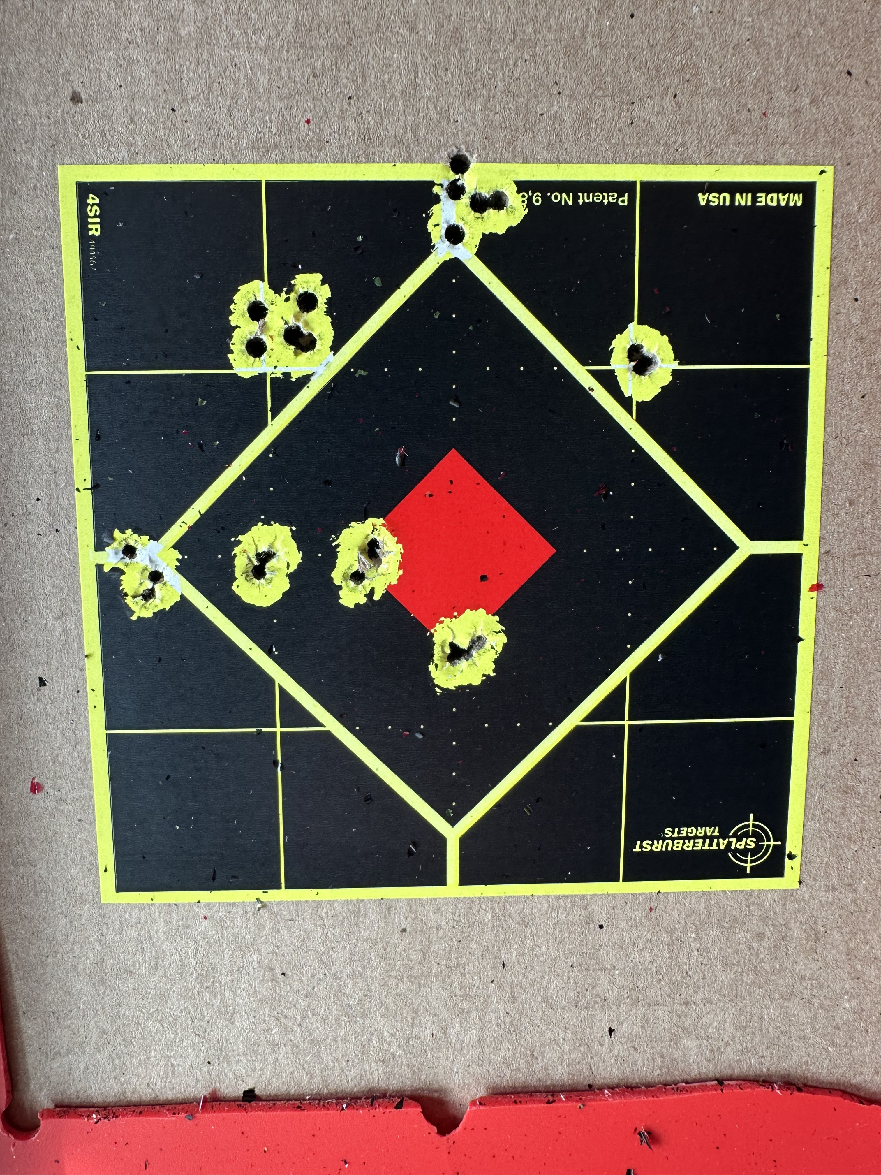

Pulled the reg to adjust, cam set to 90b. Gave it only 1/8 turn cause I didn’t want to make the 10gr supersonic given that I got 8 tins :) anyway, I think I got lucky, 10gr now at 1070 and the 16gr at 925 :) spread looks good as well. Couple of 5 shot groups in the pic, upper 3 are the 10gr but ignore the two to the left, cleaned barrel after those since I probably shot 3-400 since last cleaning. The lower ones are with 16gr. Only at 15y though (17mph wind with 32mph gusts right now, so I’m not even going to bother outside…)…
Wow! Good to know that only 90b shoots the 10gr at that speed. With an 1/8th of a turn you should be around 100-105b. Are those the 16gr VK? Or something else? And if so what size did you order from him.
