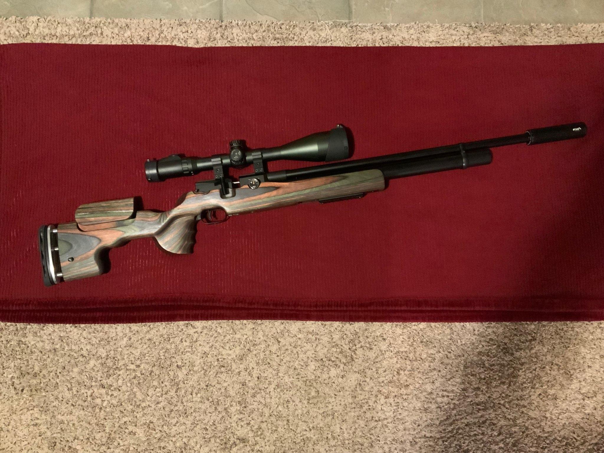

I bought a Dreamline Classic .22 from a forum member here. Then bought a .177 barrel kit (500mm).
I had a Maverick and got rid of it. My opinion is that if your just shooting pellets, the Dreamline (and perhaps Crown/Royale) is the best from FX - a straightforward simple rifle.

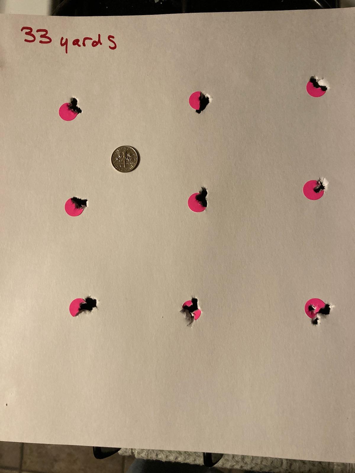

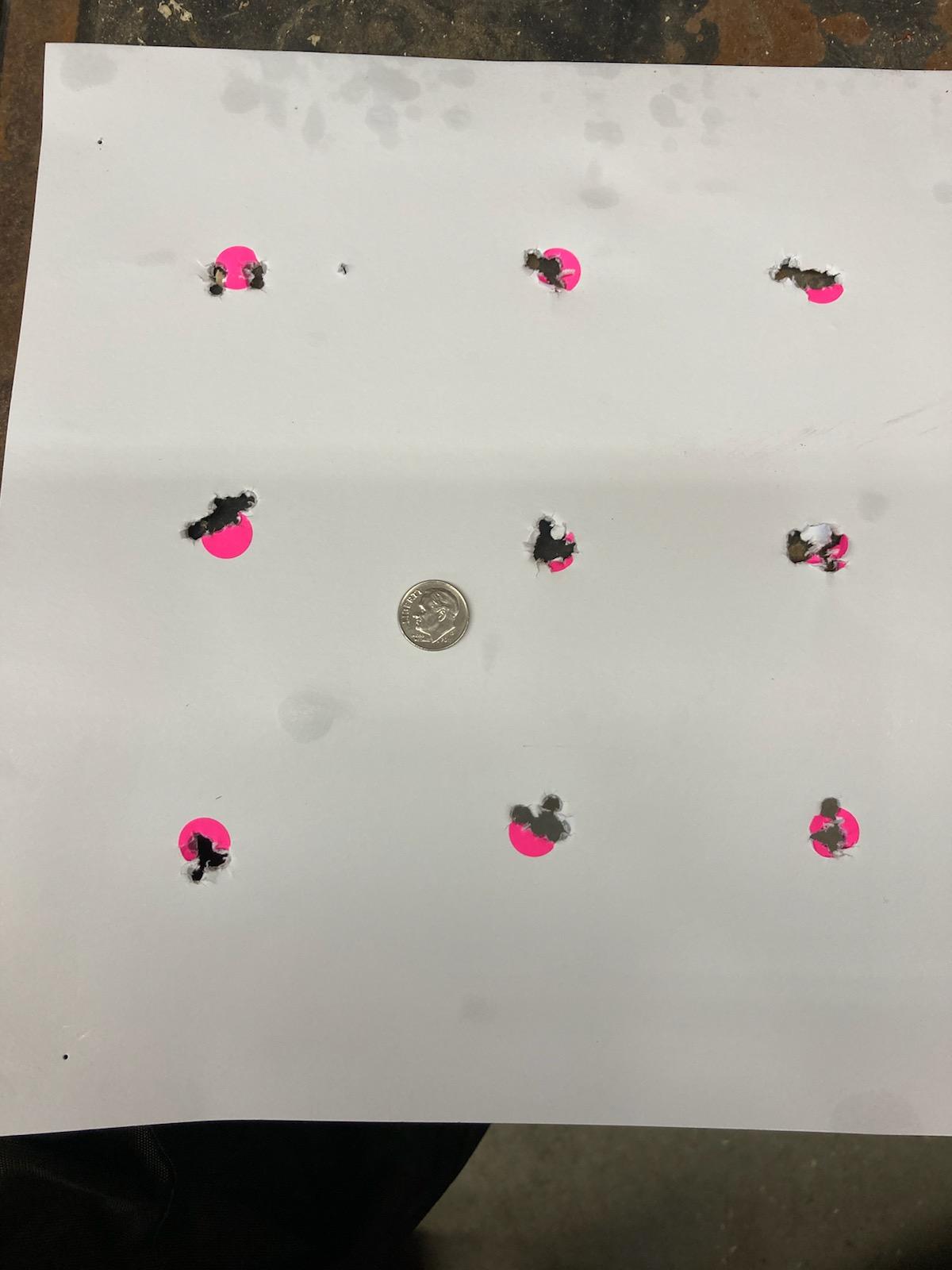

I handicap my Dreamline with the worst scope I have - and it still keeps shooting over 190 most every time in the 30 yard challenge. Its doing this with the “standard” 10.3g JSB/FX pellet - no need for 13 or 16 grain. Speed is 875fps.
Heck, look at the 40 yard (green laser measured to 120.57 feet) 10-shot group with $5.50 Hatsan Vortex Strike 9.25g pellets- using same “tune” as the 10.3g.
My reg setting is in the picture- probably 95 bar.
I’ve done nothing except clean the .177 barrel when I received it new and polished it up a bit with Flitz. I use a Weihrauch moderator (30mm tube haircurlers and washers design) and its super quiet shooting 875fps. I did try to improve the trigger by polishing it.
I’m astounded that the thing shoots so well in .177 and .22. The “barrels” are like from a toy and the triggers in FX - with the spring under the little ball - are sorely lacking compared to other trigger designs… but if anyone asks me about FX .177 , I’d say they shoot good, damn good.

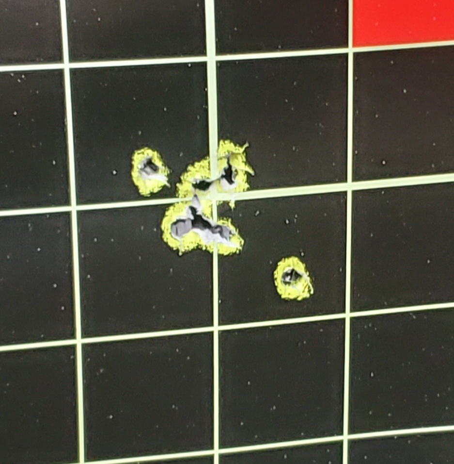

Had mine a couple weeks - cleaned it upon arrival - got it sighted in - wasn't grouping that great - cleaned after about 100 shots.
Shot another 150 - groups were opening up - cleaned again. Was very filthy every time - just considered it as being new.
By this time it's had almost a full tin shot threw it and cleaned at least 4 times.
Went to the Cajun Grand Prix - took a few sighter shots maybe 20 - then 60 shot course - score was horrible - couldn't figure out why was shooting so bad - decided to clean the barrel after the match - had a very difficult time getting the first patch threw was so bad I thought it was going to get stuck.
At this point it had at the most 120 shots threw it. For the next match I only took about 10 sighters and then shot the match - double my score from the day before but accuracy was falling off toward the end. So now we are only talking about 75 shots at the most - below picture of the first patch.
Contacted FX support and they pretty much just blew me off - their advice - shoot a wet and then a dry cleaning patch threw it after ever mag. Really so during a match I need to say hold up - got to clean my barrel. What a joke.
So guess I'm on my own on this - going to lap the barrel - if that don't fix it then I'll make a fence post out of it.

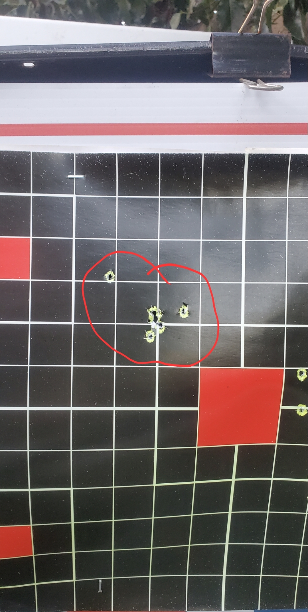

I’ve been on a 177 kick lately. In spite of hearing the same negative review, I got the latest 500mm barrel kit for my FX Wildcat BT. I’ve been shooting the standard 10.3 JSB pellets and they work great. However, the Hades are a bust but I’ve heard that they don’t do well in 177 cal in many guns. I’ve also tried a few slugs and the Zan 13grains are head and shoulders above everything else. Shooting out to 100y at 990fps, they group just as well as the best 22 slugs from my M3. The only challenge was finding a pin probe and slug port for the barrel. I couldn’t find them anywhere in the US and had to get them from Huma.
There’s a YouTuber from Denmark (Viking Airgunner) who has put tremendous effort into getting the best out of 177 slugs from the Wildcat and Impact and he also found the Zans to be the best. Another important consideration here is that he finds that shooting slugs over 13 grains requires a 177 slug liner. They’re only made for 600 and 700mm barrels and again, only seem to be available in Europe.
