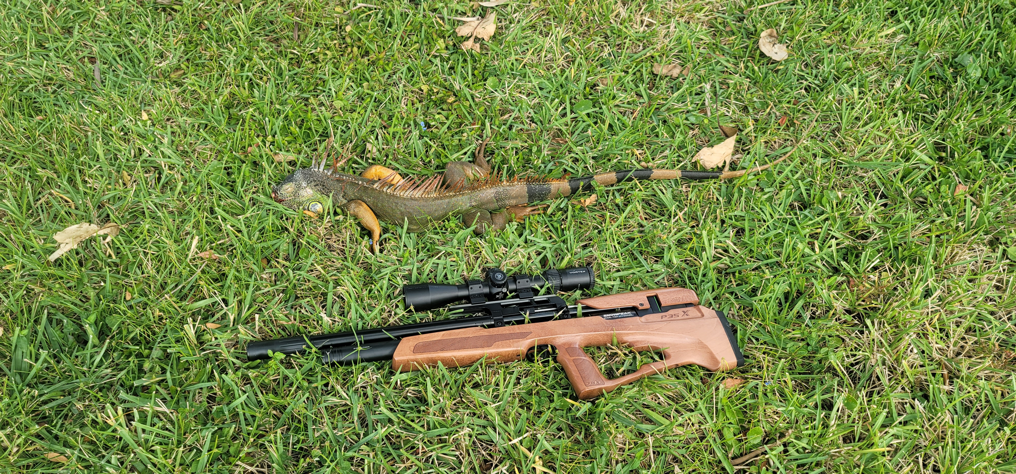

If budget is an issue find a used daystate Huntsman. A Weihrauch HW100 with the long barrel is also a go choice. The denominator for these two brands are they are well made, accurate and you don`t read much about them on AN unless its good gradings. Good choice on caliber. The .177cal is a stinger and with the right pellets/slugs has proved to be a killer on larger game like racoons, small pigs, iguanas and whatever that presents itself. If you can find EUN JIN(Seneca) pellets like the 16, 17 and 19grain pellets and push them into +30 ft/ibs you have a smasher. However the HW100 will do about 23 ft/ibs only. Here I believe the Snowpeak P35 is tunable to reach very high energy levels for a moderate price. Good luck.
