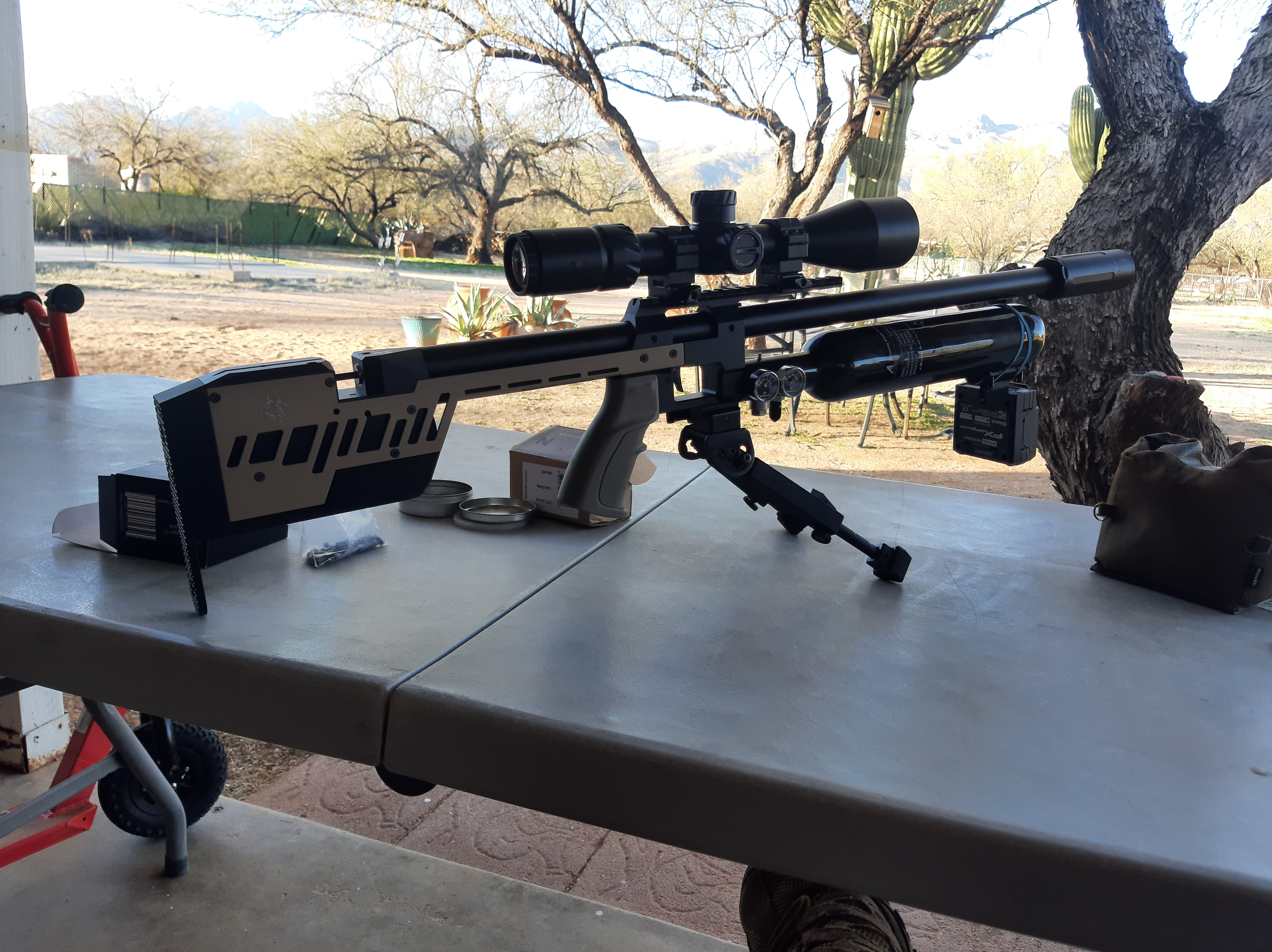

Just received my 177 Prophet 2 today from Talon Tunes. Thx Tony! Came with the reg set at 150 bar. At that setting will push a 13gr JSB to only 850fps and a 10gr to 915fps. I increased the reg to 170bar and only 885ish with a 13gr ZAN. Seems not alot of speed with such a high reg pressure. Is this normal? I purchased this rifle to shoot 177 slugs as the new valve was supposed to put out big power with lower reg pressures. The Priest 2 I had would easily push a 13gr slug into the mid 900's with a lower reg pressure. Not sure if there's a problem with the gun or this is normal??? Any info would help.
Thx!

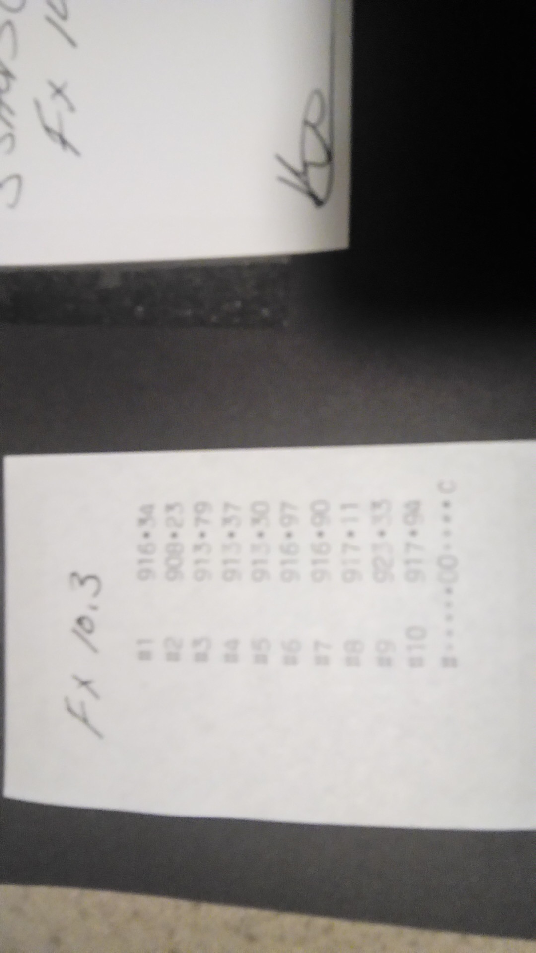

I do own two Prophet Performance V1s. I’m currently shooting the 510mm LW .177 barrel in one of them. With the reg at only 80-85 bar, I could not get velocity of JSB 10.3g BELOW 915 fps! So, I cut the hammer spring from 2.6” down to 2.4” - now I can get velocities from the low 800’s on up to 900+ with the reg set at 90 bar.
With that info, it would seem your Prophet 2 should be making more power at the huge reg settings you are using. Perhaps too much reg pressure? Try lowering your reg to 110-120 bar to see if it INCREASES power…?

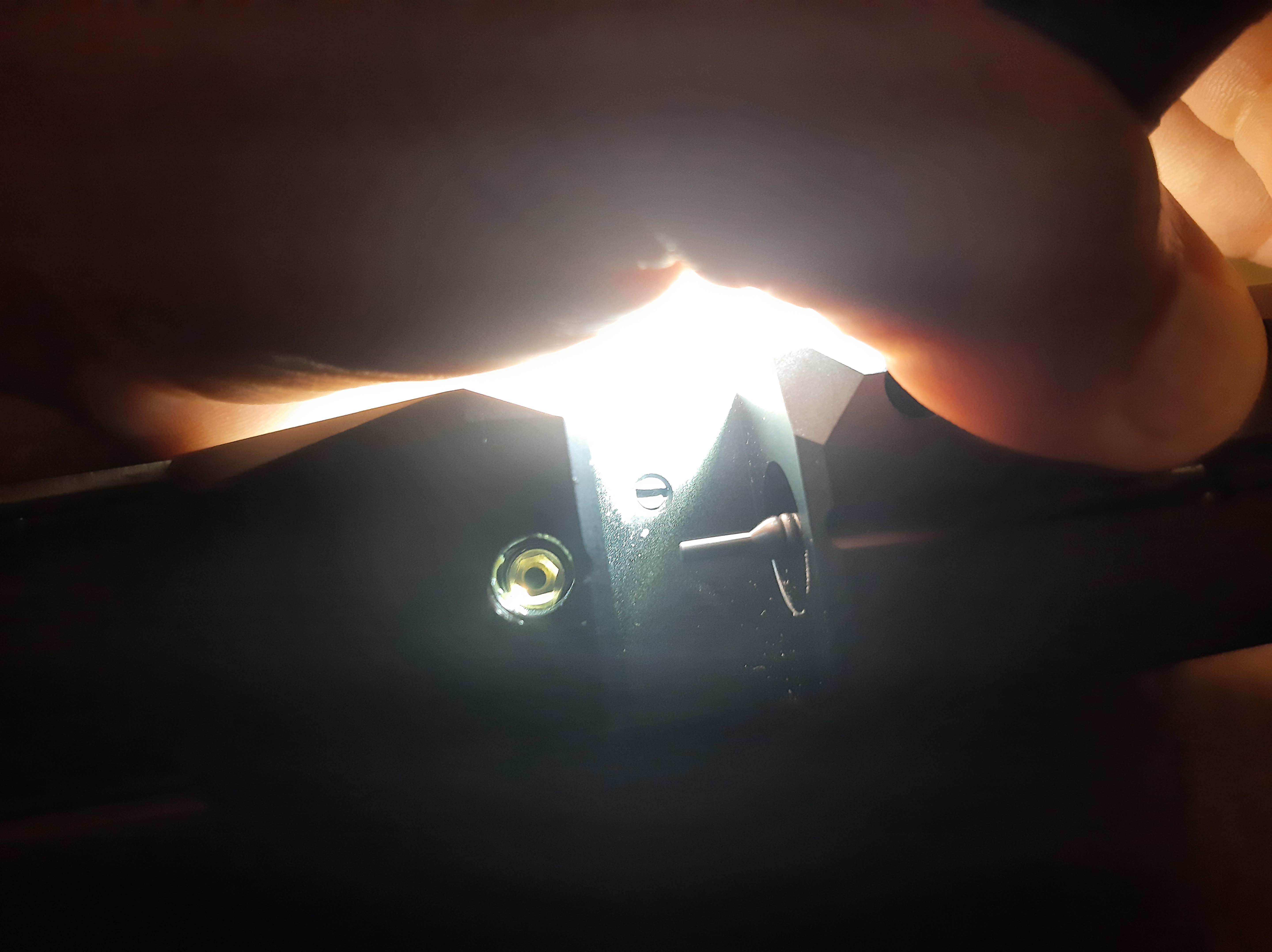

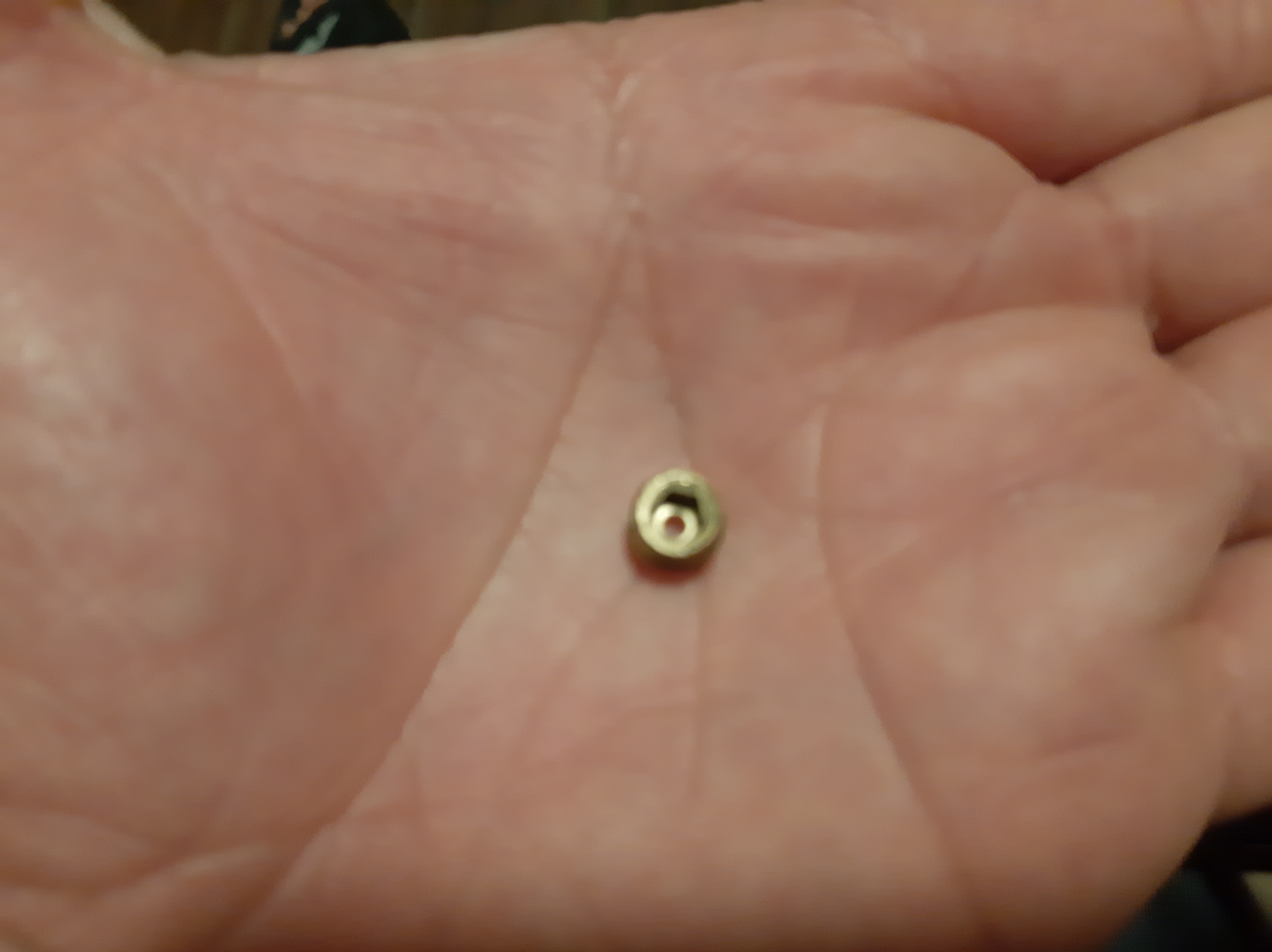

See what size TO grub screw yiu have in it.
