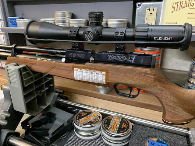

I purchased this rifle from AOA in March of 2021. It is the full length version, and obviously features the sporter stock configuration.
This would be an excellent "heirloom" rifle for someone new that is thinking about purchasing a quality pcp. Built in typical german fashion, there is absolutely not much for one not to like. The magazine system is flawless, simple, durable, and as easy to load as any on the market. It is absolutely the most quiet rifle in my collection. The adjustable trigger is perfect
One small issue is that the magazine slot is so narrow, that a Patch Worm won't fit in it and make the turn. I resorted to cleaning the barrel utilizing a half mag of felt cleaning pellets.

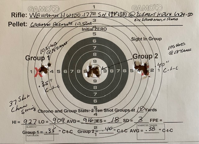

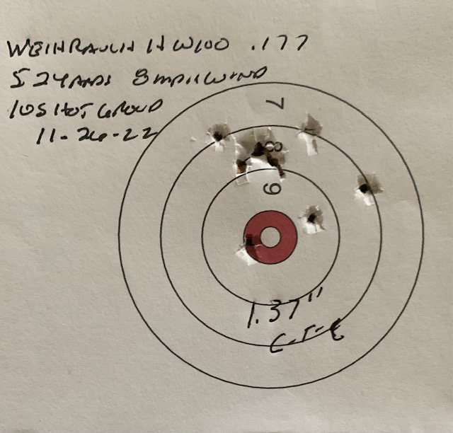

A couple of the stock screws moved slightly when checked. The scope screws were all at the proper tension when checked, so I moved to the indoor test range, following up outside at 52 yards with a group just to be certain the results were within a reasonable anticipated outcome, given the reported 8 mph crosswind conditions.

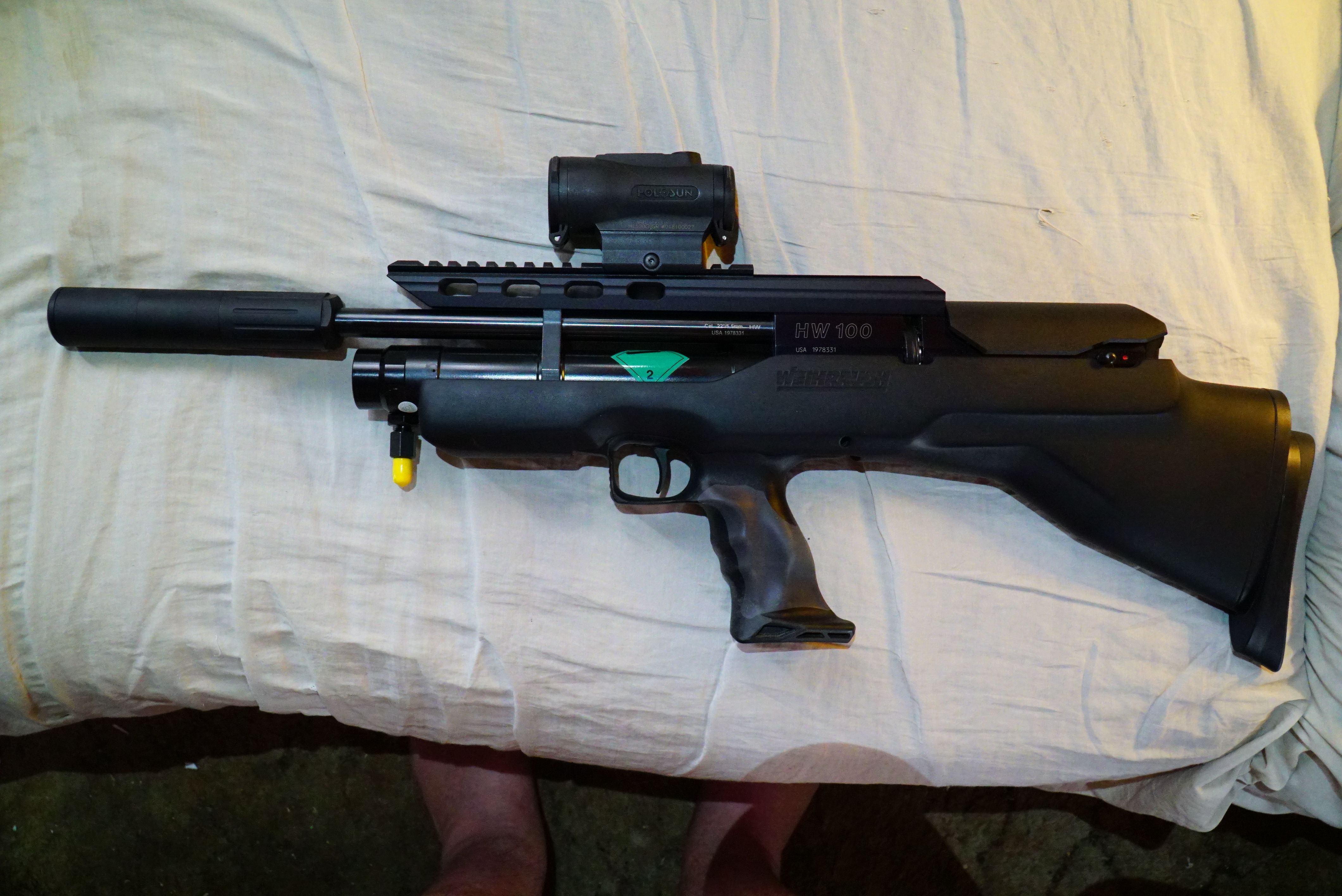

I've got the "bullpup" version.
Same receiver, shorter barrel, and stock.
Agreed, the design and machining is second to none. Solid, and all parts fit VERY well together.

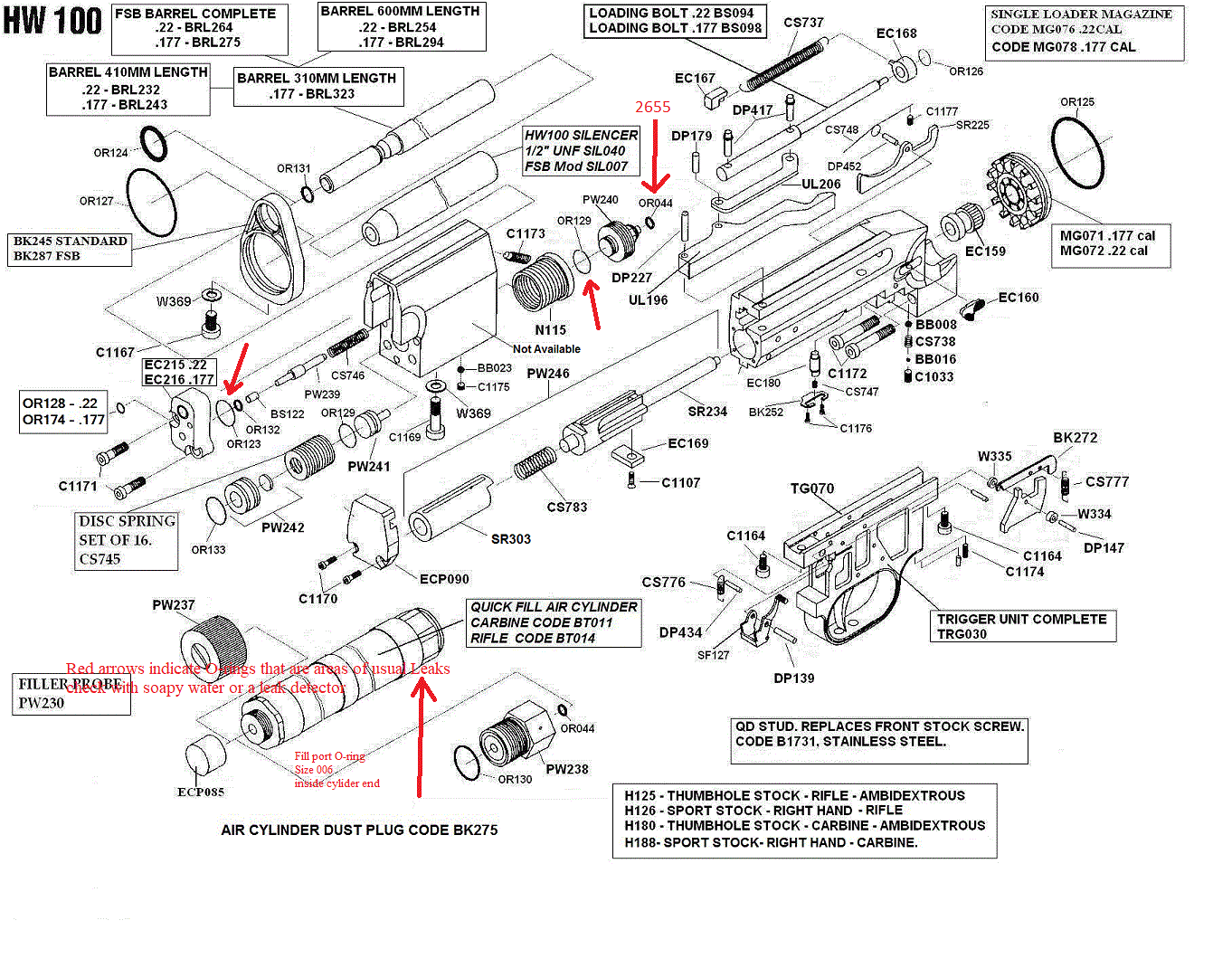

BUT, mine developed a major leak somewhere. I replaced the o-rings at the valve between the air cylinder and the receiver, no change. Unfortunately, the kit I bought did not have the air cylinder o-rings, so I have to get those.

Mike, I found that on the HW100 there are several areas that can develop leaks, here's a diagram of the areas, you can get O-ring kits on Ebay from
HW100tuning.com or from https://hw100tuning.co.uk/shop/ols/products/full-service-seal-kit
also D & L air guns ..https://dlairgun.com/collections/hw100/products/hw100-seal-kit

Yeah, the # CR129 and the #CR044 are the ones that I replaced the other day with no luck. I did these first as they are the "second" to see uncocked pressure. No change in leakage at all.
I still need to get a full kit, or at least the air cylinder o-rings to do the three in there next.
Thanks again for the schematic and the recommended rings to change...and another place to get them.
